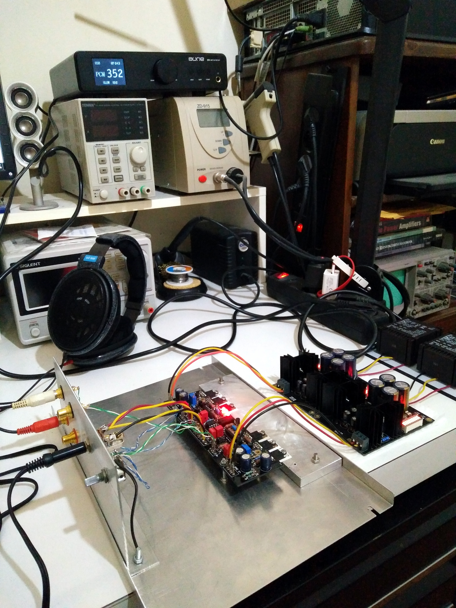

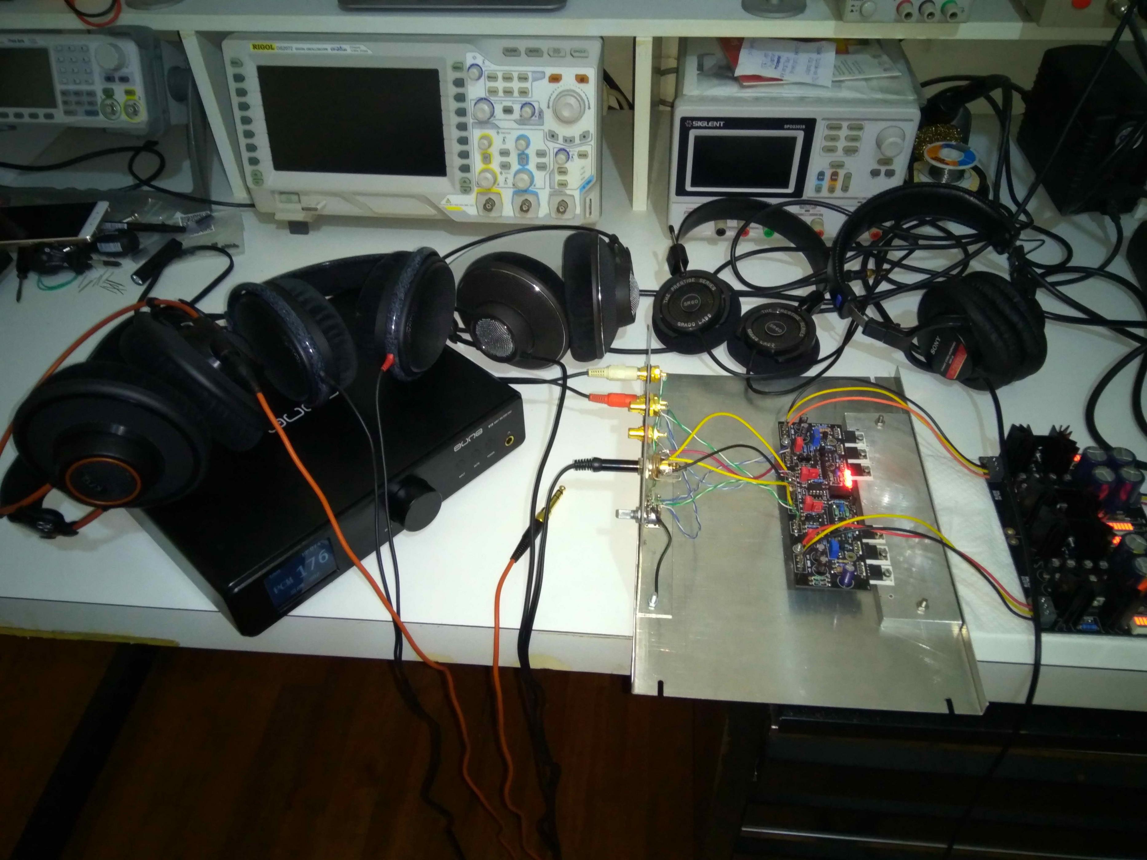

As teabag said, when over to salas two days ago and we had a headphone testing with his new headphone - line amp.
Dacs we used were his old and trusty 0404 EMU and his new Aune s16.
Headphones were my Sony MDRV-6 and AKG712 pro and salas AKG612, Grado SR60 and Sennheiser HD600.
We started with the EMU to get used to the sound of the headphones and continued with the Aune, which proved to be more revealing and better dac overall. I think that the EMU showed his age.
I also listened to the 712 and the HD600 direct from the Aune, as it has a dedicated headphone output. I preferred the Sennheiser, but it was obvious that the Aune could not properly drive the AKGs.
With the DCG3 now, there was a different game! It should be mentioned that it had no problem to drive any of these cans properly and at high level.
All of them sounded better through the DCG3. Everything was much more transparent and more musical.
The Sony and the Grado sounded very nice but the Sony were a little bit hot on the treble. Decent resolution for old designs.
The 612 and the HD600 were very similar in character, very neutral but I think that the 712 got the edge with a bit more musicality.
The DCG3 was powered by salas cap multiplier and used generic cables and components and nothing seems missing.It is really good! Only wonder could happen with dual BIBs and premium components.......

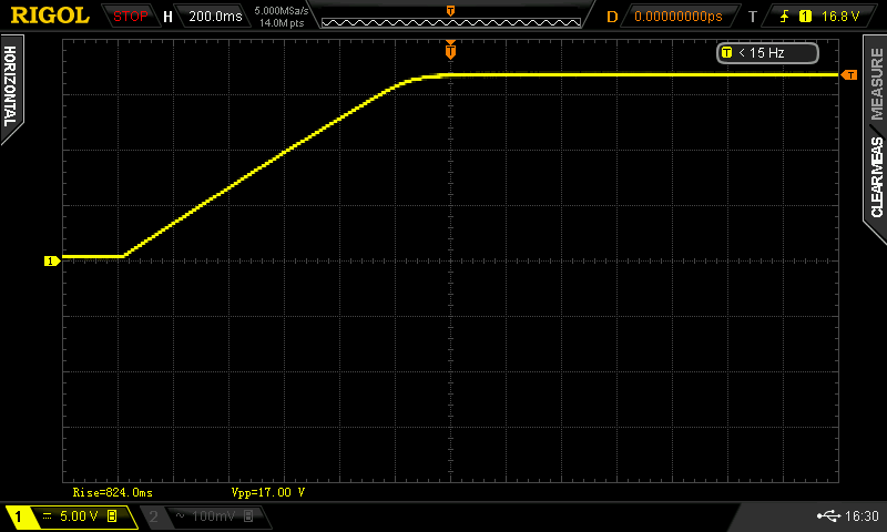

1. Anything testing 3mA idss and above. That includes the upper reach of K and all else. I did not see significant THD differences in circuit between the fat and the slim during breadboarding although in the end I plan to retest those subjectively too. Right now I run two slims.
2. I do not hear anything when powering on before the clicking as it is. When it clicks I hear a faint "plop" so I am happy with that. Tham reported the same on his high sens speakers. Normally nobody turns on the power amp first and only powers down a preamp last. One of the beta testers does not use the relay circuit at all because he always follows that sequence. But I think a delay should always be there since there is a DC settling cycle just to be safe of accidental misuse. You want to arrange it shunting, fine. Easy to re-arrange it under the relay pins. Just ground the second from the top and short the third with the fourth on each side. I will also recommend alternative 100k Ra to extend the wait time to 10sec now that I think of it because not all PSU types have the same ramp up profile and may promote longer settling.
3. That's nice theoretically and I am aware of it but with higher value 1uF C5 I wasn't happy with the DC offset chase speed and control. Too slow a control loop in this one. I started with higher value R14 also but I wasn't happy before 10K too. Many OAs look fine for the job on paper or work best in many designs. I just recommend what I can test best from what I got in this one. Freely test more and choose your own. AD825 is a nice single cousin but SMT unfortunately. Needs adapter.
4. That's for ease of heat with double mono PSUs and its the most benign series. Has no error amp, its not a real regulator, sounds good. Because there is PSRR in the main circuit. I can only tell you how near to using shunts when I will compare a fully done boxed preamp to my friend's that has the shunt. Anyway PSU as choice is individual, its a separate pcb audio circuit that can make use of anything. Can even test with an LM317-337. My bench supply wasn't making it sound bad for instance. Although the stabilizer was better. I have seen tendencies for instability without C6 C7 due to PSU incoming wiring. I arranged to two wire mode my friend's beta with the single common SSLV and it stopped. I had also seen it unsettling with long leads from my lab supply. You can use 85C Nichicon FG for those because not near the hot end. If stable rail on the scope in your wiring arrangement you may skip them or think of something fancy. But local reservoir near the Mosfets is a good thing in general.

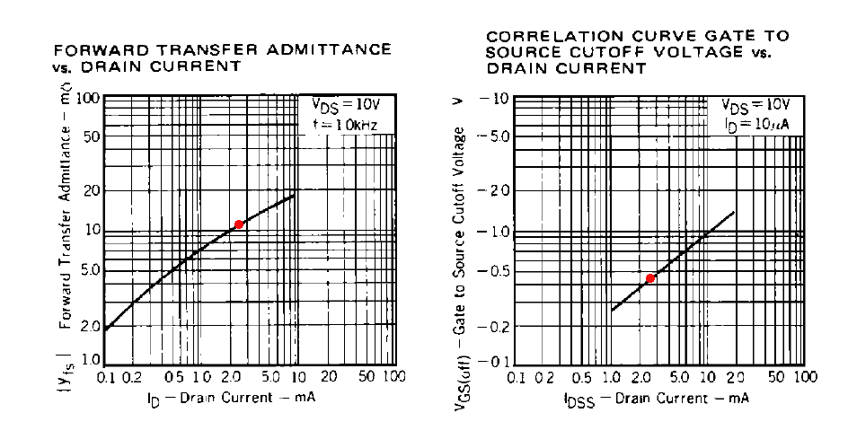

Q1 & Q2 are a mirror set up to pass unequal currents down to J1 & J2.Any >3mA idss sample and preferably of no more than 2mA idss difference to use between channels will do fine. The LTP's tail CCS forces the units to bias at about 2.5mA Id per LTP side. There the Yfs is the same for any >idss unit because fixed lower on the curve. So no need to have many for producing careful matches.
J3 sets the total tail current, it does not set the LTP halves to equal current. The current through J3 could be anywhere from 51% to 80% of the J3 tail current. That would leave anywhere from 49% to 20% to pass through J1.
I have not built this arrangement, but I can see that J1 and J2 will not have equal current and thus have non equal transconductance.
And there is no fixed resistor to show what current is passing through J1, J2
I think a fixed resistor in the emitter of Q2 would sort this non equality.
Maybe there is another reason that Salas has used a non-mirror to set the LTP currents.
The difference could be intentional and part of what determines the harmonic profile he desires for the amp.
