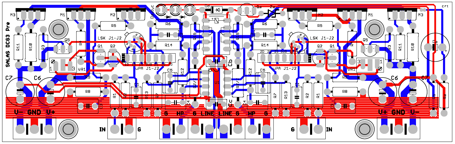

Is it possible (Salas) that a picture of the pcb traces could be posted here ?
I would like to compare my own layout!

Attached

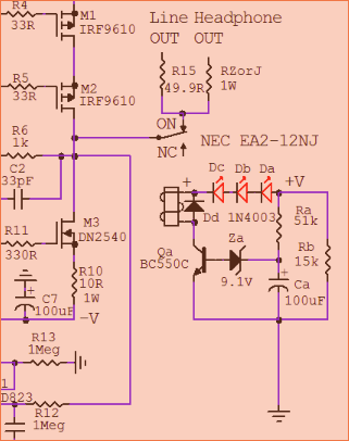

Isen't the relay supposed to make a connection after a short while to lineout, when preamp. is powered on, for avoiding turn on thumb?
Am i right Salas that youre schematic shows an engaged relay ?

Yes my schematic shows it engaged. That will nonetheless happen after some seconds.
Now that I think about it nobody ever asked me in years of Mezmerize builds why I put a diode across every relay coil like with Dd here. Do you all know why?
Let me take a swag, "The diode eliminates a relay 'transition pop' that would otherwise find it's way into the audio.". How did I do?

Good guess at the side effect. The main event is: As the coil's magnetic field instantly collapses when its driving transistor switches off it creates a current pulse that needs a path to the supply unless it will push against the now very high impedance transistor path creating a transient in the hundreds of volts even. That will wear out and eventually kill the transistor. Will also do its best to couple as EMI pulse everywhere near.
This is a good explanation Salas 🙂

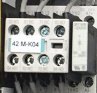

NOT to be offtopic, but i think this is important to know(or interessting)
But i was told many many years back, that the purpose of the diode sitting across the coil, not only has the benefit of protecting the electronics, against spikes. The catch is also, that the diode shorts the "self-inductance" which is engaged in the coil, when supply is cut (The coil tries to hold the magnetic field); So actually the diode also gives the relay a faster cutoff sequence, preventing sparks on the contactor too. So diode also protect the relay...
I also see this everyday in the industri.
I have attached a picture of a diode sitting across a coil in one of our cranes here at Port of Fredericia
Just my 2cent's. 🙂
Jesper.
the back emf diode slows down the release of the relay.
Adding some current reducing in that diode route helps restore some of the OFF speed.
This can be a resistor, or a zener. ESP discusses this.

Because no capacitors are in the signal path a relay system timed to 5 sec delay by Ra Ca lets no settling bump during power on to get out. It also disengages quickly during power off. Dc Db Da LEDS drop the rail voltage to 12V relay safe working range territory. And you know its on. One of them can be actually brought to the front panel as "ready" sign because they light up only when the relay clicks.
