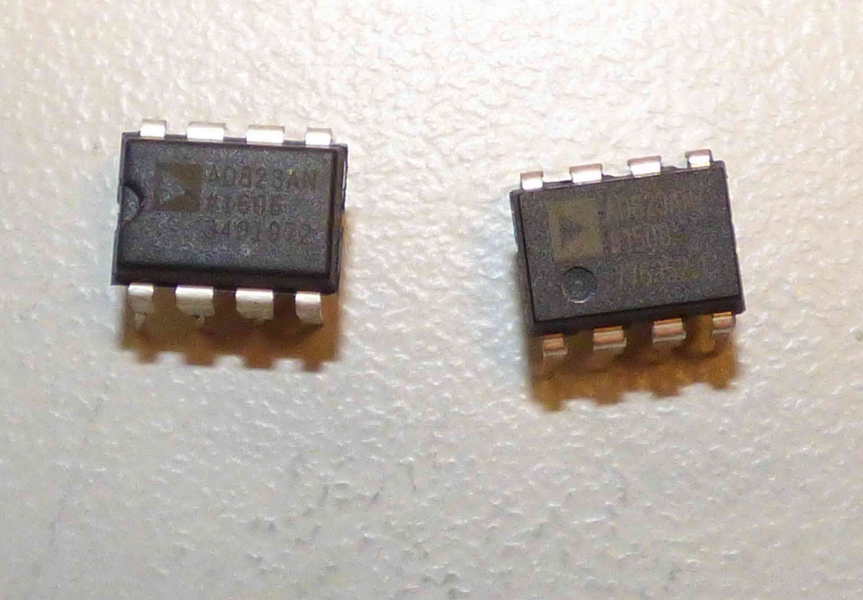

George, how was your offset? I forgot to ask. As I am am interested in how the AD823 copes statistically for its spec tolerances in various builds.
Offset +-0.5mV maximum that I measured over several minutes.
Also rails voltage sag about 0.1V when I connected the amplifier.
Andrew, I know, inputs will be replaced with shielded wire next time I open the lid. I just got fed up stripping cables! Although there is no ill effect I can detect, even on FFT, at least in my environment.
Also will try a 10K pot, as I have a DACT one to spare. For the time I have a 50K Tocos.
Left is original from TME.
