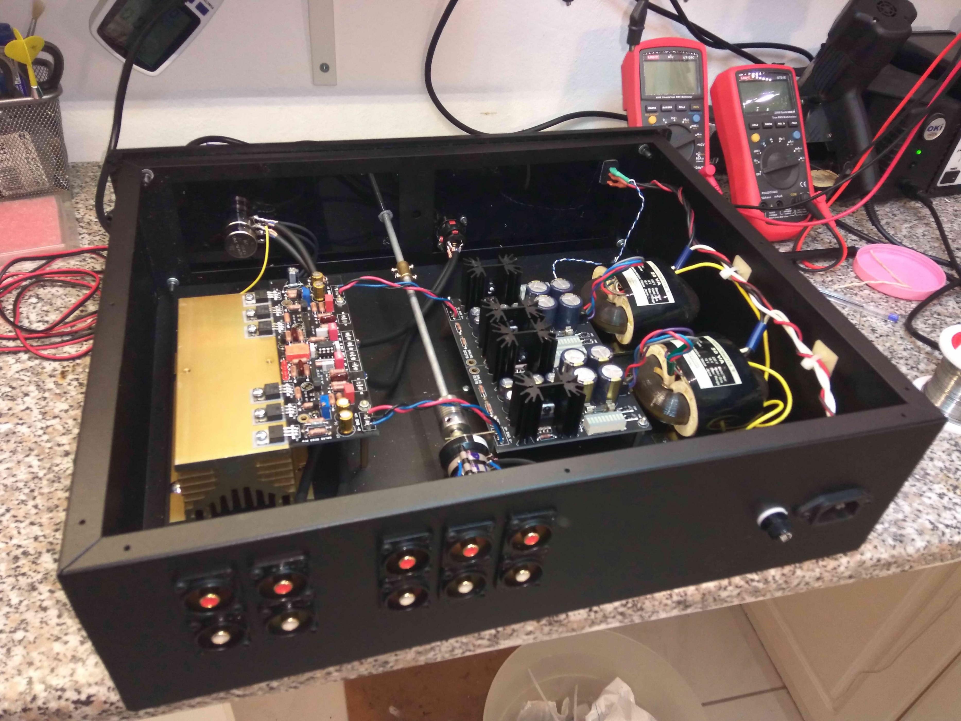

What are the two violet and one black wire doing? Connected to a common chassis bolt?
The loop areas at the input sockets are very big.
The exposed core should be very much shorter.
The pig tail should be much shorter.
Aim to keep the short pigtail very close to the core for low loop area. It would be better to have two smaller pigtails, diametrically opposed and connected to the barrel beside the core/Hot
Hi Andrew,
The two violet wires are shield wires from the trafos going to the chassis safety earth, the one black wire I think you are referring to is actually green and it is the safety earth wire from the IEC socket, and yes they are connected to a common chassis bolt.
I'm not sure how to reduce the loop areas of the input sockets, the selector switch will be mounted on the front of the case, so the input wires need to make it up to the switch and pot.
I'm not sure what you mean by the exposed core.
If by pigtails you mean the low voltage secondary wires leaving the trafos, I left them long for now to test the PSU, once everything else is wrapped up and functioning I'll trim them short.

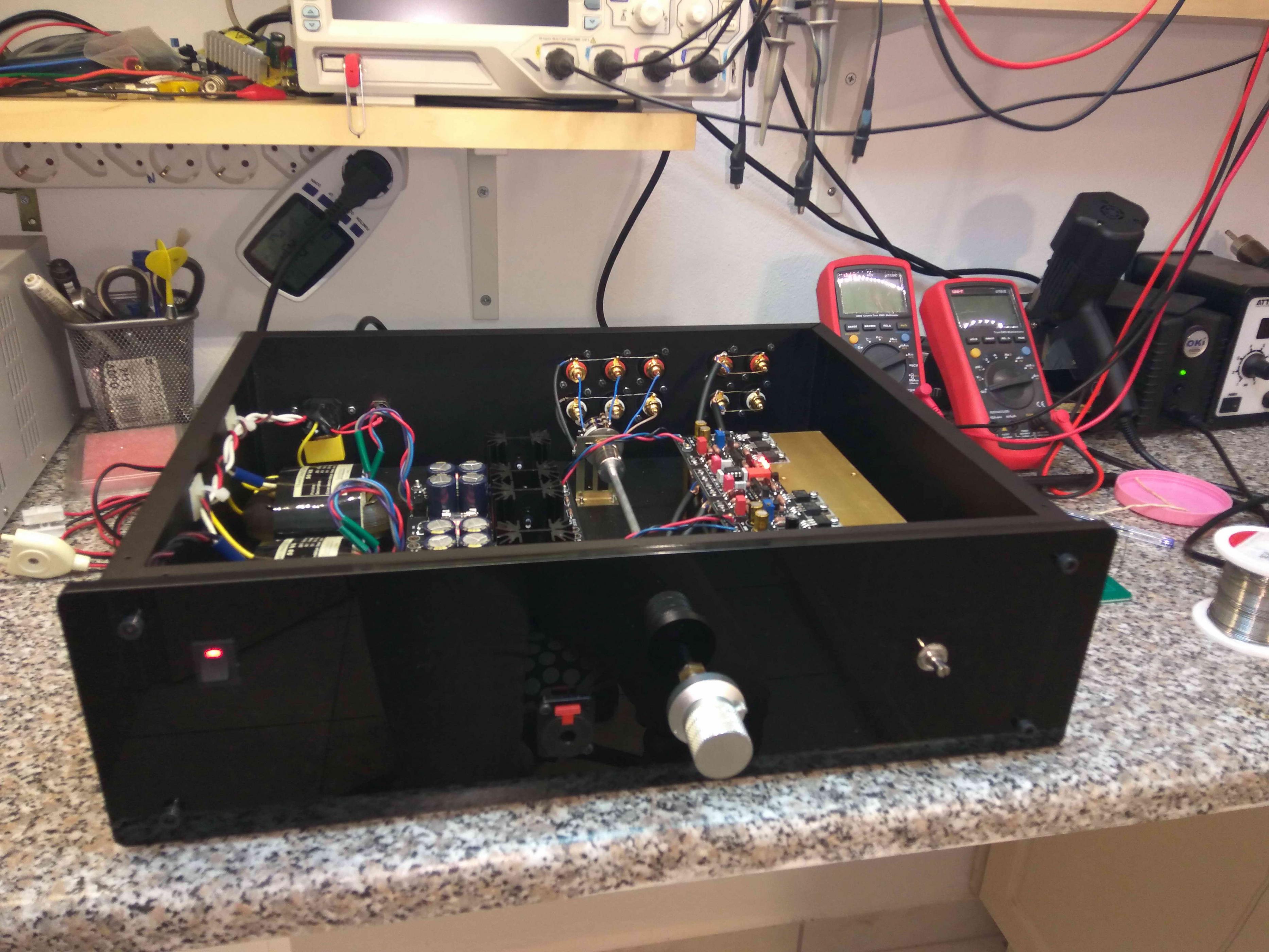

Completed the cabling and finished at last.
Only waiting for some new knobs, as the first ones I ordered were lost on the post.
It sounds better than the single BIB one, but the transformer on the BIB has to be replaced, as probably it inserts some hum and is not very silent, so this is not a conclusive judgement.

Very nice chassis... where did you get it ? -DIY?
Congratulations with youre build.

Is this Selectronic or Audiophonics sold r-cores? Still all good?
As always can't decide these or Audio Toroidy.pl.
From Selectronic. Absolutely silent transformers. I am very happy from r-cores in my builds. Toroidy has some good ones too, haven' t try the low wattage ones though and the audio grade ones were more expensive than the r-cores.

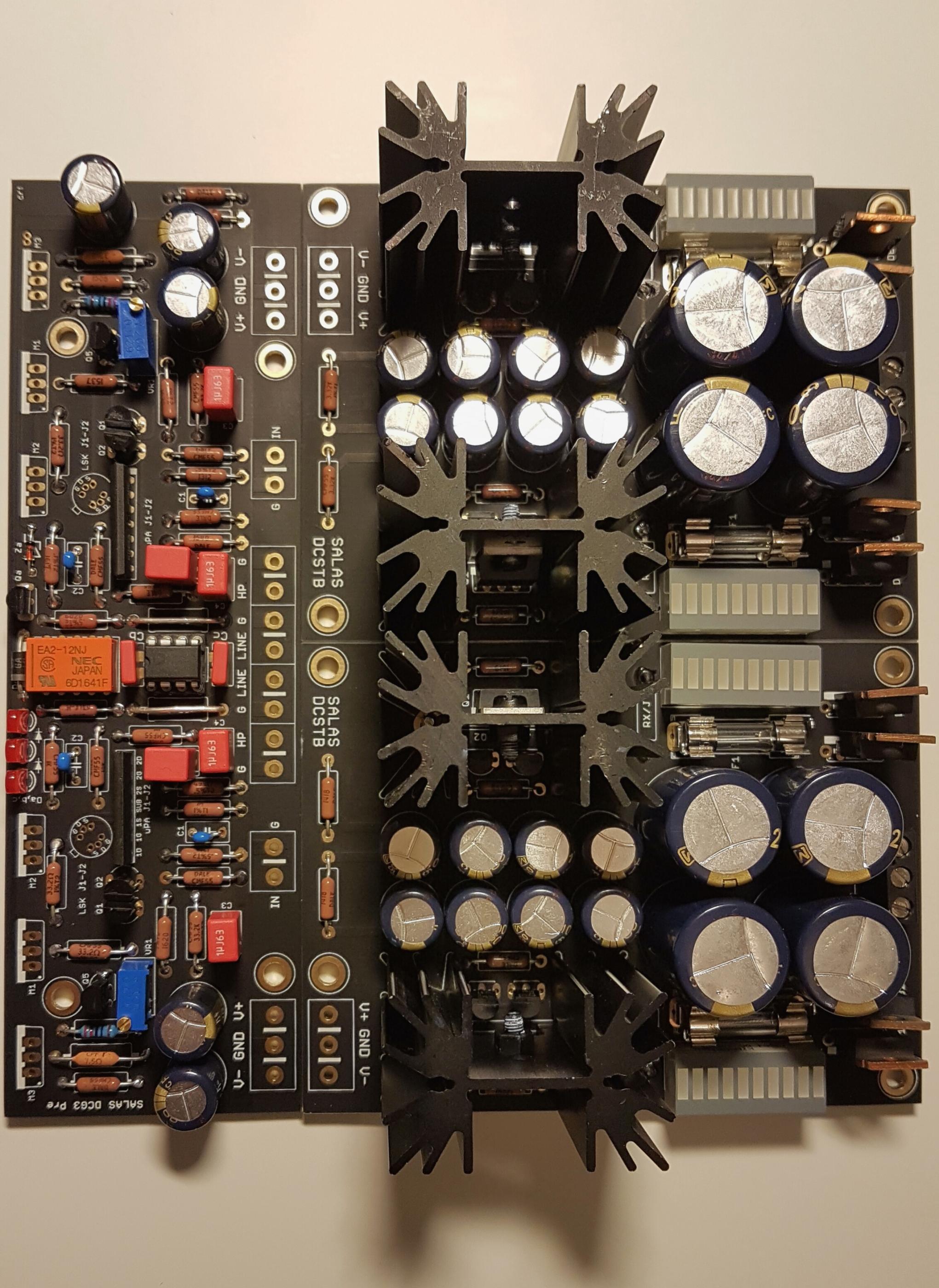

Yes - those links just fitted in the holes 🙂 I had the wire in front of me when assembling the board 🙂
I had 8 pcs byv79-e in a bag which I had never used and I did not want to store them anymore 🙂 Thats the reason for trying them here. If they are not usable in this config It is easy to change them to the specified ones in the group buy.
