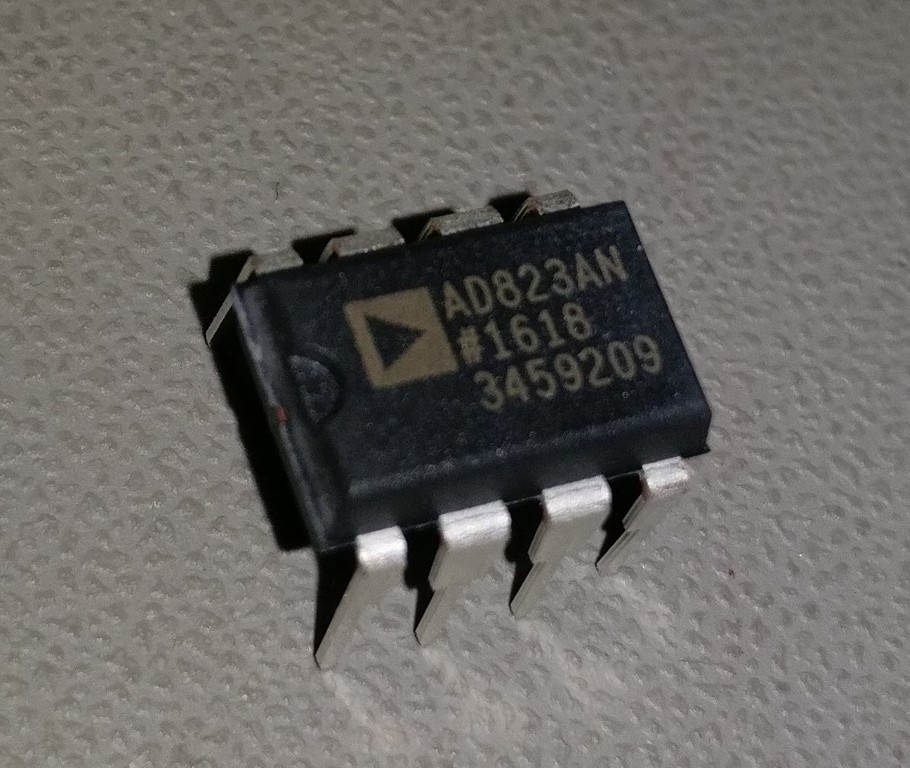

The right one must be fake. Mine have the same lettering and orientation edge dent like the one on the left.
So does mine. I got it from Mouser.

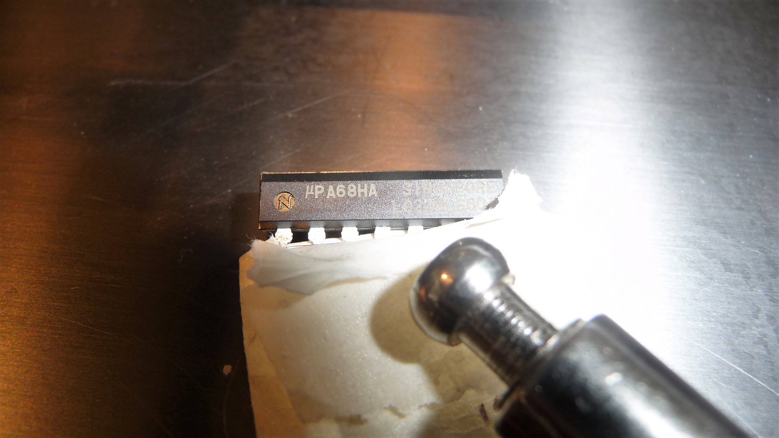

Probably being overly cautious but for mounting the uPA68HA (J1-J2) on the DCG3 board - does the thick white line on the board correspond to the letter N on the left side of the uPA68HA as shown in the photo?
thanks

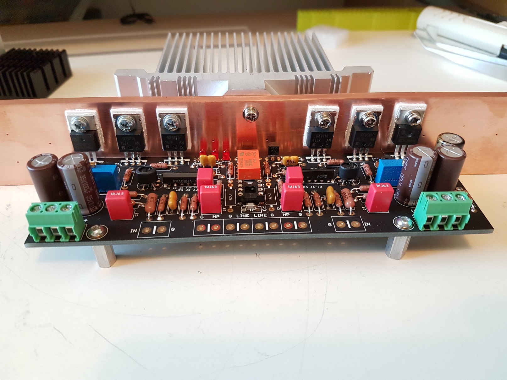

Here is some in progress pics. The case is too small, I know. Psu is lm317/337 followed by a cap multiplier that will sit on the sink opposite of the amp board.
Iam getting +17.6v and -17.8v out of my lm317/337 and cap multiplier when unloaded. Too high or just about perfect?
