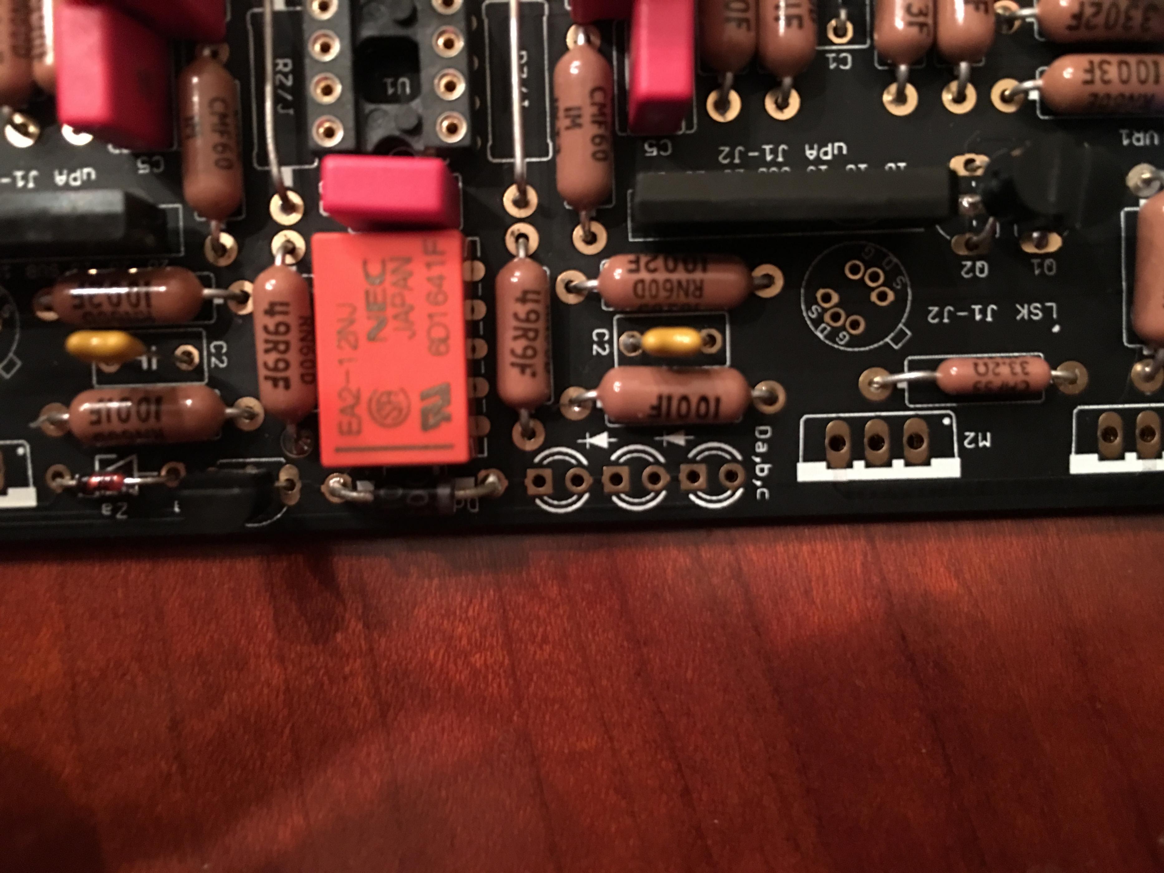

Question about the LED orientation on the boards:
Typically the square pad on the pcb indicates cathode (neg) I think. The silkscreen on the pcb says square pad is positive. I believe the silk is correct? Get this wrong and bad things could happen.
Silkscreen is correct?

No worries, tomorrow is soon. What are those light blue resistors on the PCBs?

The resistor are MFR5 half watt 1% metal films.Others are a mixture of Holco H8 and RC55Y's.
