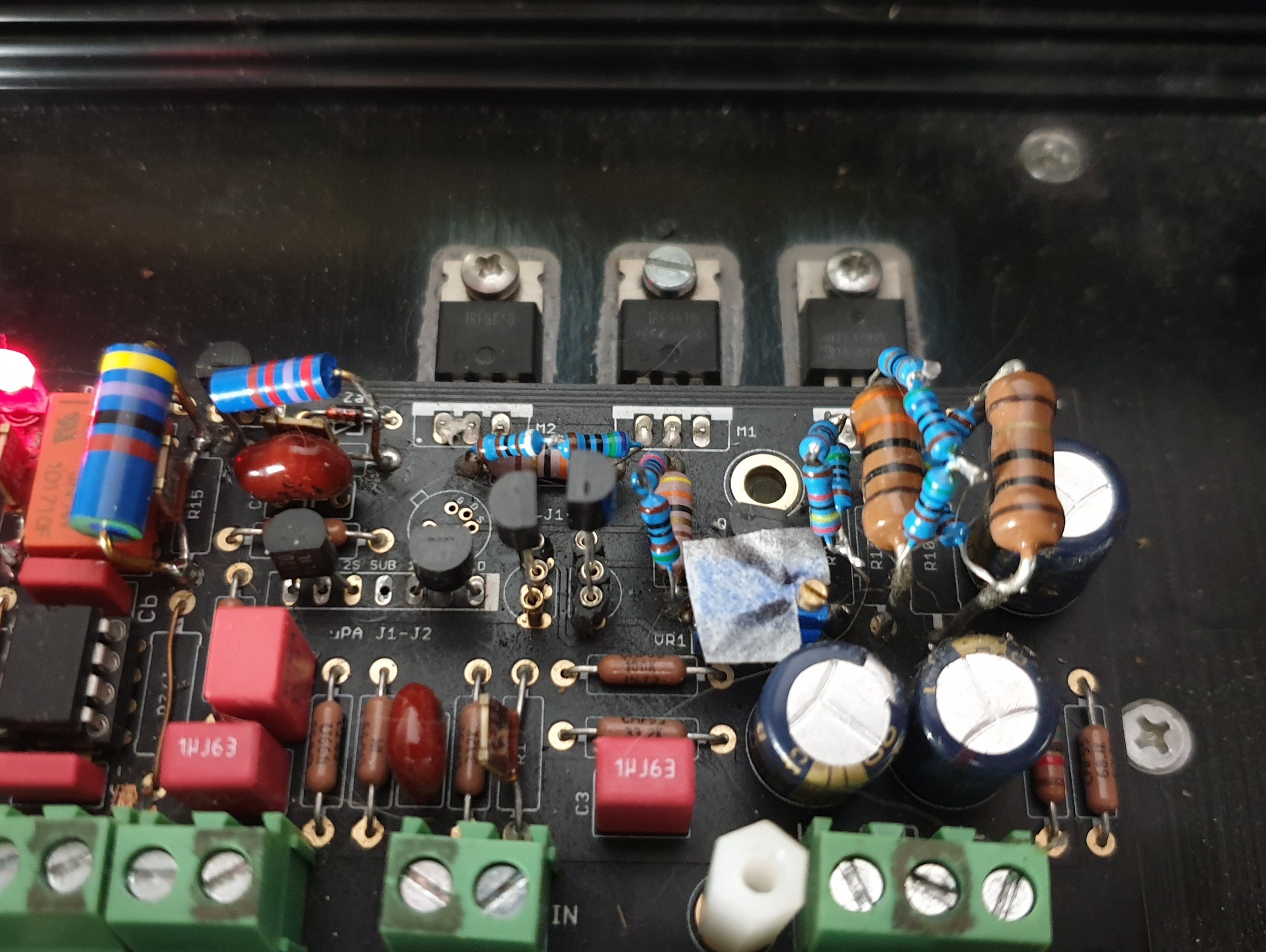

Hi, just finished right now the shootout, bc560 are not tested, guess Ok as are coming from parts kit. BC327-40 lukily I have plenty, picked a paired strong idss ( 44,4 and 44,2).
In advance I placed three pin sockets for a convenient quick removal, also I add to the bias trim an small adhesive tape, to help set correct bias values for each transistor pair in a quick swap.

First listen is bc327-40, I could'nt find any weakness, the flow is so natural I let the entire side on play.
After swap to bc560 the listen not same, soloist instruments much less rich timbrically, it is a glare I would not say metallic or agressive, not at this extreme, just a dusty or grey glare, that makes boring the listening to this demanding music. Other parts more complex, armonies between instruments, sound even worse without authority, much weaker sounding in a word. That prove evident after a quick third listen, back to the bc-327-40.

Maybe you mean hfe (beta) 444 & 442 for the BC327-40 pair? Because bipolar transistors its impossible to have Idss. That's for JFET & DMOS.
Technically the BC560-C gives more open loop gain when in this current mirror which translates to more feedback and its also a faster type. When the BC327-40 gives some lower open loop and its slower but has significantly less inherent noise. Especially in the 1/F area of low mids and lows.
