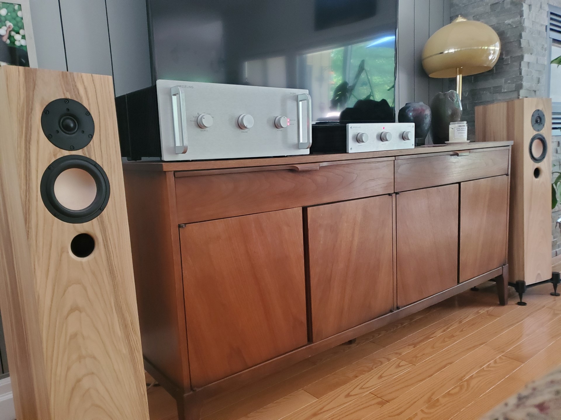

At the moment the DCG3 is connected to 50W class A amp. It's actually an integrated with a B1 buffer that is bypassed at the rear connection panel.
The 2way speaker is my design.

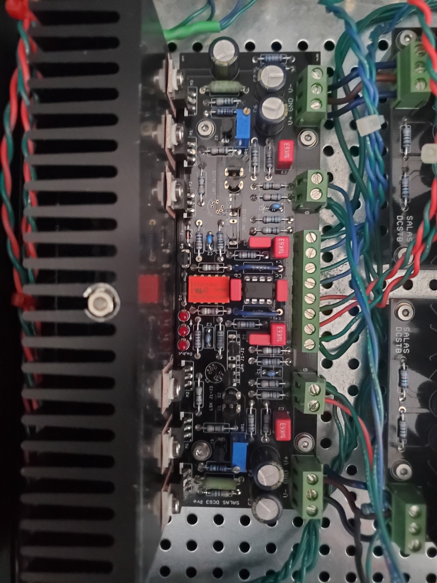

I have another DCG3 ready for final build and had some etching done today. Same box/layout as in photo post 6,923
In Both units RZJ is a short and R15 is 49.9
