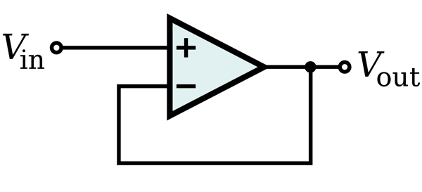

An interesting collection of diy projects indeed. Congrats for being an avid experimenter. For that reason here's a left-field idea for as long your dcg3 remains in open plan state and still easy to tweak:
If you like to try a detail trait boost trick you can put a buffer op-amp between the pot's output and the dcg3's input. This makes a dcg3 run full bandwidth and max slew like no volume pot impedance is there. It may upset its balance of traits positively or negatively depending on the headphones model. Easy to evaluate.
Needs a Fet input type unity gain stable high performance chip. Any product you like the best. Just a wire link between an op-amp's output and its inverting input makes it a buffer.
Simple to put together. A tiny perfboard, +/- rails tapped from dcstb outputs, local decoupling 0.1uF small film caps right next to the chip's power pins, that's all.

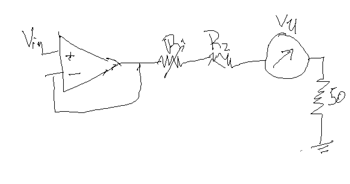

Thinking about this buffer option, I 've found a nice case that has two VU meters. Would it possible to get a parallel output from the headphones, feed it into a buffer as described and then:
Something like that:
would that work without affecting performance?
- from the buffer output connect a series resistor and a multi turn trimmer for VU meter calibration
- In series with the trimmer the VU meter
- and then a 50Ohm resistor to simulate a load
A buffer isolates so driving a VU meter through one shouldn't affect the main outputs.
*VU driver circuits also involve diodes rectifying the signal. Must be flexible to different meter models for correct needle deflection and motion.
Do investigate prior art for examples.
