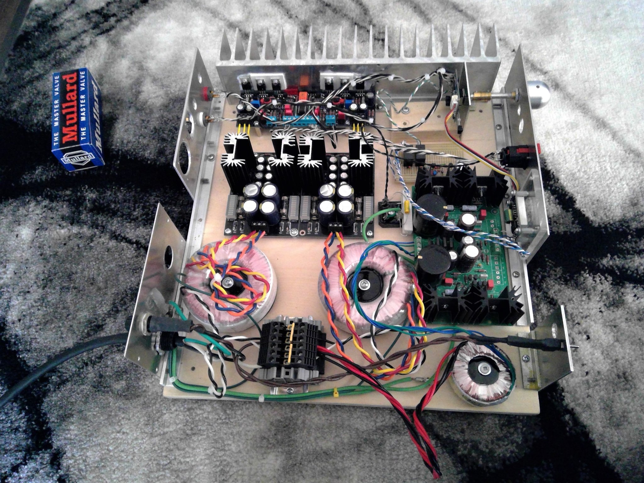

Huge thanks to Salas for his design and support as well as to TeaBag for putting the kits together. I have been using the DCG3 powered dual mono by the DCSTB, as a headphone amp, for a couple of months now. It has beaten all other head amps in my possession. Despite being built on a piece of plywood with none of the wiring trimmed to final length, at least until I am finished experimenting and put it in a proper enclosure, it is dead quiet. I originally used a DACT 10k CT2 volume control that I had from a previous project, and it sounded great, but when I switched it out to a 20k Muses based VCX from Academy Audio the sound lost that last little bit of edginess, with no loss of detail. Not an apple to apples comparison I know (10k vs 20k) but the Muses stays. I want to try an autoformer volume controller I have next. My headphones are Audeze LCD-3 and coming from MassDrop HD6xx phones I found them a bit dark with the DCG3. I had a matched quad of Toshiba 2SK170 from a long ago planned DCB1 that I never built, so I pulled the uPA68s and installed the 2SK170s in the header and voila, a perfect match for the LCD-3s, at least to my old ears. No change in detail or dynamics, just like someone washed away the darkness. Maybe a bit less second harmonic? Again a heartfelt thanks to Salas; of the six headphone amps I have or have recently have had, this is the only one I want to listen to.
