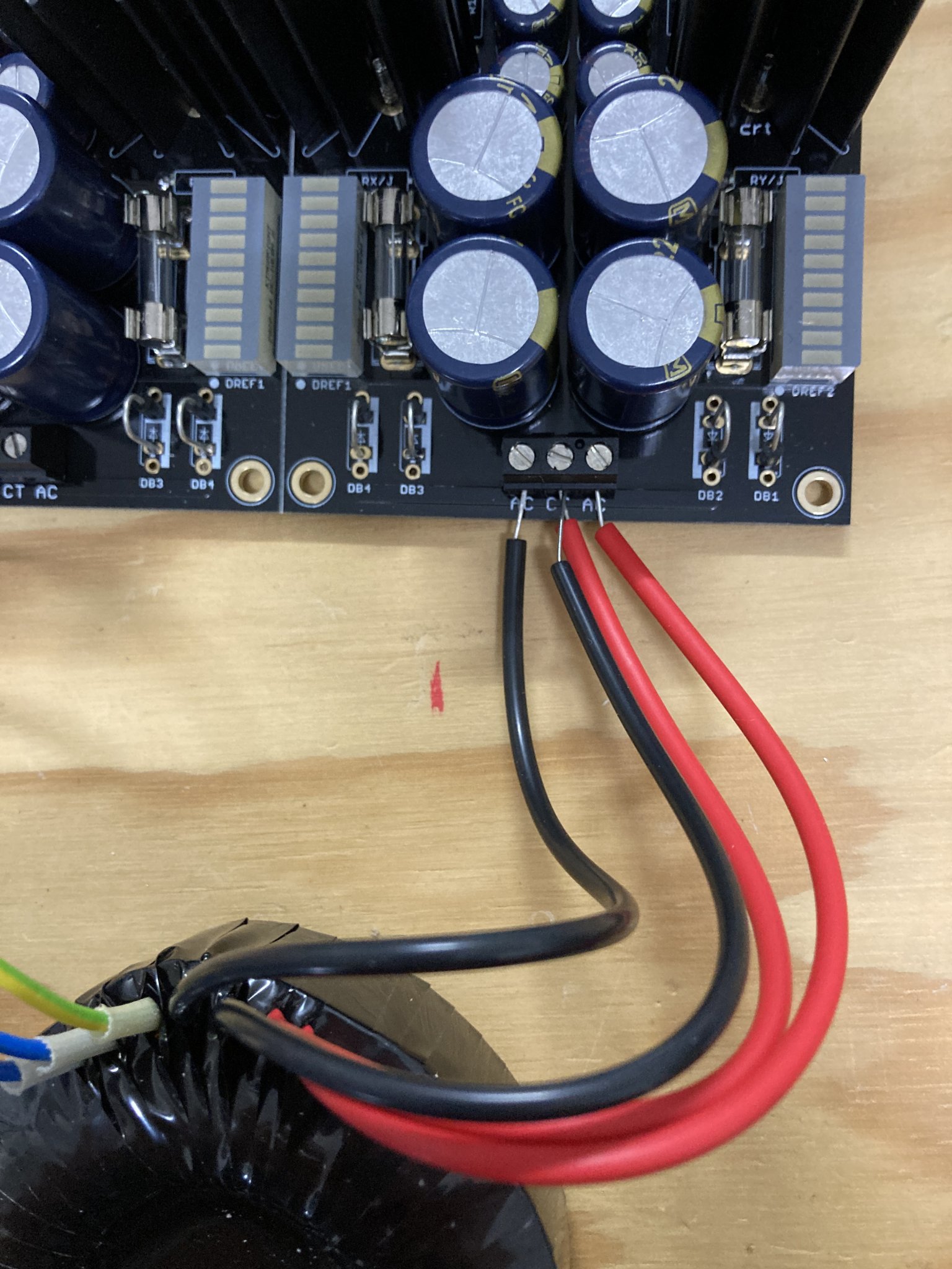

Just to be sure, this is the correct way to connect the toroidy 2 x 18V 50VA?
(red — red+black — black)
Before I blow everything up I thought I‘d better ask 🫣
👍Your build's degree of +/- rails agreement is remarkable nonetheless. Especially within each channel. Indicates careful JFETs selection and good LED bars Vf consistency. The safety criterion for rails in a DCG3 is they should definitely measure below the U1 servo op-amp's +/- 18V recommended max spec.
Since introduced nobody ever reported a DCSTB overshooting that criterion. That's something for a fixed output reg without a precision voltage ref chip using an army of transistors inside it.
Reactions: myleftear

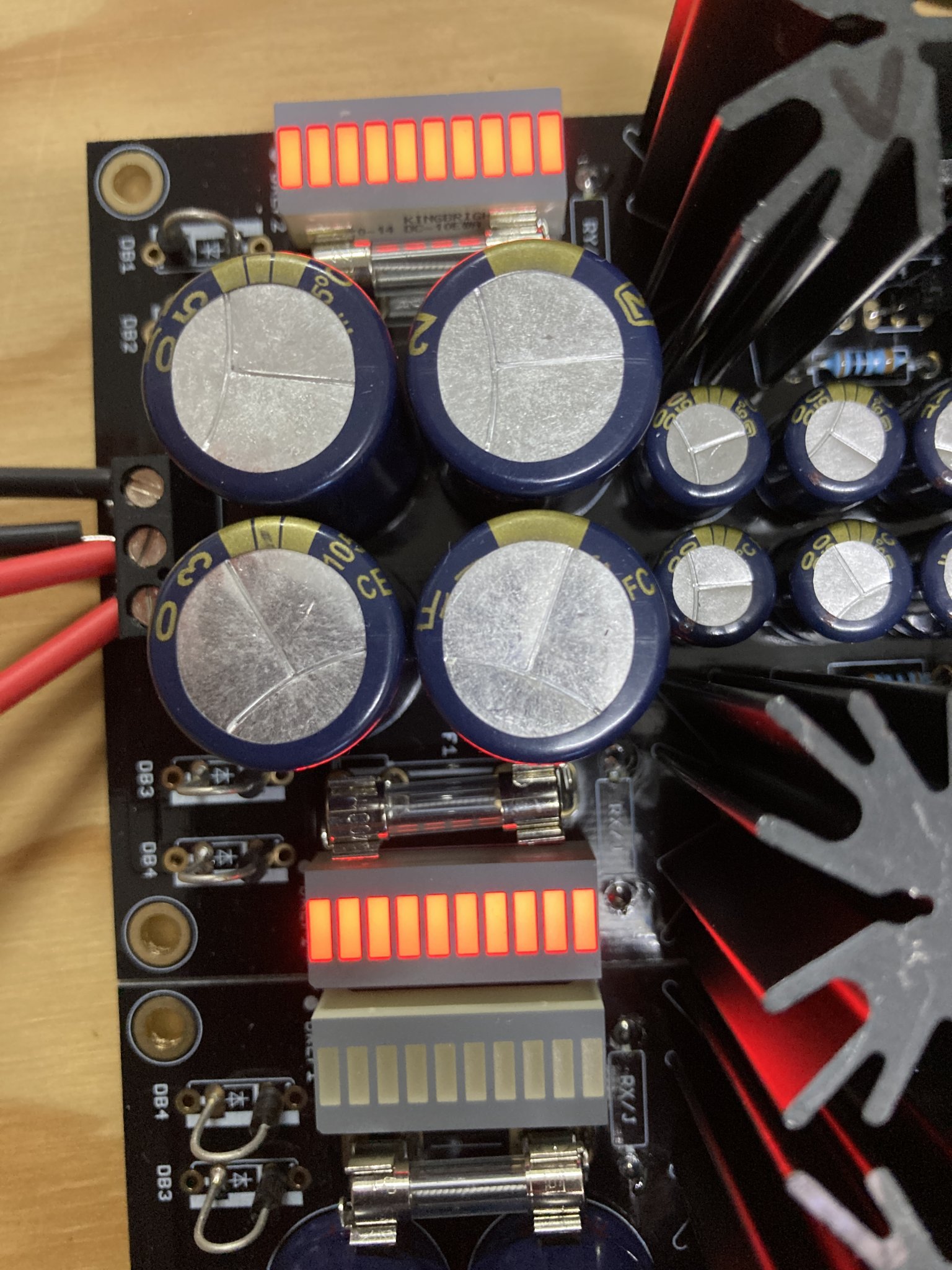

I am slowly making progress. Just forgot to make a few pics, they'll follow.
Just mounted the board (and the mosfets) to the heatsink (yes heatsink 😉 ), layout seems to become very nice, wait and see!
Just a liiittle question: On the board, on the edge next to a mosfet, is a very small position for ... something? there's a trace to a resistor, but the holes aren't specified, and they seem too small for even a LED?
uhm... probably because I prefer it the complicated way, I'd like to hook up the I-select by AC in. DCSTB ist a center tap-configuration, can I still do it? Or must I go and use the DC in? (There, would it be "not reasonable" to steal the DC from one of the DCG3's DC in (instead of using the legs from a DCSTB's reservoir cap?)
Better not blend two bridges with one AC source. Because I-Select has a bridge too. For standalone use with own Tx. Using raw DC is preferable. I-Select has a 12V chip regulator for that. You can also steal DC from the stabilized & filtered DCSTB output but why opening a possibility of noise ingress there from the cabling to the I-Select.
