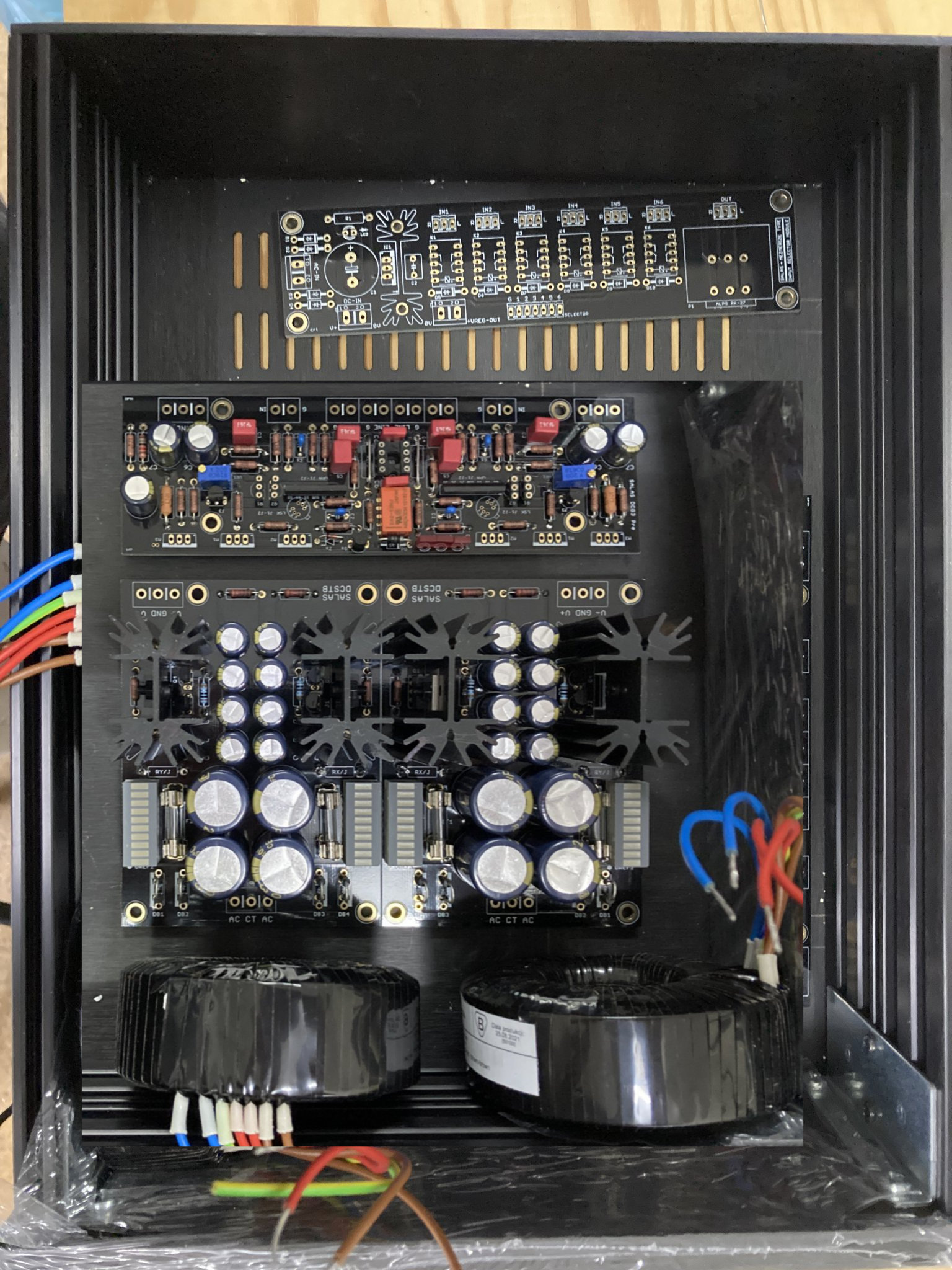

Toroids at the front, into PSU, into Line-Stage, into I-select, into in-/outputs... volume-jig must be "fly-by-wire" technology (muses or elma relay attenuator), as the toroids would be in the way of an extension-rod or the signal-wires would have to cross them...

This narrow box has thick side panels. Why not mount the main board vertically along a side panel. That way you free up floor space for arrangements and heat exchange is more direct.Thank you Salas!
I go with the jets on a bottom-plate (with good, additional passive aeration)
Is one layout technically better than the other?
For its symmetry, I prefer the symmetric layout, but the third option should be working too… (temp issues maybe?)
Oh yes! the vertical option! 🙂
Will mock up a bit more...
edit: (Box is a galaxy 2U 230 / 280, the side-panels are extruded aluminium—it's mass isn't very high unfortunately)

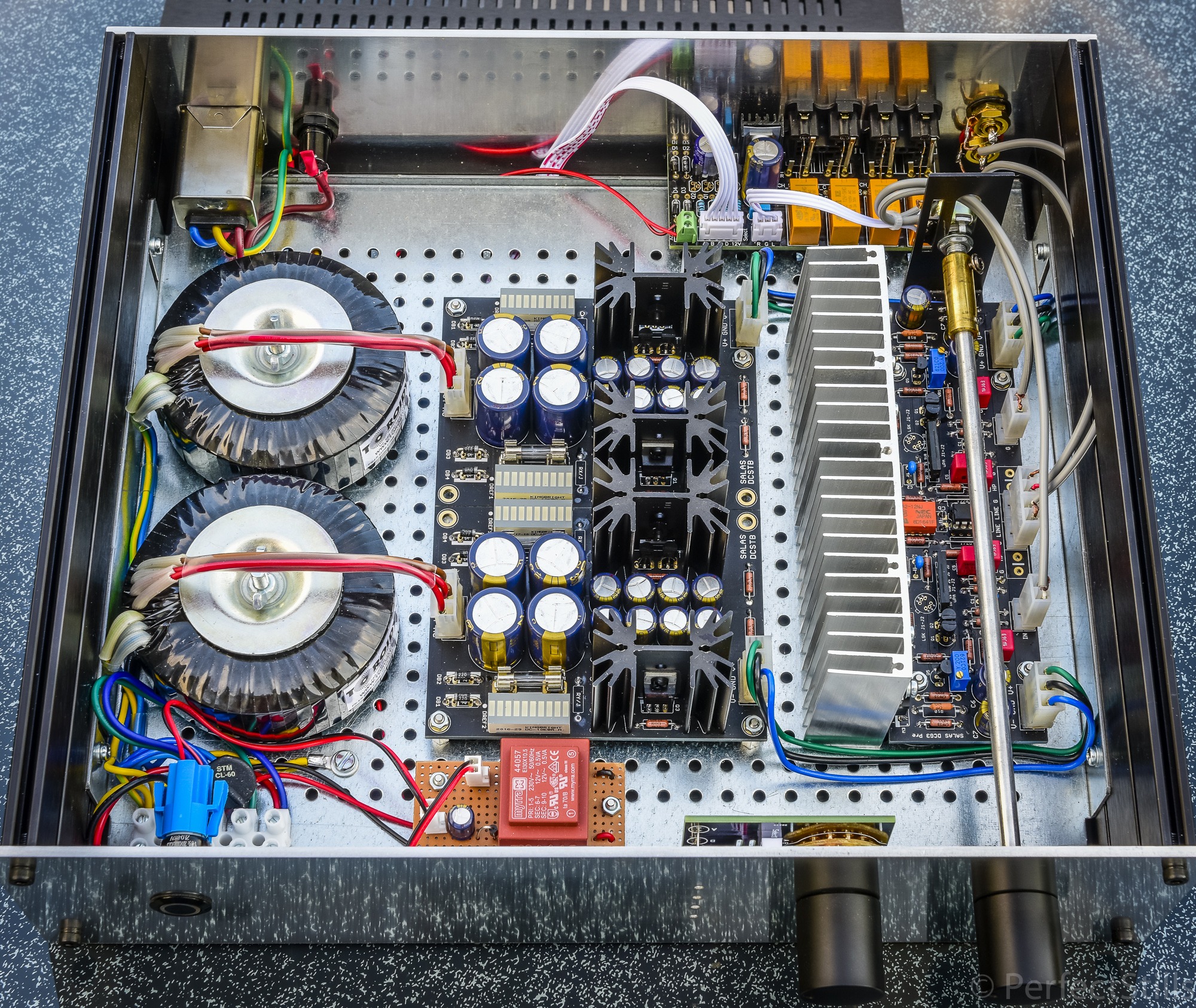

Was looking at your layout, and I have something similar, except the tx's are on the left because mains in the back and power switch at the front. This arrangement works very well. The main goal was to space the audio pcb as far away from the TX's as possible within the enclosure. I attach an image for your info and use. I you would like any other views just let me know. It is a most incredible preamp.Thanks Yurik.

Very nice and kind, thank you, Aubmar!
As you say, this is pretty much the layout I‘m after, except that I‘ll have to juggle a bit because my box is smallish…
