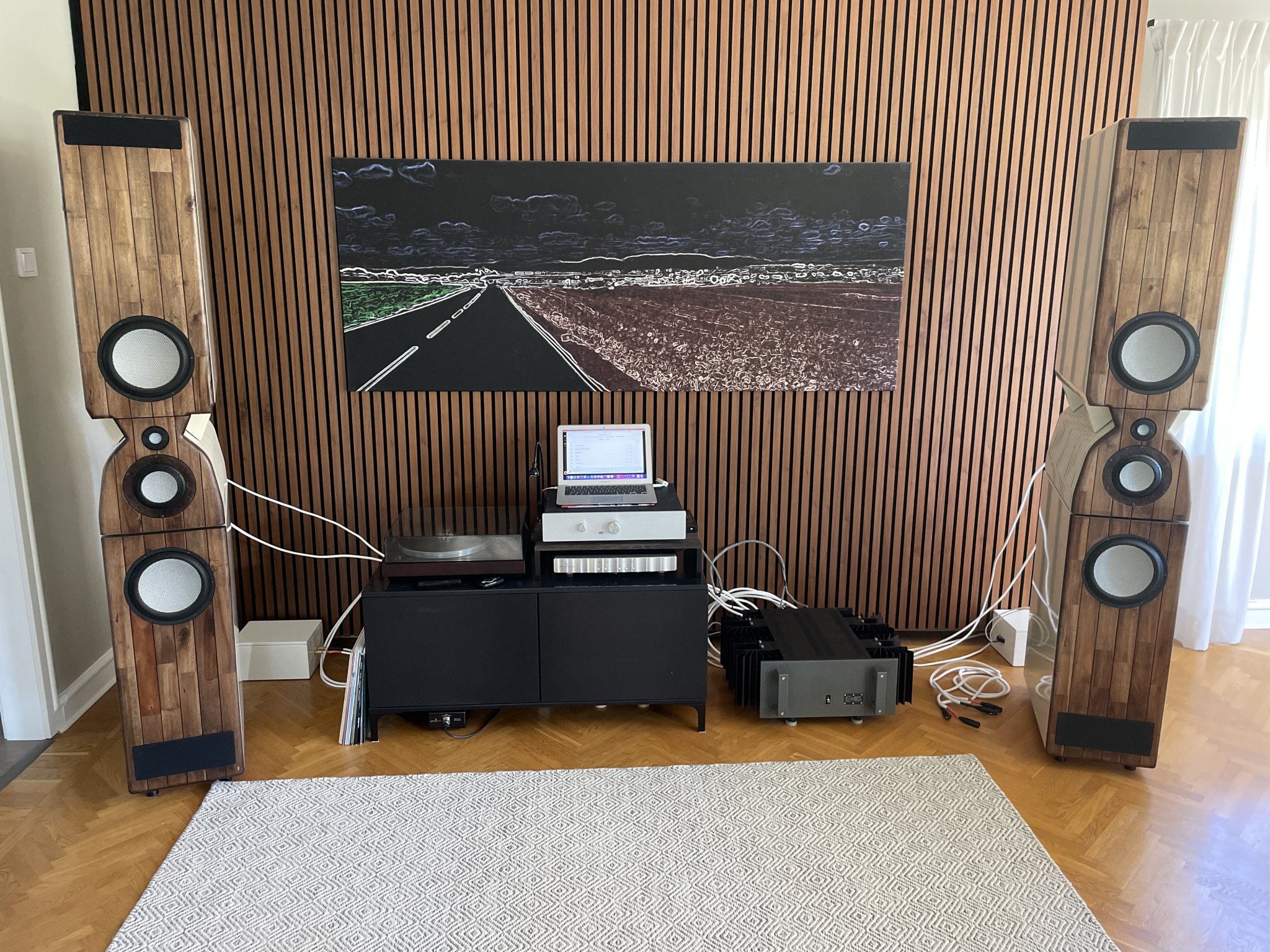

DIY Accuton speakers in transmission line. Some build pictures here for whoever interested. Forum in Swedish but pictures quite self explained.

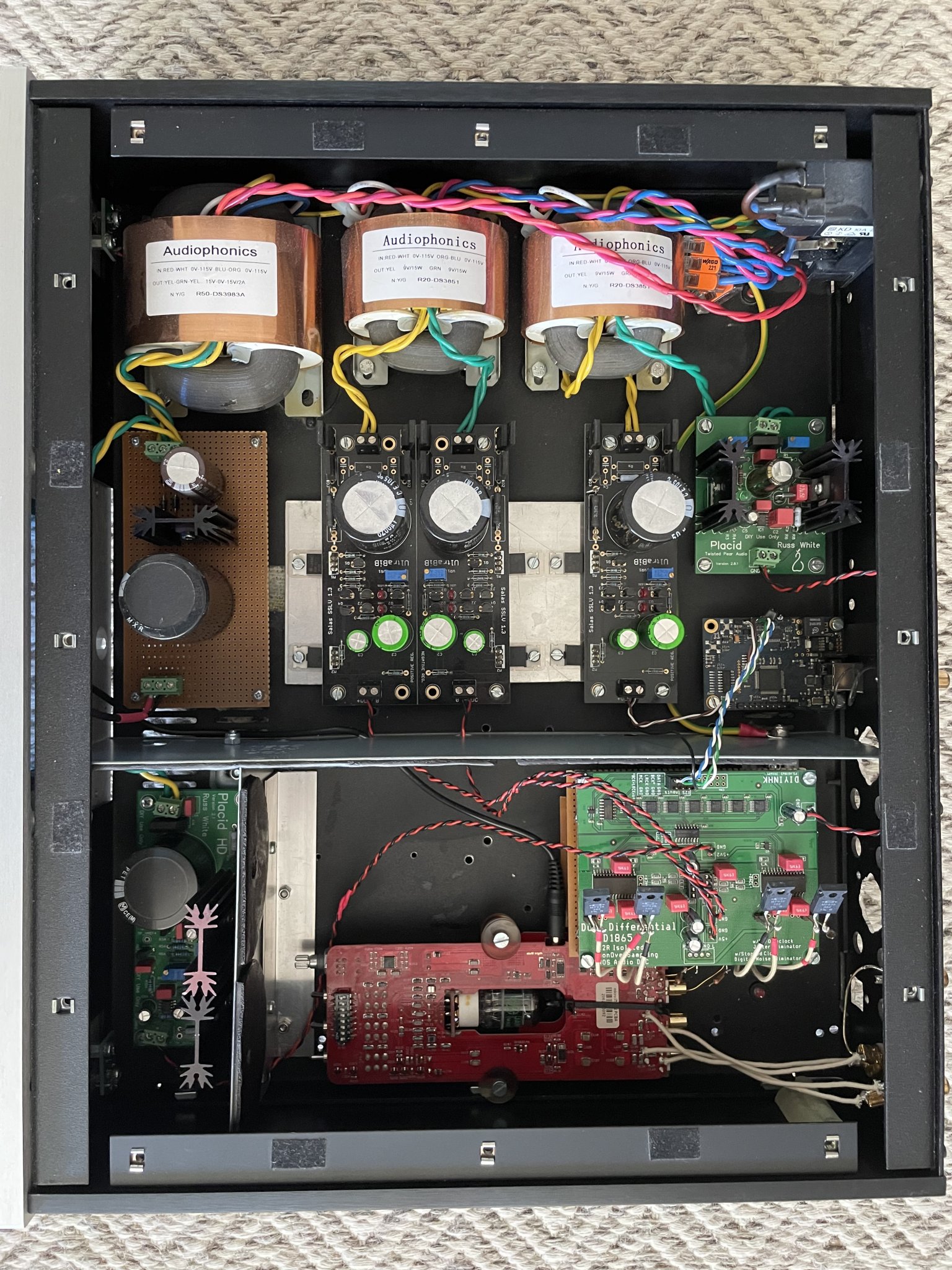

Your also involved in my dac as the picture shows😊 Hiding under the dac-board is a couple of Lundahl 1674.

Big system. We are talking serious craftsmanship skills in the speakers. Congratulations!
UBiBs in the DAC. You also plan to put remote controlled Muses attenuation in the DCG3?

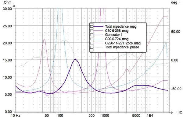

By the way, what is the 2.83V/m sensitivity of your DIY super tower speakers? They must be current hungry but voltage sensitive enough? Because you tend to mainly use CLASS A power amps I see.
Not too bad on impedance. I can use practically any amplifier, not necessary with a Krell! Runs nicely on my KT88 triods as well.
I picked 11ohm woofers, should give around 88dB/2,83V. If I could change something I would have used 6ohm woofers as I have to dampen my midrange.
But then I’ll end up with 3ohm in the low end and a current capable transistor would be necessary- choices😊

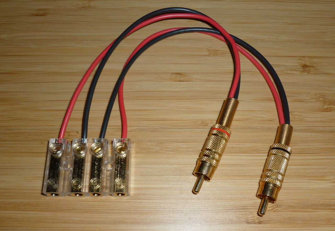

With loudspeakers close to 100 dB/W, it will be loud. Simple adapter:

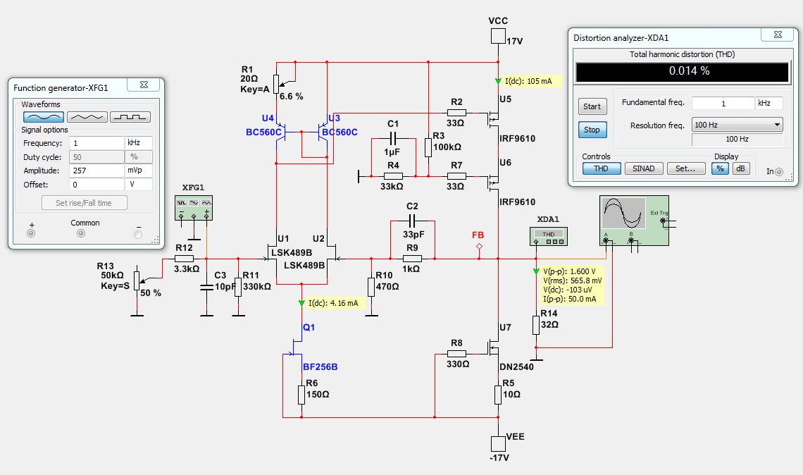

Huh, no need for a simulation with so many built and measured DCG3.I've made a simulation of the DC3G.
The squarewave looks very nice.
The THD distortion is low: 0.014%
Anyway, something is off with your sim as DCG3 has much lower distortion.
