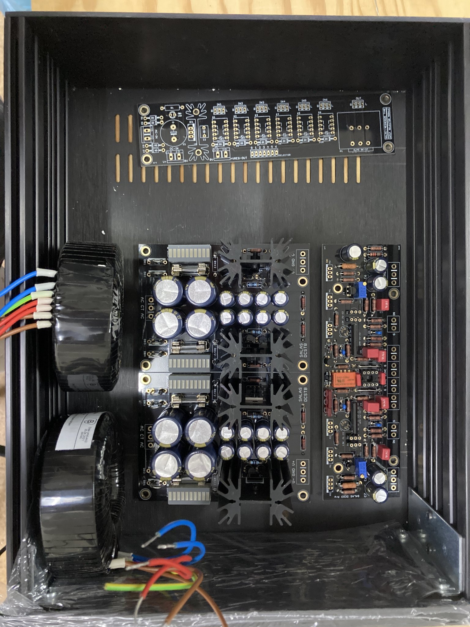

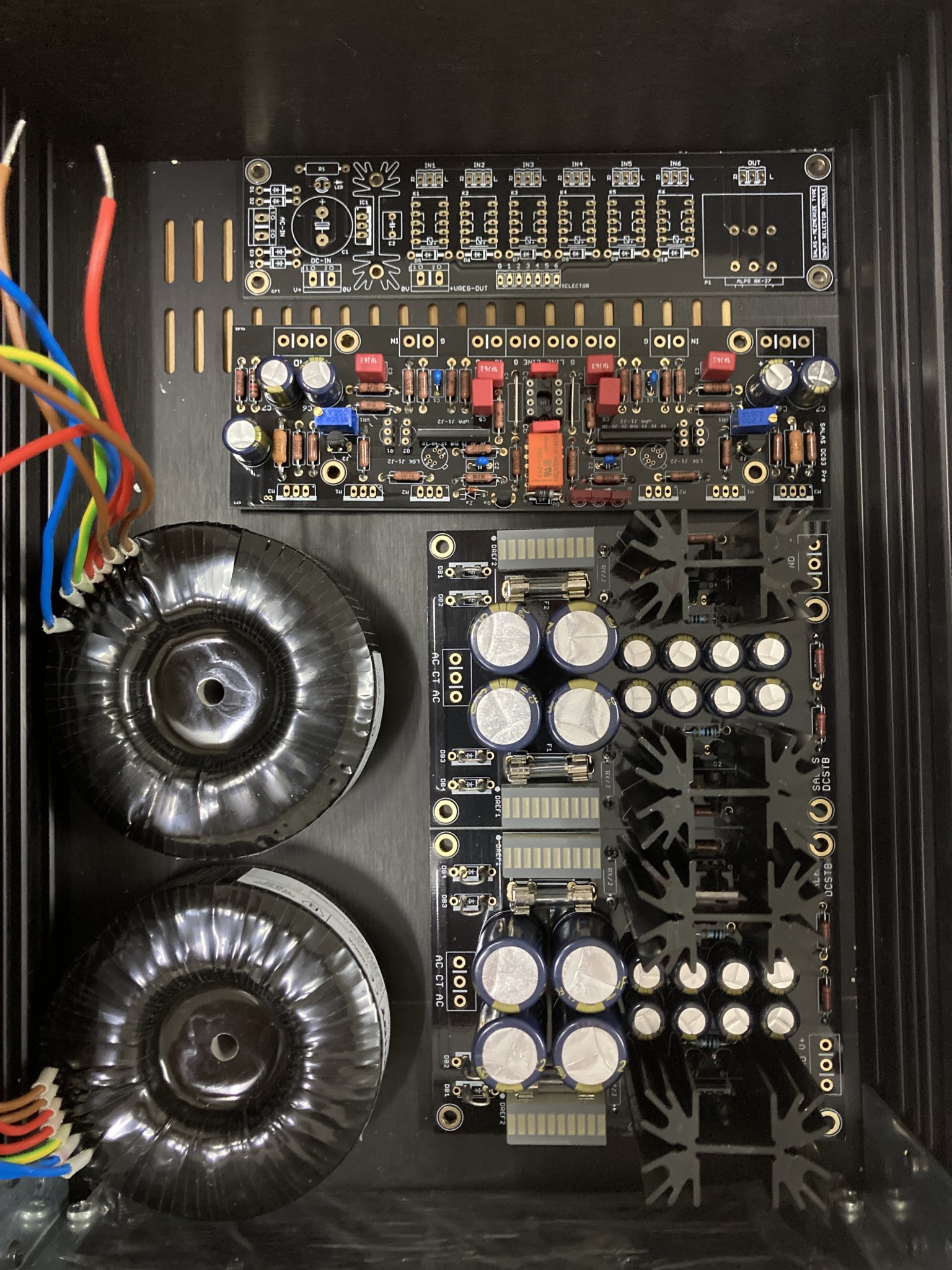

Heatsink-Question:
The build-guide recommends a heatsink 1.2C/W or 1C/W or a bar mounted on the bottom-plate.
I wonder a bit, as the heatsinks with those values are pretty whoppy beasts!
If the sink sits inside the enclosure with closed lid and the bias is 150mA on two channels it carries you would be surprised on how easily the sink heats up if moderate sized and without good air circulation in its vicinity. It takes both top and bottom vents by the way. I recommend using the enclosure for sinking via a Mosfets mounting bar. Or a side panel exterior sink type. A hefty enclosure like you guys usually employ has good metal mass and area spread while it thermally communicates with the room's air.

I go with the jets on a bottom-plate (with good, additional passive aeration)
Is one layout technically better than the other?
For its symmetry, I prefer the symmetric layout, but the third option should be working too… (temp issues maybe?)
