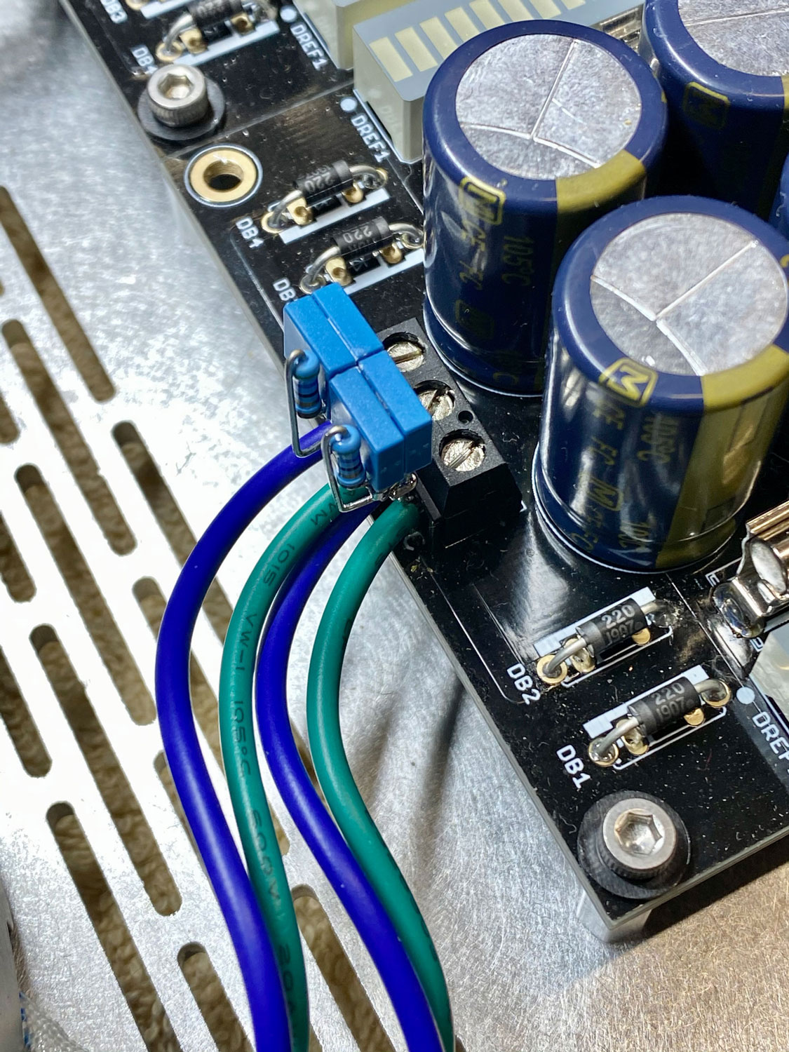

The i-select connection hasn't yet worked. I connected it from C1 (or C2), output measured a little above 25VDC, but i-select did not engage (no LED, no relay-click). I'll try to get it running from AC and see what this gives...
Another step though: Should I use a quasimodo-measured snubber-network, and is this the correct layout/location for it? (see attachment)
Many thanks
Many thanks
You attached the 25V raw DC feed to the in-selector's DCin connector and its LED did not light? The LED is driven by the 7812's output. Meaning a 12V DC regulated rail is present. Check voltages. Make sure you feed a positive polarity 25V raw DC to it.
Applying Quasimodo transformer secondary de-ringing network is up to you. If you got the test hardware. The DCSTB + DCG3 standard goes nicely even without it.
Thank you Salas.You attached the 25V raw DC feed to the in-selector's DCin connector and its LED did not light? The LED is driven by the 7812's output. Meaning a 12V DC regulated rail is present. Check voltages. Make sure you feed a positive polarity 25V raw DC to it.
Yes, that's how I did. Went on to test I-select on a Tx's 18V secondary (AC in), and this doesn't work either. Something's wrong with it, grr.
It was the easiest glitch aside forgetting to power it on: LED wrong way. Now it's lit, I-select CD output 12.1 VDC. 🙂

Post #4933 has quasimodo implementation ideas. It's really hard to A/B but I like making stuff and it's good learning. (I didn't see an attachment on your post...)Another step though: Should I use a quasimodo-measured snubber-network, and is this the correct layout/location for it? (see attachment)
Ha, the honour goes to Salas alone, as he provided me/us that link... 🙂Thankyou for the link
Same here, it's all about making! (I'm confident I wouldn't hear a difference, and still, if it makes the Tx not ring, it's good. (yes it may be exaggerated but only a little, with 3 tiny parts)... Thank you for the hint to #4933 😉 , a beautiful implementation which I already copied twice (Old Soul, Wayne's BA18 LS), and was to copy again here. I didn't post images as I was in agony and cold sweat about the correct quasimodo configuration. (BTW, re:quasimodo, I felt a little overwhelmed with the CT, is it really 1 wire on one input, the other 3 on the others?)Post #4933 has quasimodo implementation ideas. It's really hard to A/B but I like making stuff and it's good learning. (I didn't see an attachment on your post...
