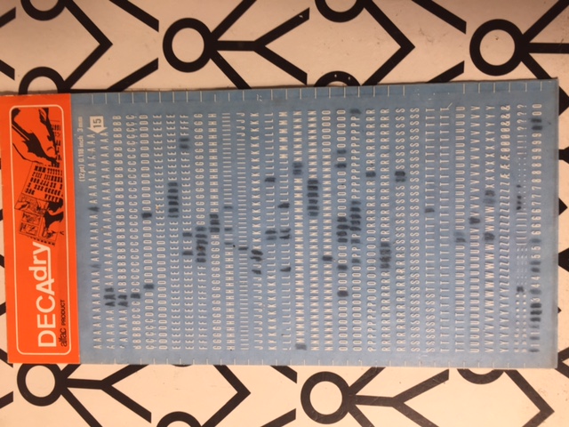

Looks nice. Are those front panel letters done by a panel maker or are hand transferable from a stencil?

They are dry transfer's... But there are some small failures. When it's all done, frontpanel will be repainted and re drylettered transfered.

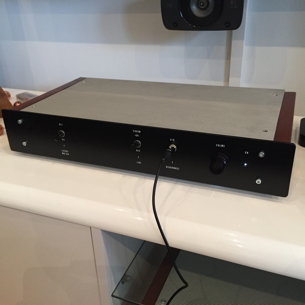

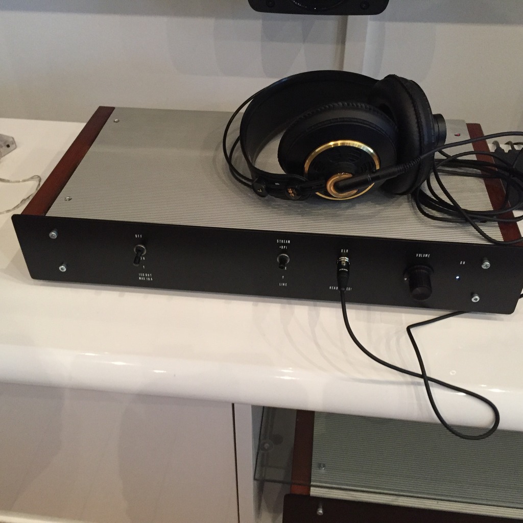

So... This is the best picture i can take with my phone.
But when i am all finish with the chassis, and everything is ready, one of my collegues will take pictures with a real pro camera, with right light and such stuff.
As you can see, there are some faults in both paint and dryletters.
This is something i cannot accept 😱
Actually it's quite normal, that i have to repaint/reletter my faceplate. I think i did not one single time success in first try 😛 ... Nevermind it's just have to be done right.
The dryletter sheet's i bought many years ago, and still my only best solution for this kindoff art.

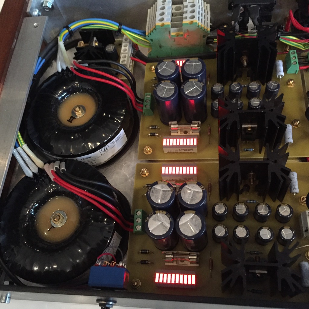

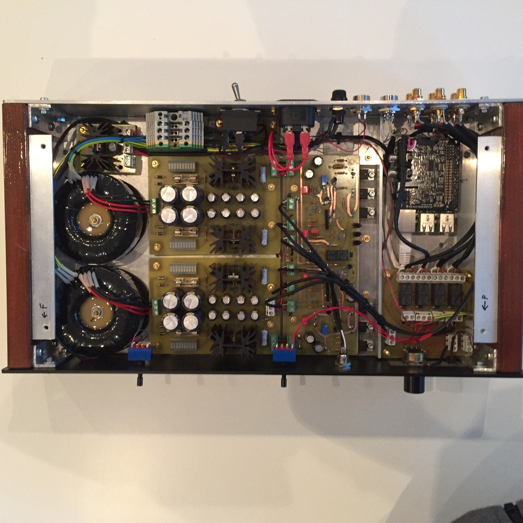

What size of chassis would you recommend?
Jim

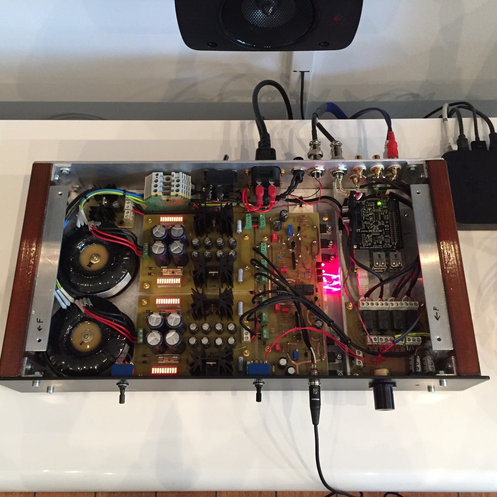

Mine has around 390mm. X 65mm. free space inside.
The chassis is 430mm. X 78mm. outside dimensions.
Besides two torrids, two psu's and one preamp. board, i have input/output selector (2 input's and 2 output's), where one of the input's is from an Raspberry pi with an DAC on top of it.
Then i have a relayswitch for feeding a IEC 230vac outlet for turning on my poweramp. Besides that, there is also some space used for headphones outlet, and switchs and so on.
Mine chassis is filled 100% 🙂
Jesper.
Jesper,
Is that chassis 430mm wide, 390mm deep (front to back) and 78mm high? And if I have that right it leaves you with a space from front to back (390mm) that is 65mm wide. So a reasonable choice might be the DIY Audio Store Pesante 2U with the optional 400mm depth. It is 430mm wide, 400mm deep and 80mm high. Are your boards similar in size to Salas's? Thanks for your help with this. I have found that while I can make my own chassis, the projects seem to take forever when I do.
Jim
Jim
Jesper,
Jim
Opss... ofcause dimensions area wide=430, depth=240, height=78 all mm.
Internal is ~390, 235 and 65 - Hole chassis is diy... and yes it's amazingly time consuming 🙂
Jesper.
Nice work! Where did you source the relay switch?
Just a plain 12vdc relay (250vac/10A)
https://www.omron.com/ecb/products/pdf/en-g5le.pdf
Jesper.

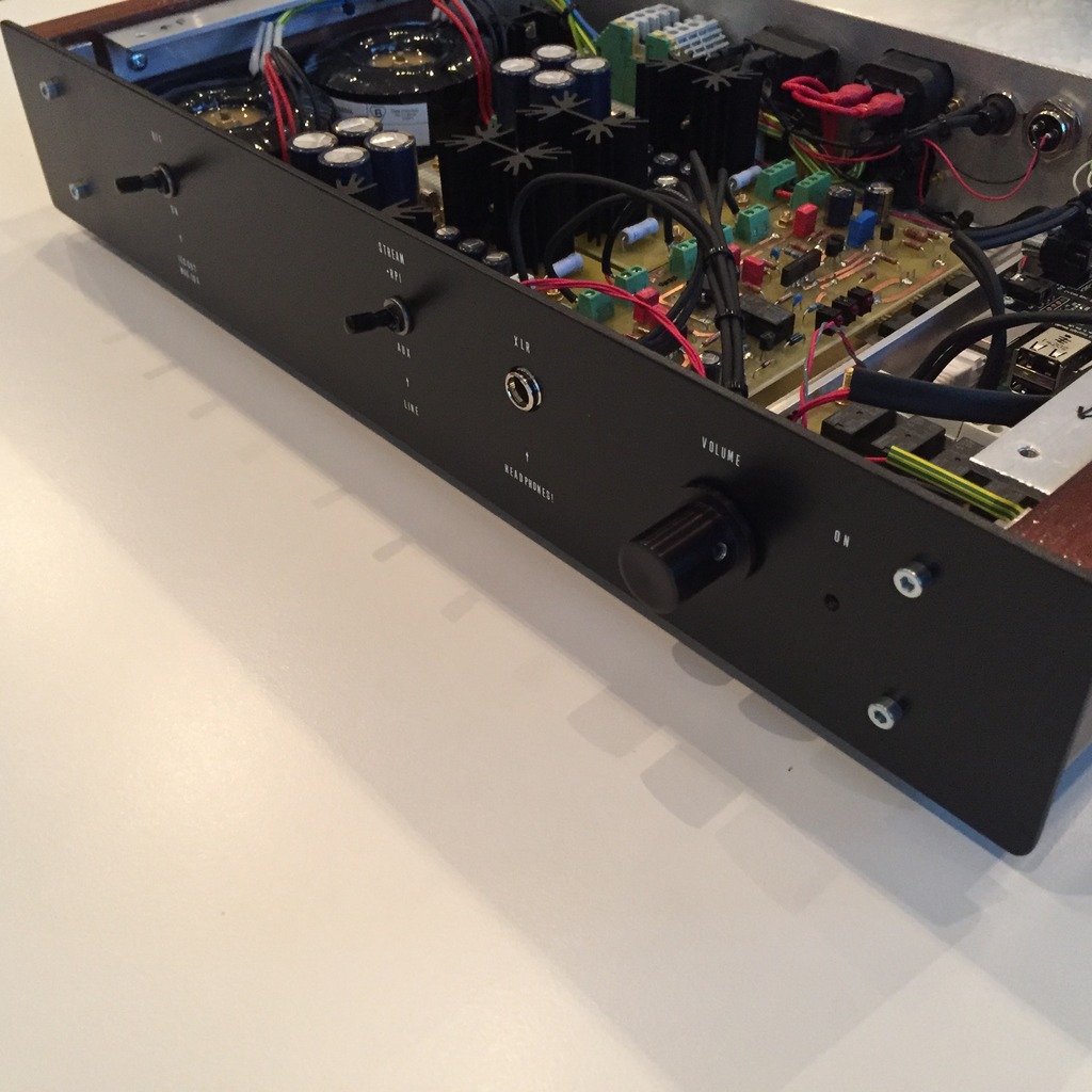

I need some inspiration for finishing my chassis.
I really would like to cut out some holes/squares for acryllic; so that the cool LED bars at the psu's could bee seen ?
Any hint's / idea's
Really this is the last thing i need to complete the build now!
I can only confirm, what i allready wrote, that this pre. is very very good, and especially the headphone outlet is surprises me the good way 🙂

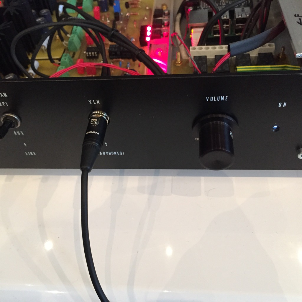

Nice build! Do you have a part number for the switches on the front panel and that grey mains connector (the device that you connected the transformer's wires)?

Acrylic hmmm... Or wire mesh area(s) better for more mysterious glow and some airflow?😉
If you don't mind taking the extra time. Your sheet of metal could have a lot of holes drilled in to make a pattern. The shape could be geometric, symbolic, an outline of some interesting creature/scene or artistic.

Hi Lykkedk,
Hey...
The small switches is from RS-Online, but thet are old, and i can't find the number on them sry... The big switch is from some wornout industrial circuit for some crane stuff (very old).
