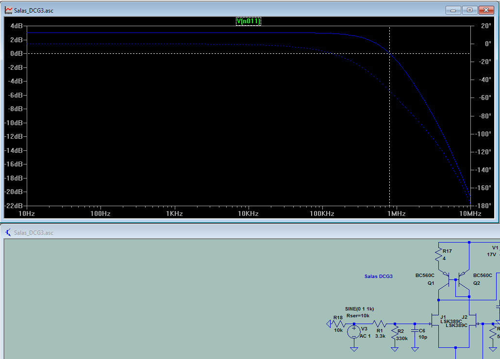

Massimo I had measured -3dB (0.707) sinewave very near to 1MHZ for 20K log pot at half signal volume position with the 3.3K 10pF filter in place. I have 40MHZ sinewave generator and 200MHZ oscilloscope which are very consistent for vertical at few MHZ frequencies. I hope I did not make some mistake but I remember I had checked a few times back when I was developing the circuit.
diyAudio Chief Moderator
Joined 2002
Just to double check. The simulator finds 800kHz with 20K pot at half and LSK389C which states 25pF Ciss so with the uPA that states 15pF the about 1MHZ test figure should have been right.

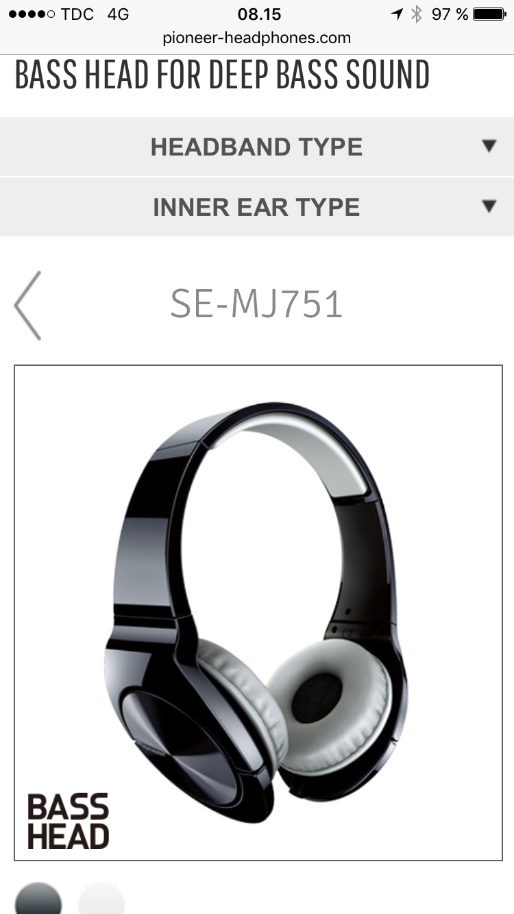

Morning...
So i was out trying to find some headphones to try out 😄
But there are not much to try around here unfortunately.
Anyway i tried some pioneer out... They where good
enough; but headphones with bassboost, is not was
i was looking for.
Jesper

When you can't find few of the known likely contenders locally for an audition, I don't know, maybe make a safe bet. Like getting a Sennheiser HD 518 or AKG K240 for open backs, both are affordable the former is fuller the latter is lighter but has interesting character. If they have to be closed back get the Audio Technica ATH-M40x. Also affordable and balanced enough.

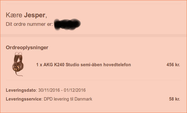

Joined 2002
As i read it, this must be considered very good.
Anyway hardware is on it's way :p
Jesper.
That means 51 Euro including shipping? Very cheap offer. Can't regret having a classic professional model for so little money. The K240 differentiate for source and amping quality. They scale up their sound enough I mean despite being cheap.
