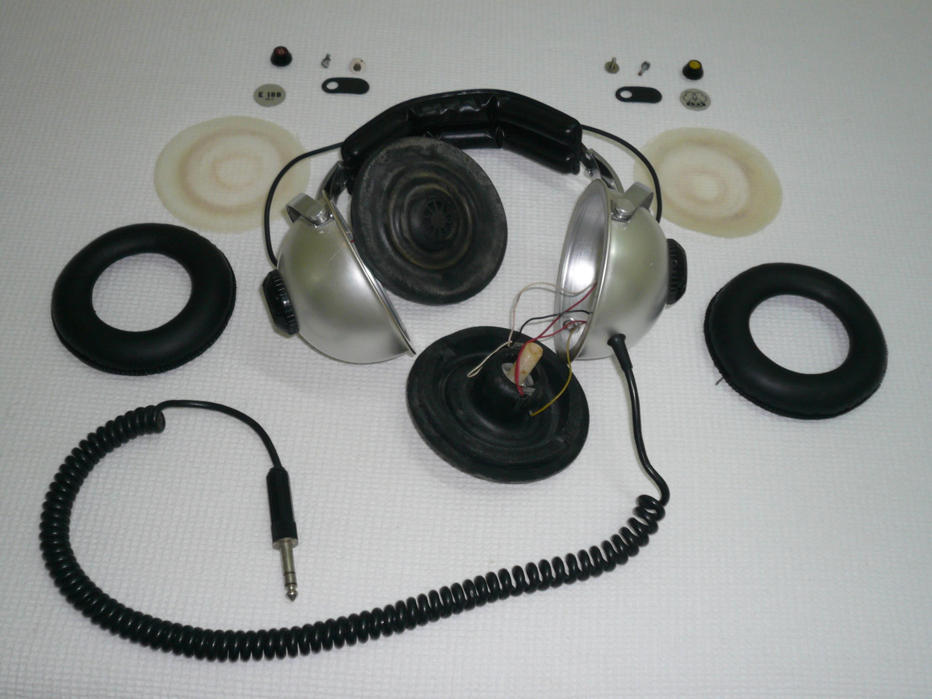

My headphones are the vintage AKG 180, 600 ohms. I got them some years ago for 50 euro. They needed restoration and since I was involved, I rewired them for balanced mode. I used a five pins XLR. Before you ask how do they sound in this configuration, I rush to say that my current balanced line stage is not enough by its own to move them adequately... DCG3 is coming to the rescue. It will be two boards - one stereo board per channel - and one DCSTB per board. Does this mean two 100VA transformers?

Two 80VA even. Two inch high DCSTB sinks will be better also. I have tested with my vintage Senn HD40 600 Ohm. Three times gain seemed enough. Those are rather low sensitivity cans. You can go four times gain if the 180s will appear quiet. Depends on the I to V stage's voltage level a lot too.

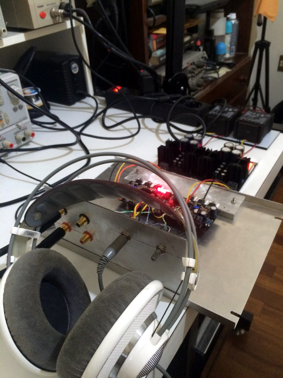

Just for testing, i tried my setup (testrig) with headphones only as Salas suggestet.
Those are not so sensitive headphones, and with volume 9/10 up, they are deadquiet; I was sitting for some time, pushing them onto my head, but no noise/hum etc... occours.
So i will wait hunting my main hifi for noise/hum (not much, but audible through) until i finish up this build with dual torrids and so on.
I write this, just if someone would like to know, that this DCG3 preamp is quiet.

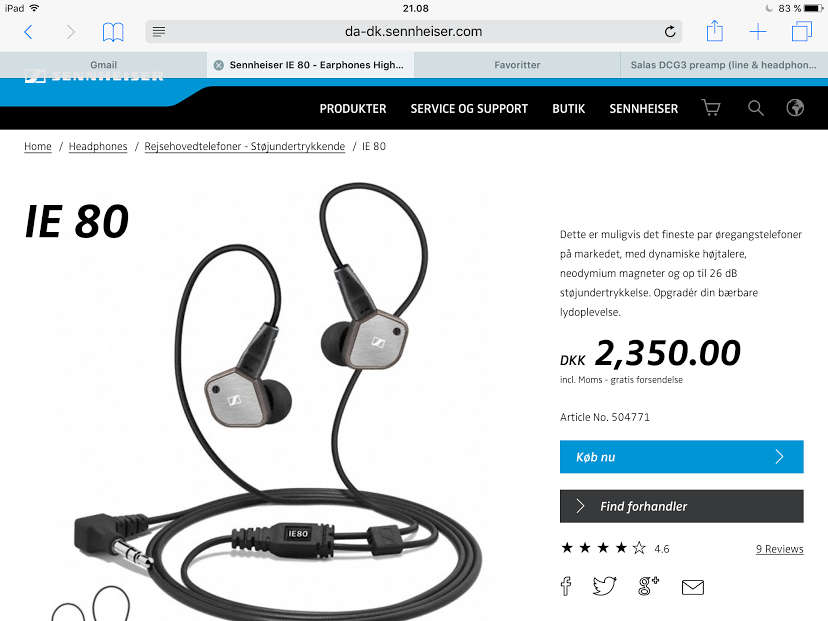

I know Senn HD25-1 II pro headphones from there which are very good closed back for DJs and for foldback mix in studios. When good isolation and no leakage are required.
Cool...

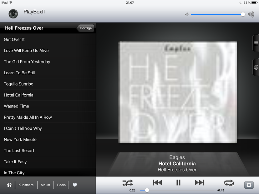

Meanwhile our big boy, yelled dad why dont whe try out mine in ear sennheiser ones!
Good idea... boy 🙂 i am listning to Eagles... Hell good sound from them.
The young fellow, also claims that this pre. sounds much better than his samsung edge phone 😛

You listened with 16 Ohm load in ear monitors by the way. Expensive model too. Those need very little voltage but are hungry for current. So they can be driven from low rail mobile battery powered devices. They supposedly don't appreciate dedicated amps as they can build volume too easily. Hey, this guy even claims its the only one model he could pick out his soundcard hiss. So if you don't hear your hiss they probably need repair 😀

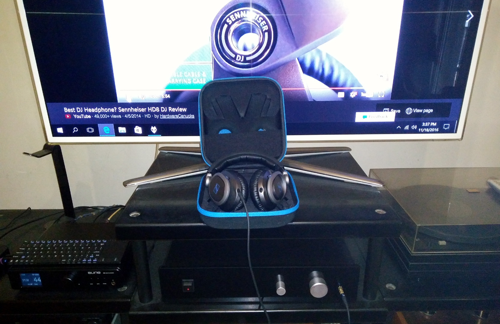

Buy sensitive headphones in general because you selected 2X gain only. In-ear monitors and DJ cans are generally sensitive. The HD25 reaches 120dB with 1V and the HD8 115dB with 1V. Could not hear hiss or hum with 3X gain at max volume even on my brother's HD8 which seemed double loud+ than my HD600 subjectively for any same volume knob position. Very good sound for a closed back and fantastic build quality by the way. https://www.youtube.com/watch?v=61p077wbz44
