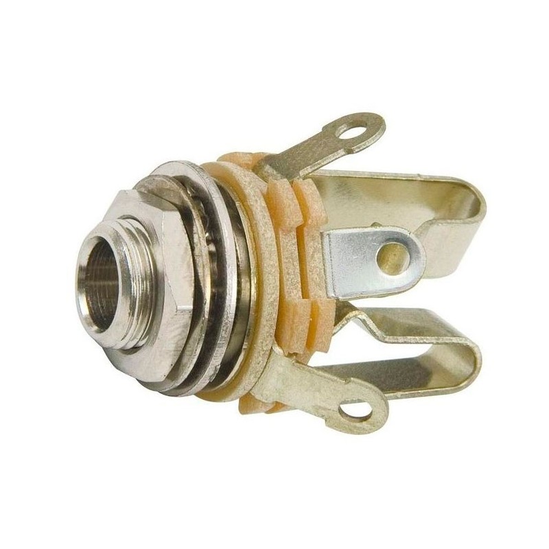

I have been trying to find a decent product, with no luck so far.
I cannot find any datasheet claiming, that no shortcircuit is present, when plugging/unplugging. -Next step is to write to neutrik, asking them directly?
Another option i consider is to use normal XLR plug's (Male+female), and just solder those types on our headset.
But i would like to keep it original through if possible.

I was digging into this jack phenomena thing.
After i did some research, and looking into severel datasheets, i took contact with Neutrik.
After a little while, someone really kind there, was replying my quistion.
This was some of the reply, which i also expected myself.
but some form of shortcircuit will always be due to the design (IEC 60603-11 and EIA RS-453) I suppose
Anyway, could it be that it's just like this, and no equipment will fail for such a shorttime shortcircuit ? -Or am i crazy 😕
I will not go offtopic here, but i think it is a good thing to know, that jack sockets really have to be selected carefully.
Jesper.
If you are really worried about it (and I am not), the solution is 4 pin XLR or something with a 1/4 adapter. Unplug the 4 Pin from the headphone amp first, then the 1/4 to 4 pin adapter from the headphones.
I have a Pass F5-based headphone amp that in theory does not like the output shorted. I usually turn the volume down all the way and make sure the source isn't playing when changing phones. But I have forgotten many times. I usually unplug and plug real quick though. No problems yet.
Yes... I will proberly use an female XLR 3pin (what i got in drawer) on pre. chassis-front. Then make adaptors for both 6.35mm and 3.5mm. male jacks.
Jesper.
With this classic type of panel jack I did not have any practical problems

headphone outputs that had a 100r in the line would be impervious to this momentary shorting.
But the fashion now seems to be to go for very much lower output impedances. I adopted 10r in my last build (it had no location on the PCB) and even that is frowned on by many Members of this Forum.
Shorting the output when Zo<<1r is a risk.

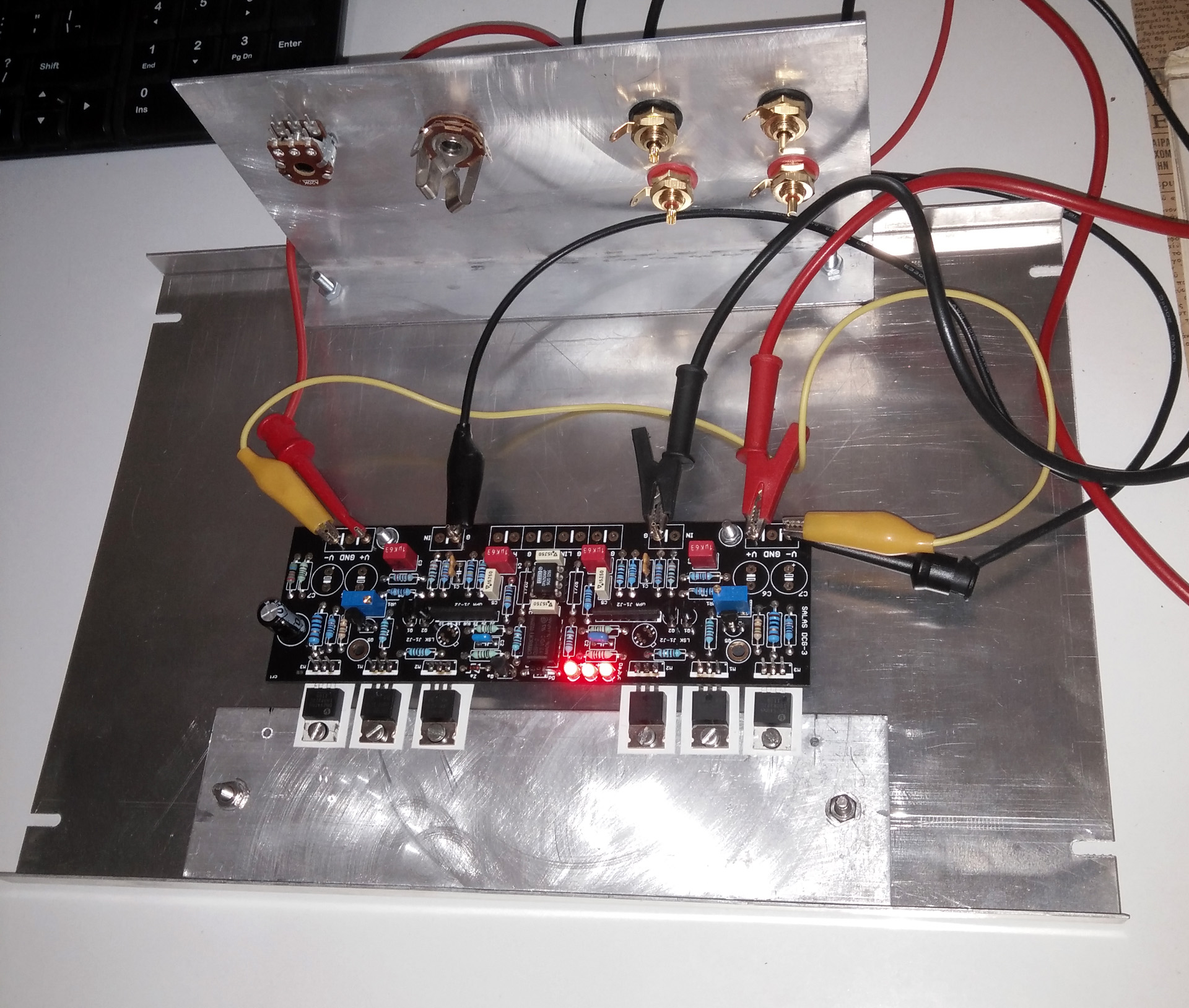

Morning all.
In post number 204 & 205, Salas was writing something about lifting and pseudo coax shield.
I do at the pot's common through the wire shields but every system is not the same for grounding as a whole. My friend had it lifted & also had the right channel's coax shield in pseudo i.e. one way connected.
I am trying different, while i am waiting for my Polish torrids, and some Alps 50K potentiometer to arrive.
I allway's had a hard time understanding howto layout a humfree preamp.
Will someone care to explain a little further, how this lifting shield (pseude shield) is done ? And perhaps some other tricks to try.
I have a little bit of slight hum still i am trying to get rid off.
Jesper.
One thing to test is if you have the same in headphones. If not so then its in the whole hi-fi system. You may get it from the big transformer field its another thing. Your PSUs share the same secondaries also. Wait to have the double mono shielded ones before you will see about final grounding IMHO. Then make it hum free on headphones as a unit first. When two signal lines refer to same ground return sometimes one channel's shield can be connected at one end only if there is a ground loop. You should mains earth your Aluminum plate anyway.

Good idea with headphones only!
Thanks for nece clear answer. / I will wait for the torrid's and then look into it.
