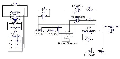

I was thinking of how i handle the connection for headphone. Do you guy's just turn off the poweramp.?
i have a Jack 6.35mm chassis connector, which opens connection between leg's on left and right side, when jack is inserted.
-Anyway i was thinking of placing a flipswitch at front, where i select between headamp. / Poweramp; when selecting headamp. the poweramp. is automatically powered down. I allways place both inlet and outlet sockets for main's on back of preamp. anyway, for the purpose of controlling the sequence. (first on / first off etc...)

I just turn off the power amp, yes.
Could this opening connection socket be used for breaking the line out wiring to RCAs as an idea?
Salas.

Morning.
Il'l proberly go crazy about it, and create a hole circuit for this to be automatic 🙂
I think, family will forget unplugging headphones otherwise.
-Anyway i got one of those nice red NEC relays for this.
-Had to do something, while waiting for my transformers 😛
Jesper.

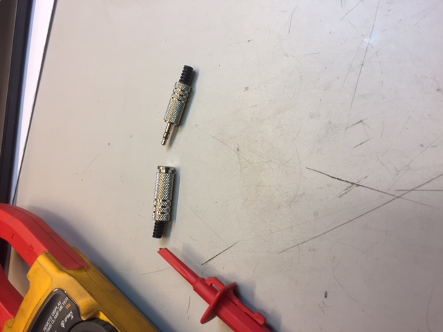

Hi.
I tried some small 3.5 jacks + female, here at job.
They also momentary for a splitsecond make shorts between L/R - Gnd 🙂
Only happens, when inserting and unplugging.
Strange... Maybee they all do ??
Jesper.
shorting depends on the shape of the contact in the socket and on the depth/width of the depression between the conductors of the plug.
If the hard plastic (non conductor) between the conductors was made at the same diameter as the ¼" conductors, then a narrow curved contact inside the socket would not short across the plastic insulators.
There's a whole world of various 'plug & sockets'- 4 and 5 pin miniature plugs avoid all this potential shorting of the amp plus offer the possible advantage of the 4 wire connection - replacing the typical 1/4" jack plug is pretty straightforward and doesn't need to be the large 'clunky' cannon plug style - the Swisstac (?) 4 pin isn't so common but the 5 pin version is used as a video connector and readily available - many companies make these ...
