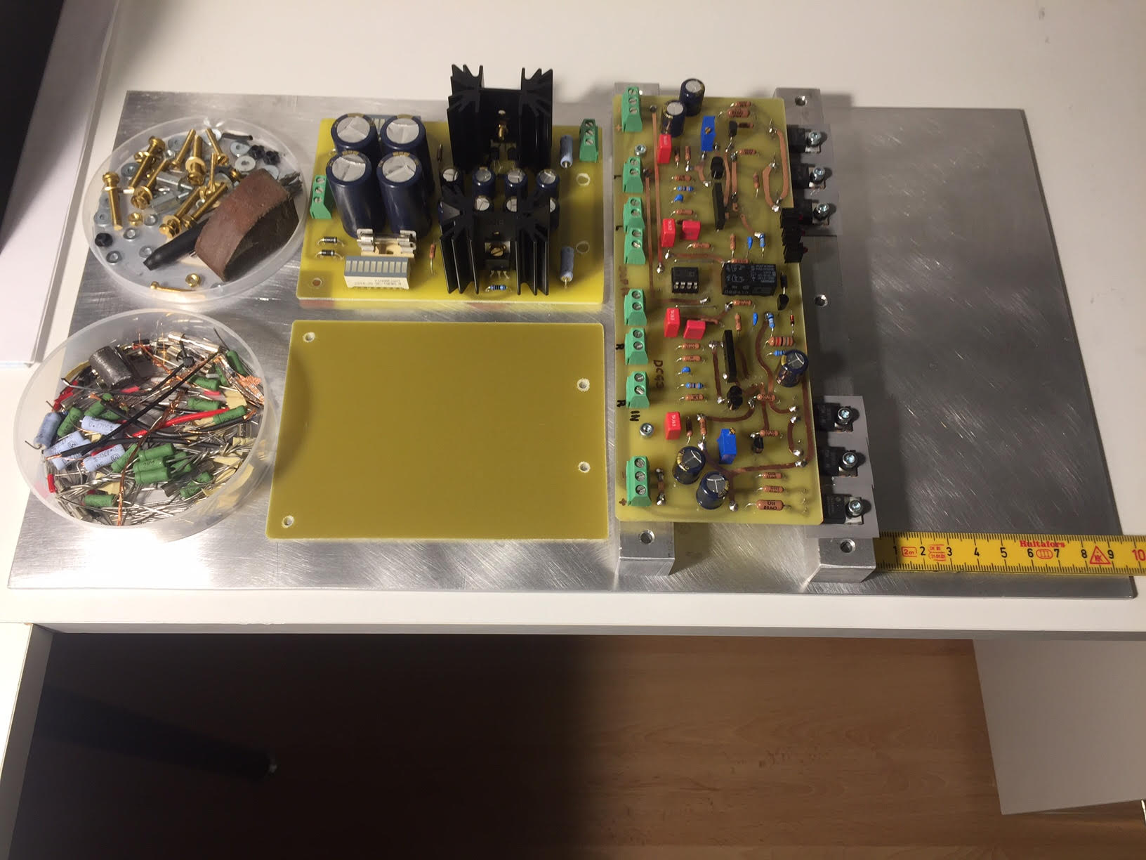

Layout on chassis
I am trying to squeeze the parts on to my bottomplate preamp chassis.
I have put some plastic cups, for showing how much the torrids will take space.
Will it be okay to place the potentiometer / input selector etc. right next to mosfets.
I can ofcause bolt a 3mm. alu' plate vertical to the alu' bar, for making some kind of shield.

No problem having the pot near the Mosfets if their temperature will not be scorching. Which it will not be with all that metal. Measure the temp on the Alu-bar.

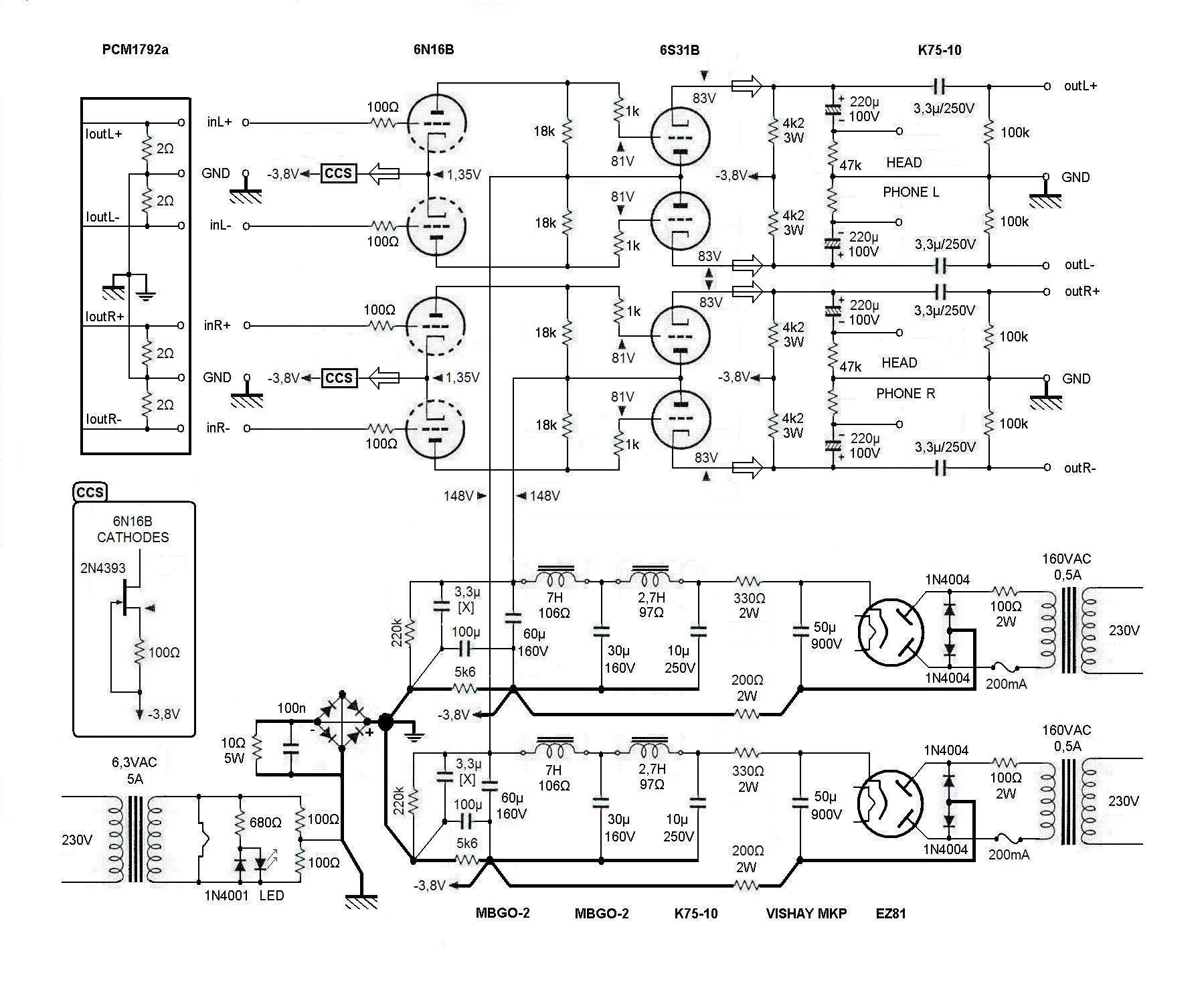

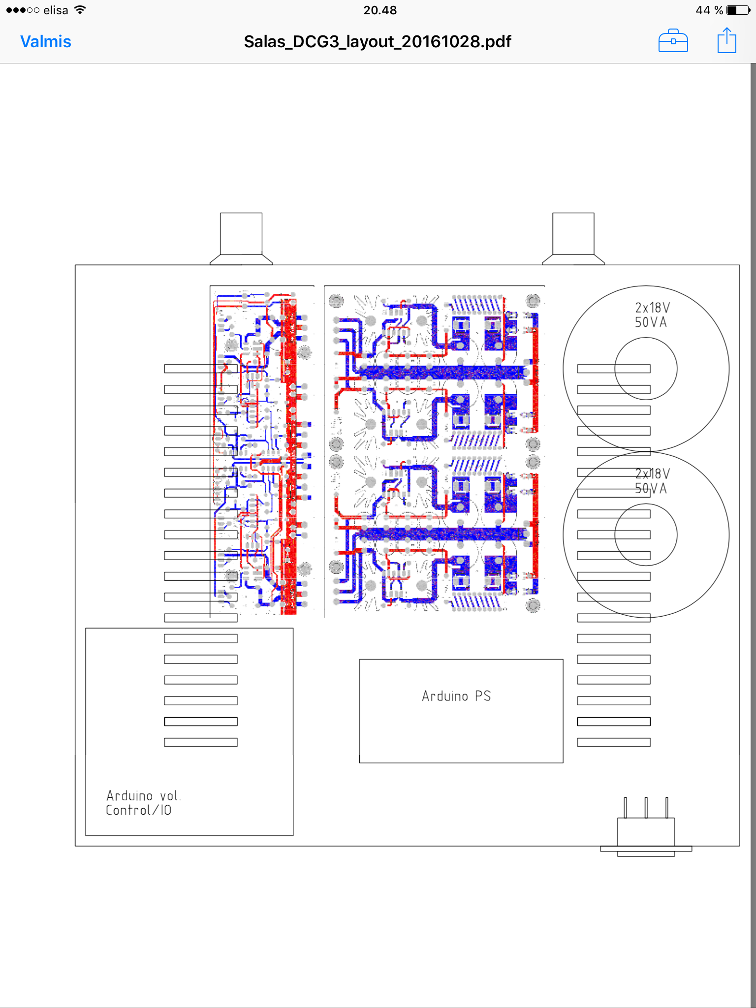

While waiting, here's something I would like to ask;
Line stage for me actually means DAC output stage... I use a current output chip
with a single resistor for I/V conversion. Then the signal is fed directly to tube's grid
without coupling capasitor, pot and grid leak resistor. This means DC offset at the
preamp input. Currently, because of tube's high gain, the I/V resistor is 2 ohms
resulting at 11 mV DC. The resistor can be increaced up to 100 ohms to compensate
for lower preamp gain, but I wouldn't like to go over 56 ohms > 290mV. Should I treat
DCG3 the same way - remove pot, R1, R2, C1?

You can only remove the pot when using the DCG3 on max gain for some other purpose than a system control line preamp. Do not remove anything else because it will oscillate. It's servo mechanism also has the capacity to correct against some input signal DC offset as an aside.
OK, I understand the purpose of the input RC circuit but would my I/V conversion scheme work on this or should I use a coupling capasitor?
So your chip pushes AC signal current through a 2 Ohm to ground and makes an AC voltage across it. That's a textbook voltage source of two Ohm impedance. There is no problem driving various line stage. You can use a coupling capacitor to block its inherent offset but if without it DCG3 can tolerate enough mV because its DC servo will react. Was it 600mV or less I can't remember exactly what was the limit before going nuts as I was pushing it with the bench generator's offset function when I was developing it. Anyway try and see if it can accommodate your source's offset.
