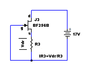

DCG3 R3 value
The now BF256B (J3) batch in Tea's hands is too strong for 4-5mA correct Id in circuit when R3=150R. Expect to find 220R R3 in his parts set.
Who have own J3s check they give 4-5mA with 150R using the following test circuit. If not any of them do, change your R3 value accordingly.
