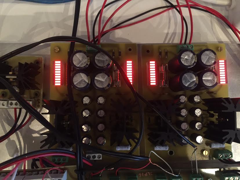

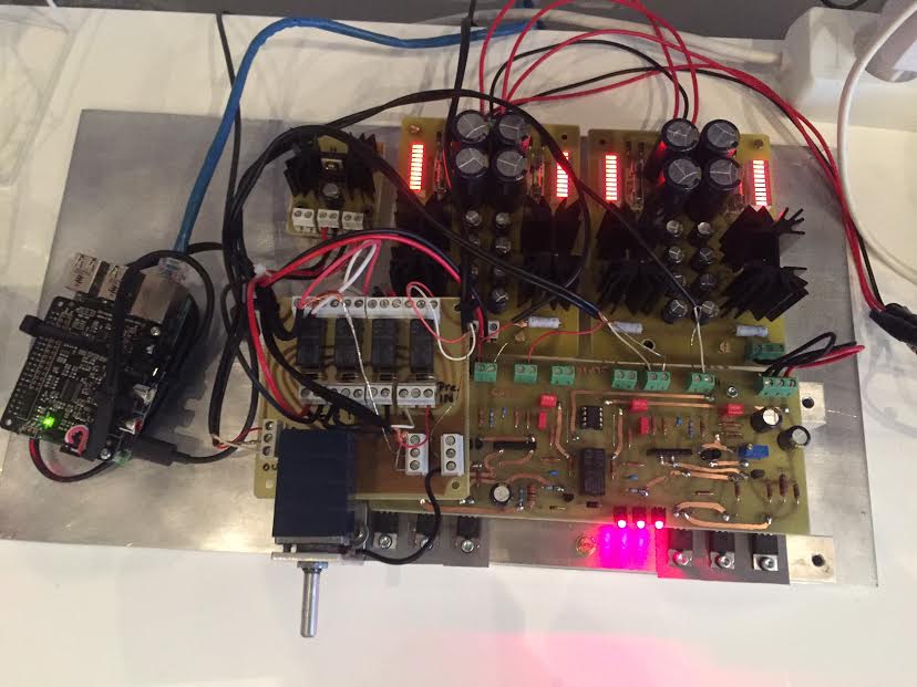

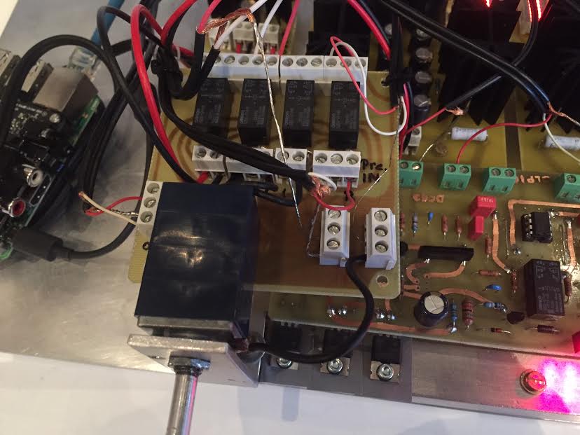

TESTrig complete
🙂 Good evening all!
First off... Sry. for my "school" English!
So finally, i had good time to really listen to this brave pre. made by Salas.
Story is, i decided long ago (or my wife actually did 😛), that we needed a headamp. Thing is, she really likes listening really loud in her headphones.. but normally she uses her pc, which cannot play them very loud 😱
My Pre. right now is a B1 buffer unity gain, and to be honest i also think i need a little gain for driving my F5's (right now taken apart through)... So Salas presented a new construction with buildin headamp. -I took the challange and designed my own pcbs (looking at Salas design). Everybody here was kind enough to chime in and help! thanks all for that.
Yesterday Friday, i had a day off, after we was at concert Thursday evening (more about that later) I soldered my second DCSTB, for trying dual psu.
-Also i have recieved my pidac, so everything was ready to hook up now.
Whoow... man, this thing really rocks... channel seperation is in particular good, but soundstage also rock's (by soundstage i mean the area behind and in front of speaker's)... Right now we are listning to a new, very good upcomming Danish band. (See link below)... It was also that band, we saw Thursday evening... really good live. -That voice of this young fellow, is as good live, as it is on recordings, not something you hear every year i think.
I wish you all a good Saturday evening!
Best Regards; Jesper.
Attached some pictures of my testrig, happy wife etc...
