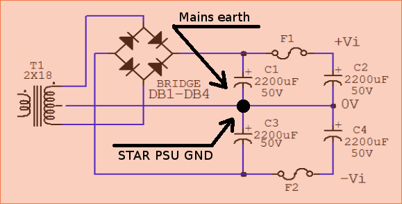

I am trying to draw the layout, which i will try regarding grounding.
(I know it can differ between builds)
Will it be a good idea to keep power and signal grounds separated ?
-See picture.
Normally i use twisted-pair's for interconnection, but the buildguide suggest the possible use of shielded cable. By shielded cable, you mean 2 wires + screen cables?
So if decided to try out shielded cables, then shield have to be connected only at "incomming/source" end (Otherwise they act as antenna). By that i mean if using stargrounding that shield have to be unconnected/open at starground point?

Mains earth goes to a chassis secure screw with a short cable from the IEC receptacle.
Use single core coaxial shielded cable one for each channel. Between switch or pot and pcb also.
Connect each shield both ways.
Avoid the reservoir capacitors common for referencing signal. Its a power ripple contaminated spot.
Try just a wire from the pcb ground strip to chassis. Lift it with 100 Ohm if its noisy. Bypass the R with 0.1uF.

I agree with Salas.
Do not take the Mains PE wire to the transformer Centre Tap..
Do not take the Main Audio Ground to the transformer Centre Tap.
The Mains PE goes to Chassis at the mains input location.
The Main Audio Ground is connected to the PCB Power Ground.
That PCB Power Ground is fed from PSU Zero Volt, shown as 0V on your diagram.
If you have any exposed conductive parts, these should be connected to the protected Chassis. You can use the Transformer Centre Tap as your Safety connection to Chassis. This can be a direct wire link for a Mono-block build, or via Disconnecting Network for any multi-channel build.

Earth the Alu-plate to PE and reference it to the 0V pcb strip meantime.
For grounding good readings Andrew is more learned than me to recommend.
