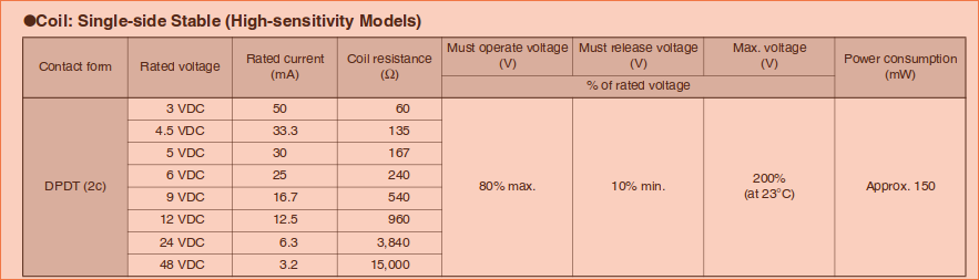

As a followup on my relay adventure, i just wanna tell that i recieved the last of my parts yesterday, along with some 150mW omron relay's.
So after plugging such one in, the voltage stays on 12vdc on the coil (11.46vdc excatly)
Lesson learned :)
Jesper.
btw. : Thoose relays also claims to be gold clad contactors!

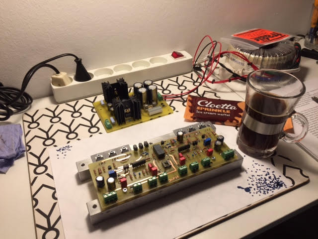

Good late evening here :)
This is the most thrilling part of diy; nearly finish the "raw" build, ready(allmost) for testing dc-offset, and to see if anything blows up !
I did my own amateur layout, copycatted most of Salas pcb, and keept in mind that i had to do it myself, so pcb traces and layout could not be so tight.
I checked and checked and tripple checked that the schematic i had drawn in diptrace was correct, and after the pcb layout, i also checked x 4 or more for errors... But i never can know for sure if it will work... just need a little more work before going into test-mode.
It's nice to do the pcb part i think, but then again i am old fashion :)
All parts are matched up, bias decided to around 100mA - DN2540 two perfect match at 1.010 (~101mA)
BC560 matched, PF5102 matched etc... phyywww...
please :xfingers: for me...
Now its time for chocolate and coffe for the nerves...
