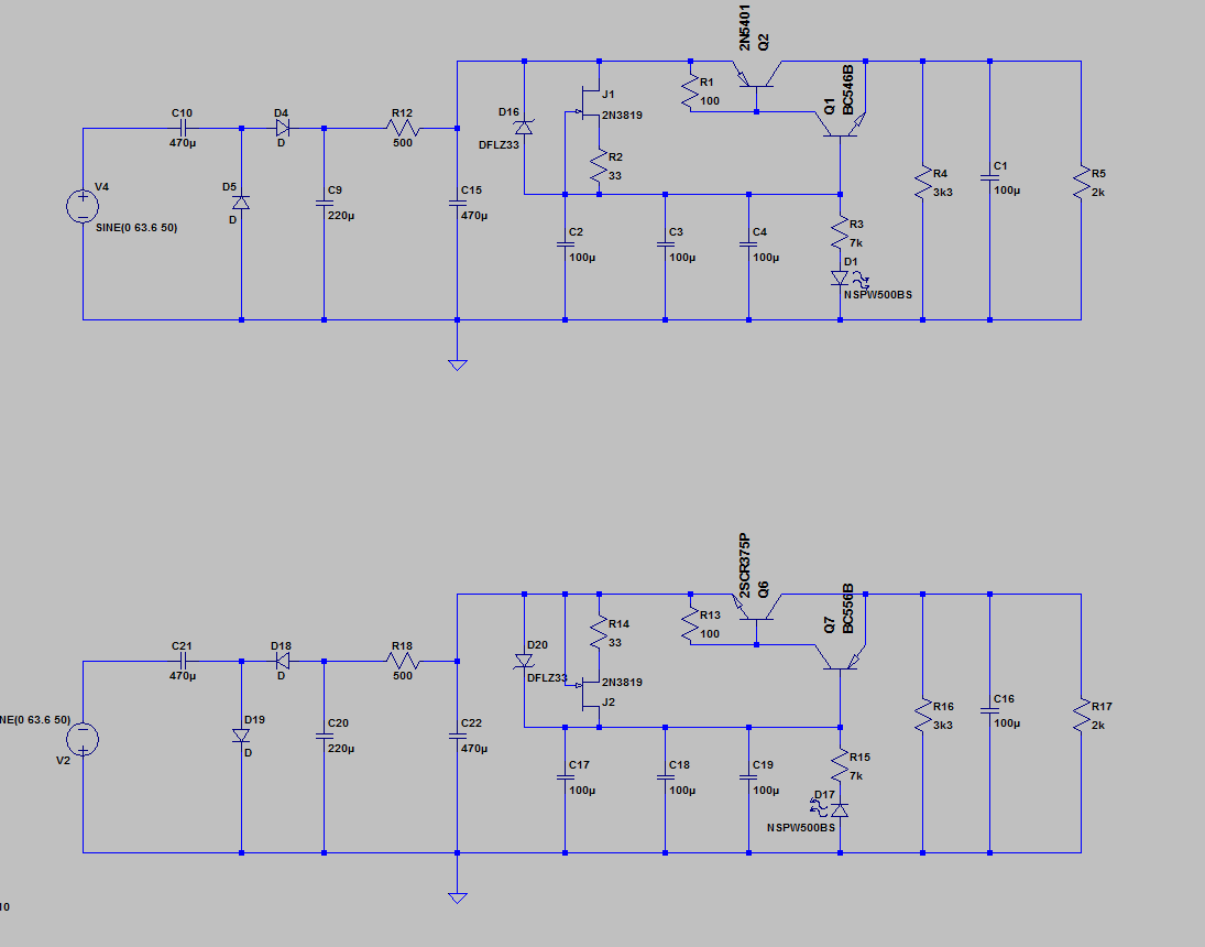

Hi Salas
Please excuse my off topic but I am designing a new power amp that needs a regulated psu for the IPS and VAS.... after simulating with your V12R I decided to keep it simple and went for your new series reg.
At the input of the reg I have 80Vdc and it should provide stable 69Vdc for the amp.
I added protection zeners for inrush but do not know if it can work with the stock transistors you use here.
The works are here: http://www.diyaudio.com/forums/soli...r-amplifier-assemblage-vii-3.html#post4871522 so if you care to comment here or there 🙂
  • Assemblage Series reg EVO2.asc
The stock pass transistors are high gain bandwidth product parts good for 1.5A current before they will have some HFE drop. Find their spice models from ON and simulate. This is not a regulator its a voltage referenced Sziklai pair multiplier. Good for where there is some PSRR and relatively high bias. Has smooth & extended low Zo for a multi, its not reactive or noisy. With the Norton Vref you use (R3, R15) it won't be as fixed as with Leds but you would be needing far too many for 70V and the resistors are better than Zeners (in noise not in voltage fix). J1 J2 Idss and their drift will directly change the resistors voltage so it will take you some preparation of matching and trimming. R2 R14 trimming will help in that also. See not to use JFETs with more Vgs (off) than half Vdif=Vin-Vout. Use Vdif of at least 5V. Your sim's transient reminds what I measured in DCSTB for power on output voltage curve but I can't make other things out of your file. I put you parameters in other sims and I see it follows for Zo curve etc. But you will see how it goes in spice as a total result in the concept of your amp. In general such rail cleaning solutions are cooperating well with power amp driver stages. What school is it based on by the way? Reminds me of Goldmundish topology, but I am not sure, just had a fast look.

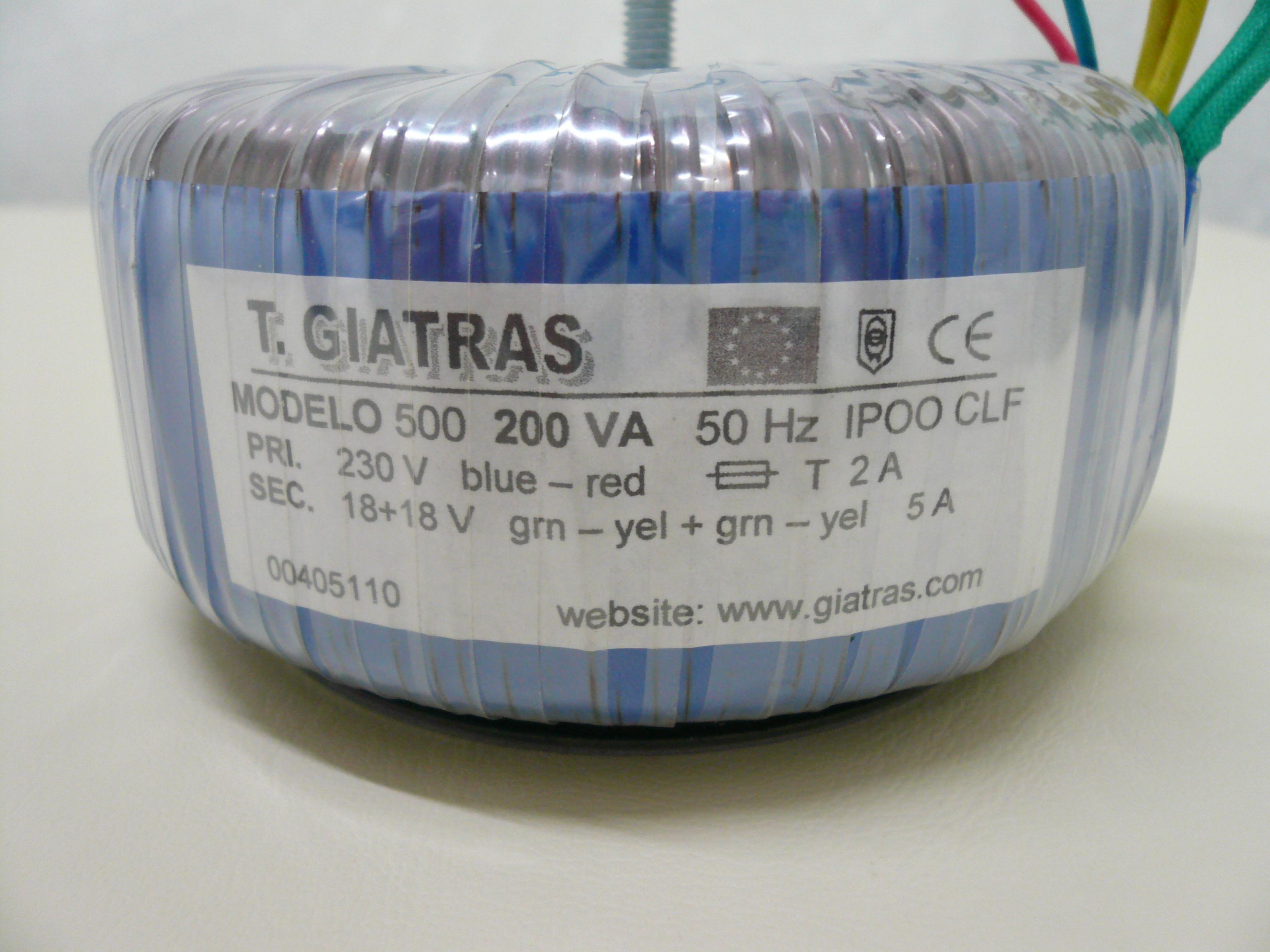

I found this transformer forgotten on a shelf. I was wondering if it could be used to supply both channels. It's of very good construction and well oversized but I wouldn't like to use it just because I have it in case two separate transformers is a better option...
For single shared supply between channels that transformer is gutsy and nice though overkill. Prefer smaller and magnetically shielded ones for best noise floor when in the same box with the audio circuits.
