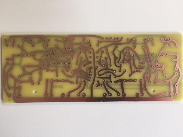

Evening all here.
Eventhrough i could just wait for the very nice DCG-3 pcb's to be ready in the group buy, i could not resist trying to make my own amateur one's :eek:
Well it aren't nearly done yet... but i sort of got started now...
This, if succes will be near the limit of what i can do by hand i think! So really exited how it would come out in the end?
Attached picture of raw pcb, top_layer.
Rgds; Jesper.
diyAudio Chief Moderator
Joined 2002
Its a nice learning experience. Good luck. Only remember after pcb assembly to do checks with the DMM in continuity mode (beep!) so to verify all parts will have right circuit connections, no shorts to GND, etc. before finally attempting to power up.

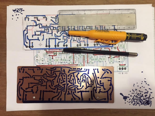

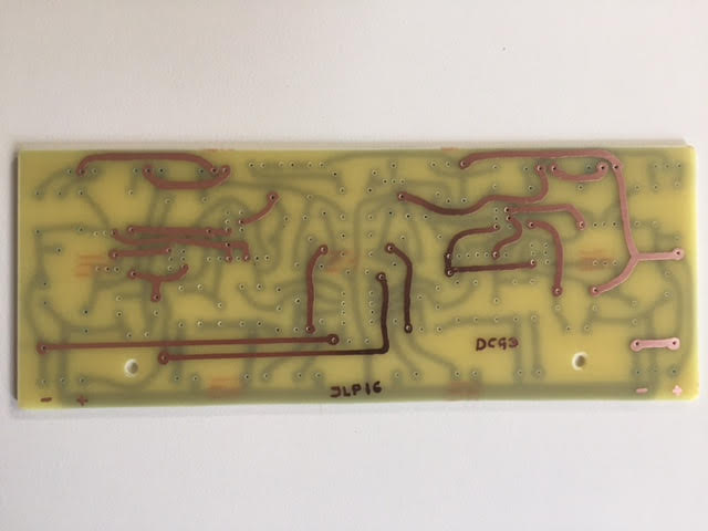

Thanks Salas....
So finally i am done with pcb.
Sry... Salas, there was a typo on the pcb (jlp16) :D ... Otherwise all vent well drawing/etching it up.
Took around 7-8 hrs. including time for cutting and drilling all holes.
-Hey but i like it!
Next step is to "beep" it all out, after soldering the top/bottom layer spot's
Rgds; Jesper.

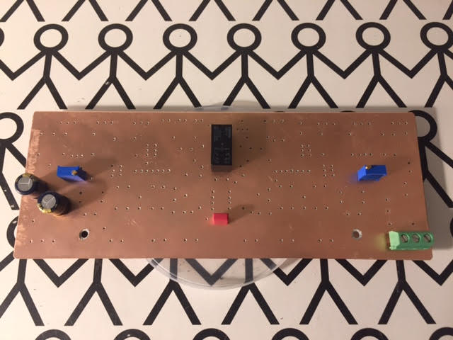

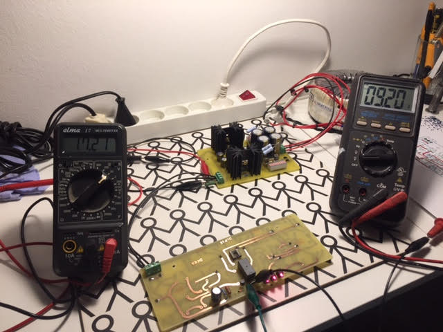

Evening here :)
So something is working.
I soldered in the relay circuit, and when giving the DCG3 pcb GND(0) and 17.23vdc, the leds, and the relay goes on after ~4 sec.
I tried to meassure the voltage on the coil, and when powering up, at the moment the relay engages there is, in a blink of an eye 25vdc, and then it goes down to ~9.20vdc.
My Ra resistor is 68K, Rb is 15K, Ca is 100uF, and red led's are 20mA/1.6v.
The relay is Omron G5V-2 330ohm coil, and the NEC from the BOM is ~1000ohm coil.
The resistance is 0 ohm between contacts when engaged, and the click sounds "right"...
Are there any considerations about the coil resistance/transistor etc...
Regards; Jesper.

Evening here :)
Regards; Jesper.
Why you use a 5V relay when the spec in the BOM is 12V relay? It will wear out at almost 100% more coil voltage than nominal. See if when replacing one LED with 560R (put it standing upright) will still work. (You may need lower voltage Zener).
Hi Salas.
The G5v-2 is the type... The coil is 12vdc...
No problem. I was just asking, about the transistor and the circuit, nothing Else.
I see That the 9,1v zener is proberly why voltage goes down 9.2vdc...
Just being curius here 😄
Joined 2002
It looks like it pulls more current than the NEC though. So it probably drops much in the LEDS. Its no problem to trigger, the relays have a wide enough range below and above nominal.
Measure Leds Vdrop and feel heat on Leds relay and Qa. We don't want the Leds or Qa to burn out early in use.
P.S. Is this the one? http://eu.mouser.com/ProductDetail/Omron-Electronics/G5V-2-DC12/?qs=lK7M36XCk6JxdWY/V6sVqw==
If yes you put a 0.5W relay in place of a 0.14W relay. 42mA pull vs 12mA pull. Good luck Leds & Qa.
