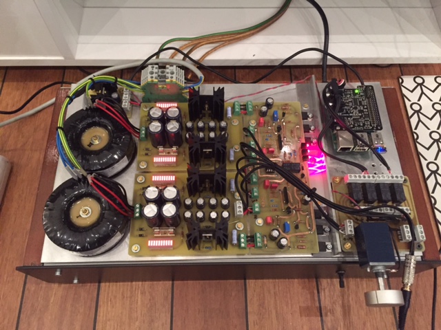

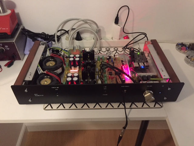

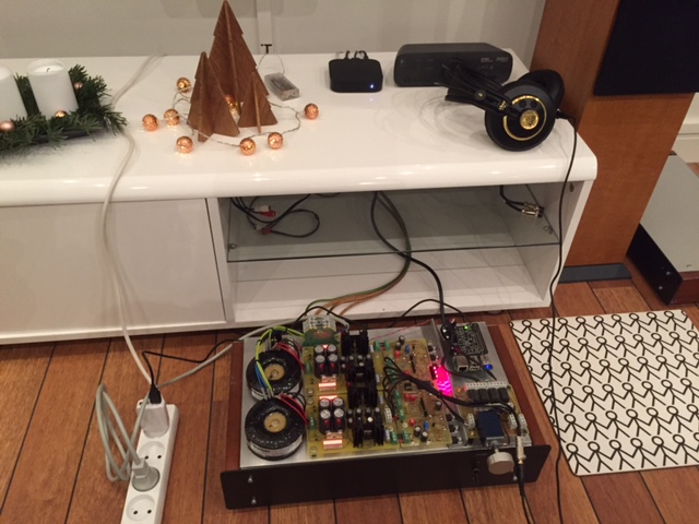

Mambo double Polish donuts, classA big sound this evening folk's
So...
Thread is waiting for people recieving theyr'e pcb and part's i guess 😱
Meanwhile mine is cooking on hifi...
15-20min. for best sound IMHO, then everything is around 30-35C. hot.
AKG's headphone are addicting, why do i keep my speaker's 😉... Well they sound marvelous too on this combo.
This little big classA preamp. is having only few hours on it, and allready sounding very very good.
Nothing more, just wanna showoff 😀
Jesper.

Hardcore DIY boards, great pictures, and a nice forerunner adventure for the industrial boards builders to have seen. Congratulations for your work. You even confirm the pdf guide words "Due to class A operation its not being a cold idling circuit so some warm up time is recommended before critical listening". Nice that you like the AKG K240 recommendation also. Difficult for me to try suggest solutions as subjective as choosing transducers and not disappoint. Do you hear some positive differences now that you run it on proper double mono Tx execution?
Thank you for the very kind word's Salas... It makes me proud 🙂
If we start with the cold/warm circuit, as can be seen on older pictures, i removed some Alu' bars for circuit to be a little hotter :hot: ... I allway's like a little heat/cooking when running such amp's! Donno if it make's any different to sound, but i like the idea of warmth sounding parts. -And this is excatly what this circuit does; make music warm, well IMHO. I also noticed some recording i allway's hear when judging amps, such as Road to hell part 1+2, Eagles, ZZ-top and some George Michael along with Maria Careys all i want for xmas is you :xmastree: (Happy 1. Dec btw.) this amp. are not producing sibilance... this is proberly one of the most perfect things with this amp. i think.
Listning to your'e pre. with two torrid's are also great, but it's a little hard to tell excatly how much difference it does compared to my old 650VA unshielded torrid (This torrid is not for such circuit's)... Most noise are gone now, and the rest remaining is from poweramp (LM4780). When listning i can really tell that stereo perspective is very very very good.. Lot's of details flowing around the livingroom.. I love it!
Speaking of detail's. The first word from my wife, when she tried the AKG's was... they are very deep ... What do you mean i asked 😕 ... there are so many detail's was her answer! 😛
Soo next step is take it all apart and build into my old chassis... See ya'
And again thanks to all for helping me through this build...
Jesper.
