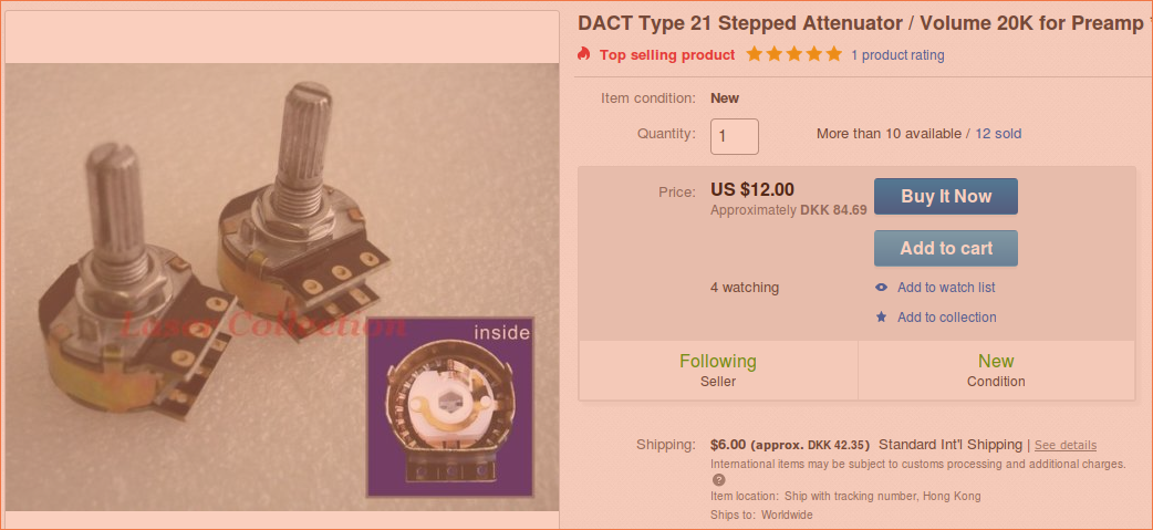

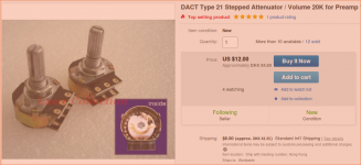

By the way what value pot you now use? Looks like an Alpha pot size or something alike.
Hi Salas, and thanks for fixing my pictures!
I use a pot like this, i bought some years ago DACT Type 21 Stepped Attenuator / Volume 20K for Preamp ** Hi Fi Grade ** | eBay

I had used such pots a couple of times. For channel balance they are excellent of course and the sound is good enough. The thing that reflects their affordable price is their not too great service life. But fair enough.
