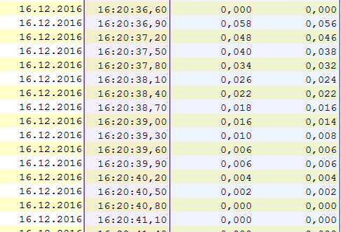

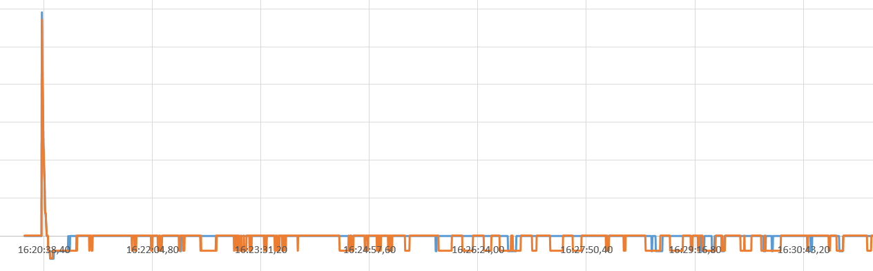

so, here is some meassurements.
First DCoffset... please look at secund and third picture. As can be seen level is very low, even at startup. Around 4 seconds for stable DCoffset.

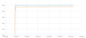

Bias level is checked last, very stable as can seen (Stuborn mule grade bias) as Salas would have called it.
My bias is a bit deviated as can be seen, this is i think because the right channel DCSTB is having a slight deviation (LOW through) between + and -)
Nothing audible !
Nothing audible !

Excellent stability from when it was in the open and fresh and now boxed and run in and hot enough without any new trimming. The bias level has only to do with each DN2540 and not the exact rail voltages by the way. Maybe just the ambient temperature made any difference.

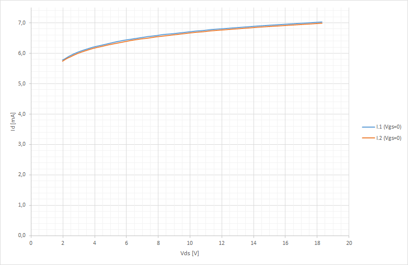

Though I'm awaiting for my full sets of DGG3 and dual DCSTB's from Tea-Bag, I ordered 5 pieces of uPA68H JFETs from an eBay seller. Just in case I manage to destroy some during build up. I measured them and here's the results. Quite good according to my humble cheap DMM, dont't you think? These JFETs are of the slim type what Salas has posted earlier in this thread. This is just a measurement of one of the individual JFET's both channels (I.1 = channel 1, I.2 = channel 2). My voltage source is only valid from 2,55...19 V. I had 100R resistor in series from voltage source + to JFET's drain and gate-source were connected to voltage source minus.
Its a very well behaved low noise enough and high gain enough monolithic good for many audio jobs that curiously nobody used in diy before DCG3 as far as I know

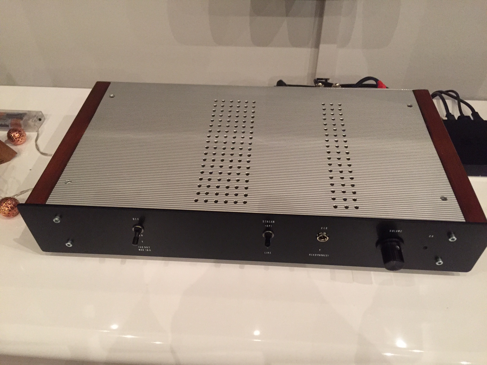

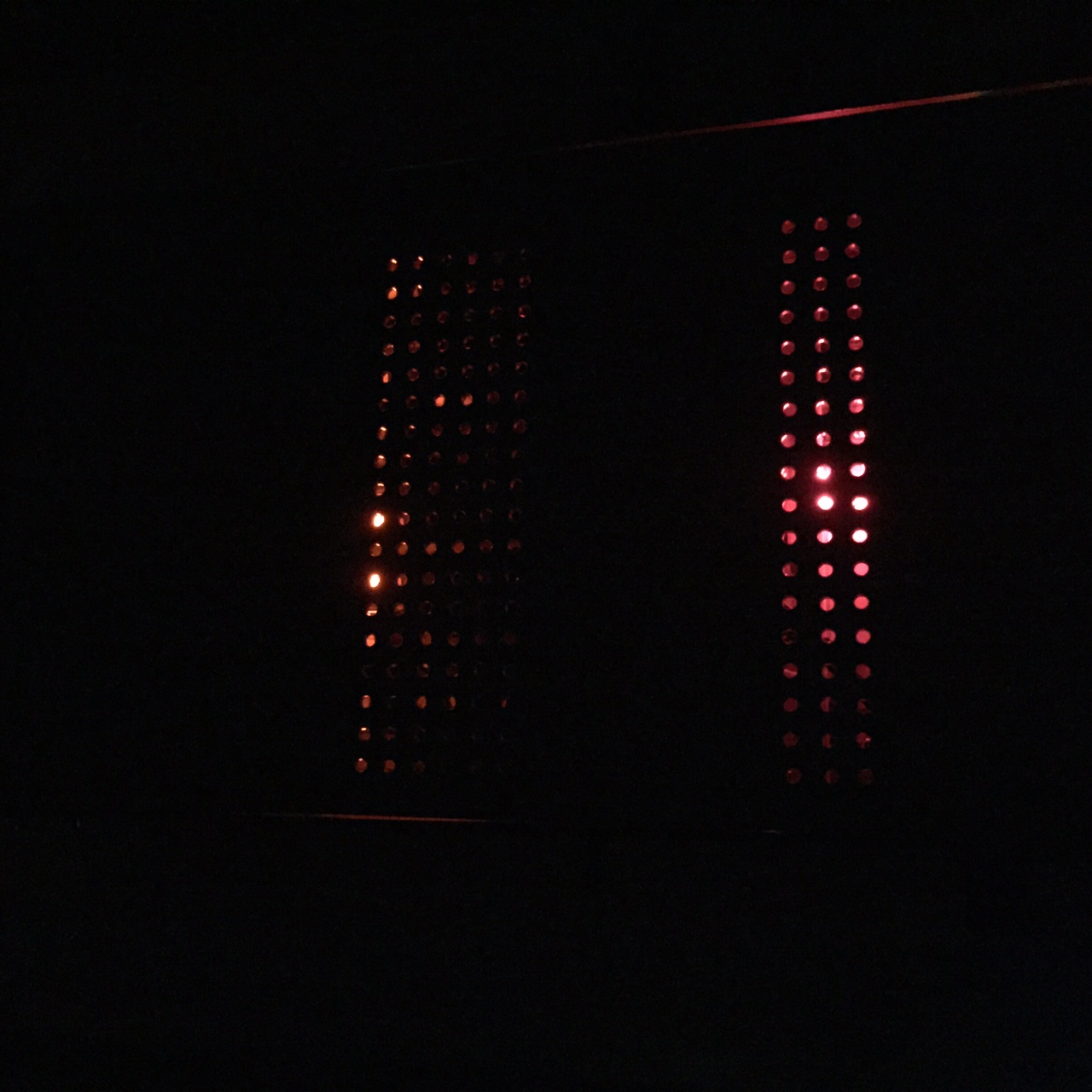

Have you decided the final breathing windows plan or breathing holes pattern artistry on the top?
all very consistent.
P.S.
You can make many things with the surplus units like a decent CCSed two FET DC coupled buffer out of each one without matching need for instance. Like they put many local ones in FET active crossovers etc. Or you need to buffer a pot from a BJT input stage base current not to scratch etc.
Yes.
I did just plain classic. -But it's working as supposed.
Real burning amp.
Looks like, it's very steady regarding temperature also. After 1 maybee 2 hours the temperature stays the same.

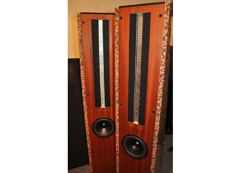

Btw. I forgot to tell, that this particular fellow i will visit, got a pair of those speakers, which is made by a now closed oneman company. He also got a very expensive power amp. (commercial) Dont know which model http://www.perreaux.com/; I am looking forward to try it on his hifi.

The three leds create a better spread of the escaping glow after all. Very nice aesthetically. By some weird coincidence this preamp tends to seek for big planar speaker systems in many of its early listeners systems given that such speakers are a relative minority.

Sadly true. Thank you for spotting this little gemIts a very well behaved low noise enough and high gain enough monolithic good for many audio jobs that curiously nobody used in diy before DCG3 as far as I know
Yes, why not? 😉P.S.

I mean three early users listen with such big planar technology speakers already (Eminent Technology, Infinity, Apogee) and now your friend's system has alike. So I say what a coincidence among the few early DCG3 adopters circle to be so many big planar dipoles that are not so common to meet in most home hi-fi installations.

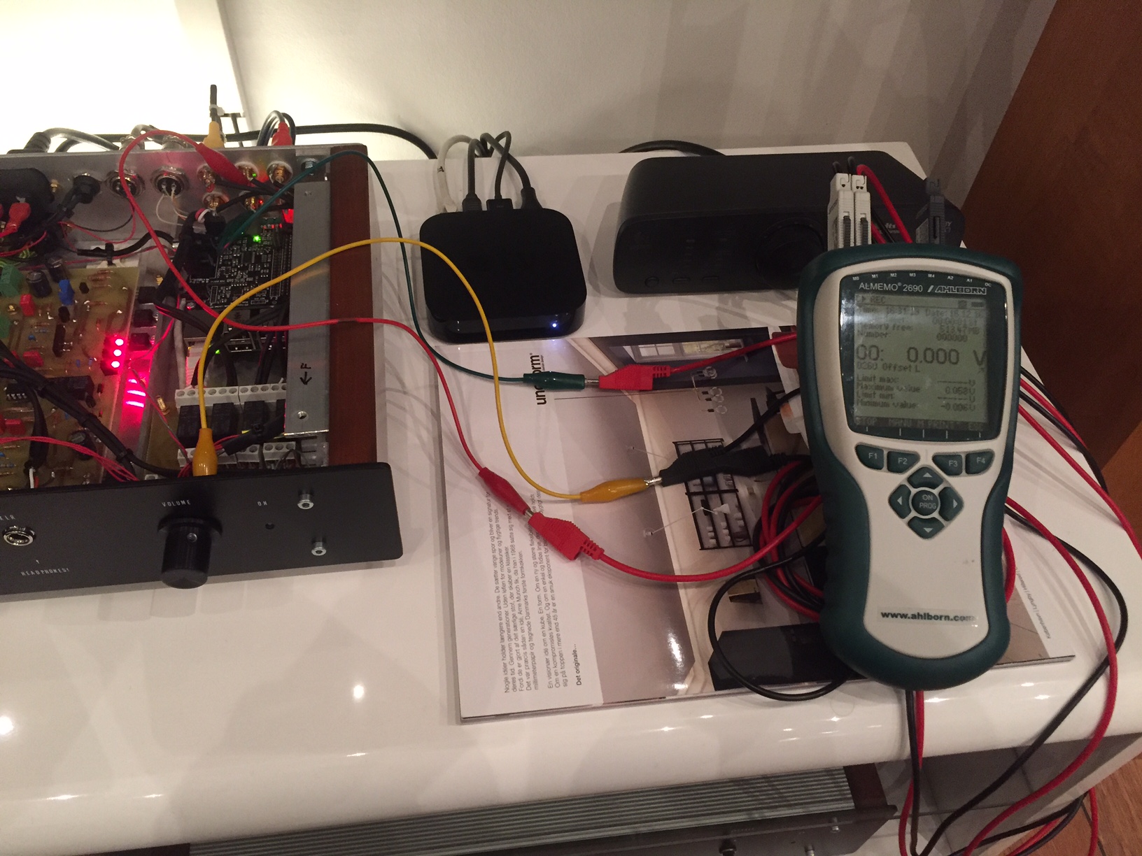

BTW Jesper, I forgot to ask. That initial spike in your DC offset data log represents the relay click moment in time or you measured before the relay and it represents the power on moment?
It's a short spike, long before relay enagages.
If you look carefully on the sheet, it's only for around ~3sec. EDIT from 1sec. to 3Sec.
This Almemo thing i brought home from work, is soo cool, can meassure 1/100 pro. secunds data log. -I am using it for periodical failure faultclearence on our cranes at Port of Fredericia https://www.adp-as.dk/
