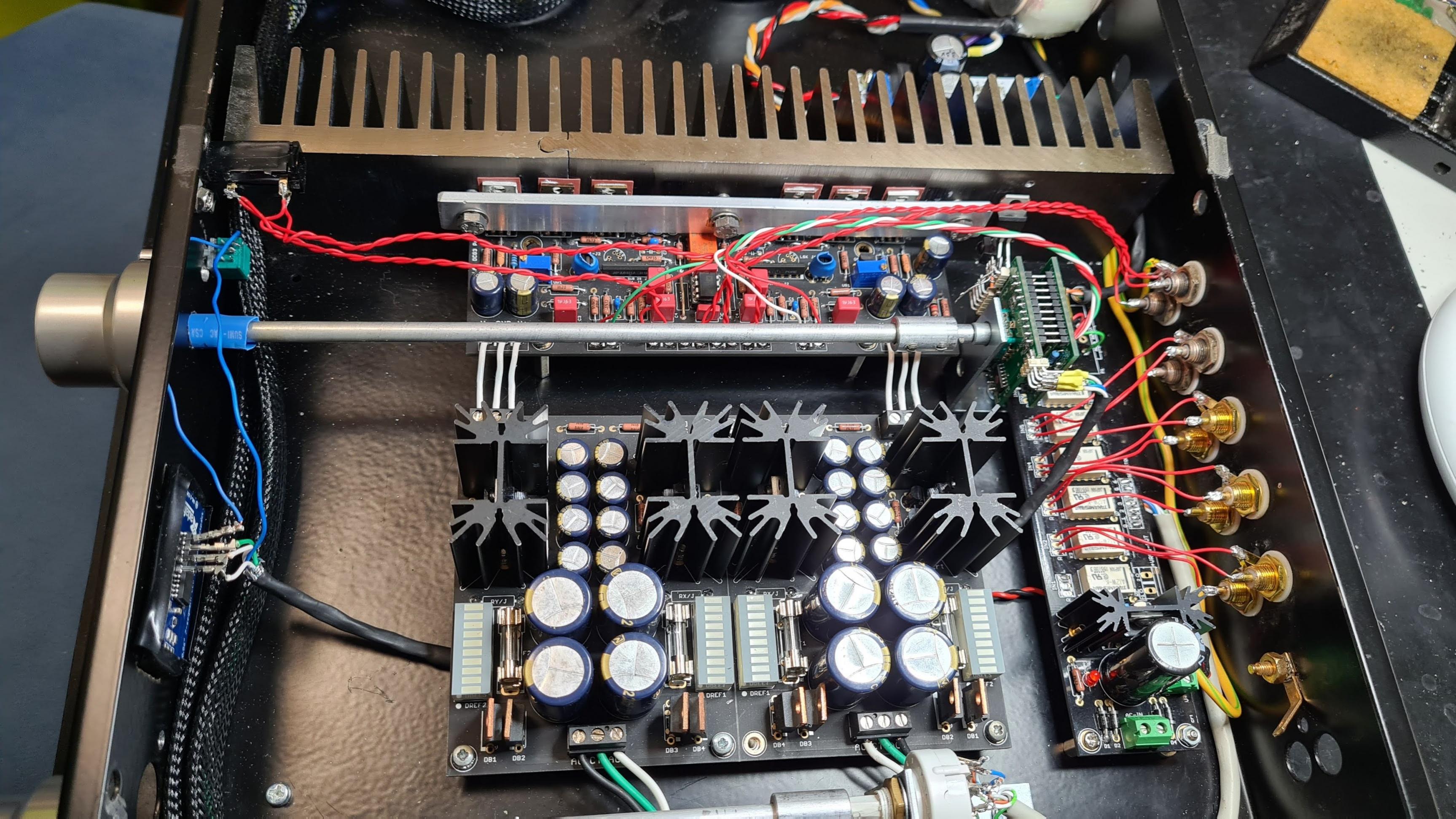

Finally finished the muses 72320 volume control also. Remote control works fine and also the Adafruit display.
Need a new faceplate.
Small progress... im waiting a few parts RCA -Pot Tocos 20K- Emi filter-knobs-UP68 Im playing with chinise 2sk170 - 12ma very pleased...

@nokosokey - Looking good. What did parts/values did you use for C6 and C7? These look larger than then GB kit parts.
Jaytor thanks!
Yes indeed...
I put what I had in my drawer ....they have value 220uf/100V.

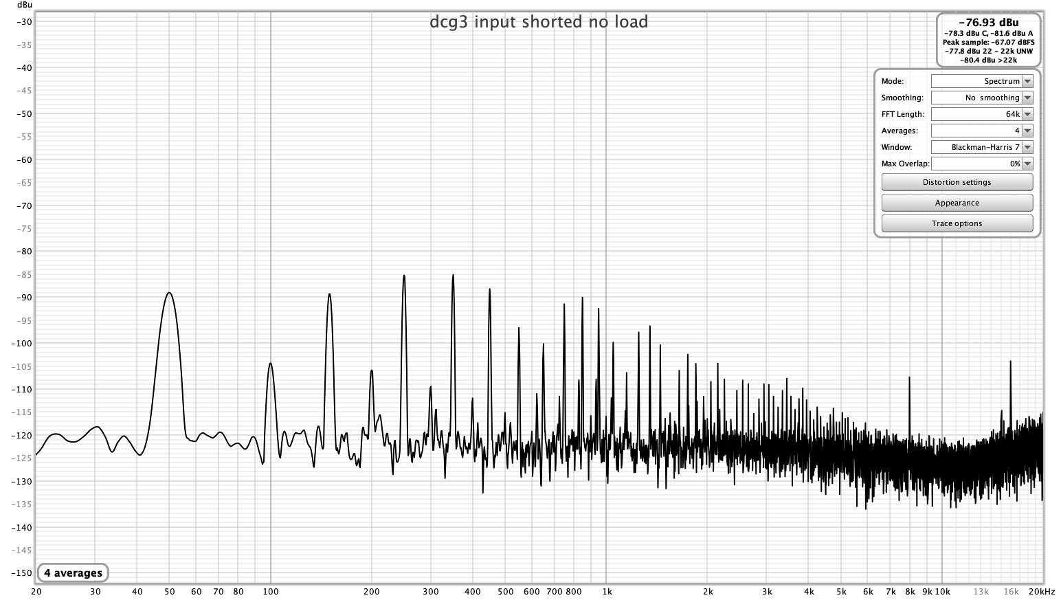

Quick question. The dcg3 plays very well. However a slight "hum" can be heard from the speakers when ear is close to elements.
It seems as I got some 50hz(mains), 150hz, 250hz, 350hz, 450hz etc. fundamentals on the outputs. They are pretty low in level but they are there.
Any suggestions what can cause this?

Ground loops, it's always ground loops. It's fascinating that the most important signal in any audio circuit is the one with no signal (theoretically).

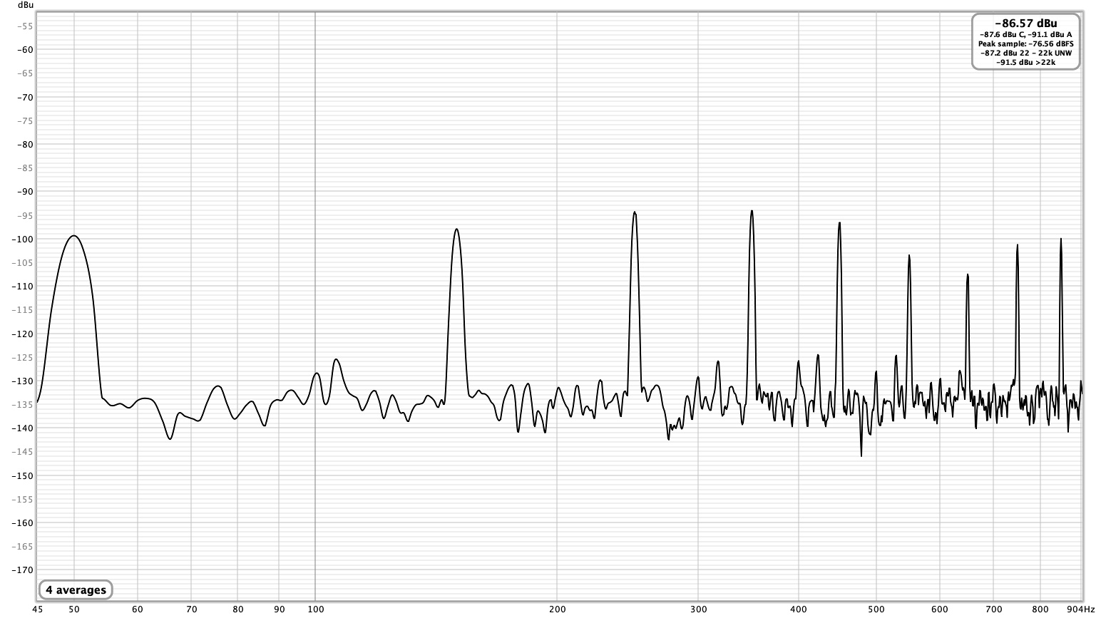

Here is a screenshot.
50hz (of course) and peaks every 100hz and smaller at 100, 200, 300 etc

Once you've covered the basics of keeping sensitive wires away from hum and so on, you need to look at your grounding scheme. There are whole textbooks on the subject, though. I have to make money for my employer right now, so can't really go on in more detail.

Loop area field sensitivity or ground loop between gear. See what happens if you lift the IEC ground from the chassis for a test. To see if there's a route through there.
I even disconnected the muses volume control (the psu for it) and the result remain.
Because the Muses has an independent PSU there could be loop area interference between its PSU zero and the general signal ground that refers to the DCSTB PSU's zero.
Lifting the IEC inlet gnd actually made the 50 and 100hz a bit worse. 150,250,350 etc. were unaffected of this.
Noisy kids here now. Limited time doing fault analyzes. Using focusrite solo gen3 for measurements and notice some has had some issues there also.

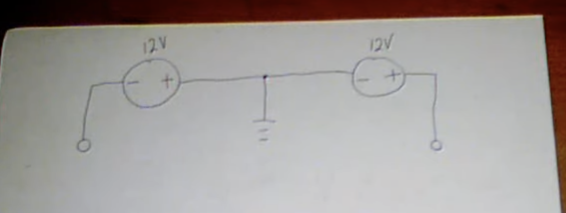

Had to gnd the +-15Vdc PSU for the muses volume. I think I got rid of the 100,200hz noise. However 50,150,250 etc. is still there. I am a bit lost here.
Have gone through this thread that looked similar
150 Hz / 250 Hz / 350 Hz noise in linear PSU
BTW: The +-15Vdc PSU are actually 2pc +15Vdc which I connected to commond ground to get +15 -0- -15 voltage.
Like this in a way
Based on TPS7A4700.
Is that a good way of doing it or could that be the reason not having positive and negative regulators...

Better lift circuit gnd from chassis and verify it's floating. I don't know how muses volume control works but is it as usual sensitive to pot's shaft grounding?
You can also try with sourcing Raw DC from the DCSTB (+/0/-). Then LM317/337 or 7815/7915. So everything will be referring to the same system. Maybe the positive centering float no float mix brings some noise (?)
bambadoo, you do not need an extra ps for muses.
You can put 2 leds in series, 2 per rail, to drop +-17v to +-15v, so can use dcstb.
