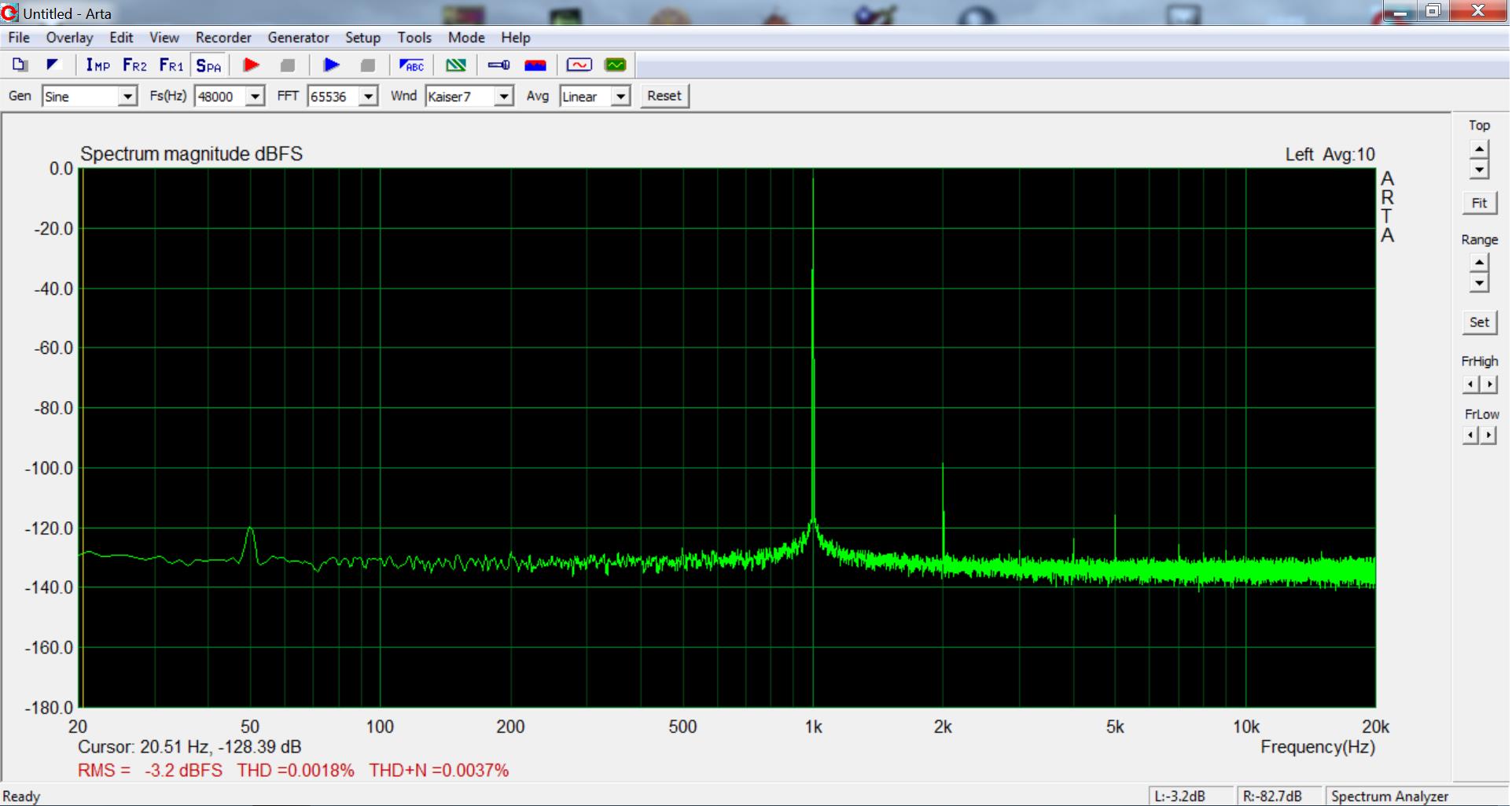

No change in "setup".

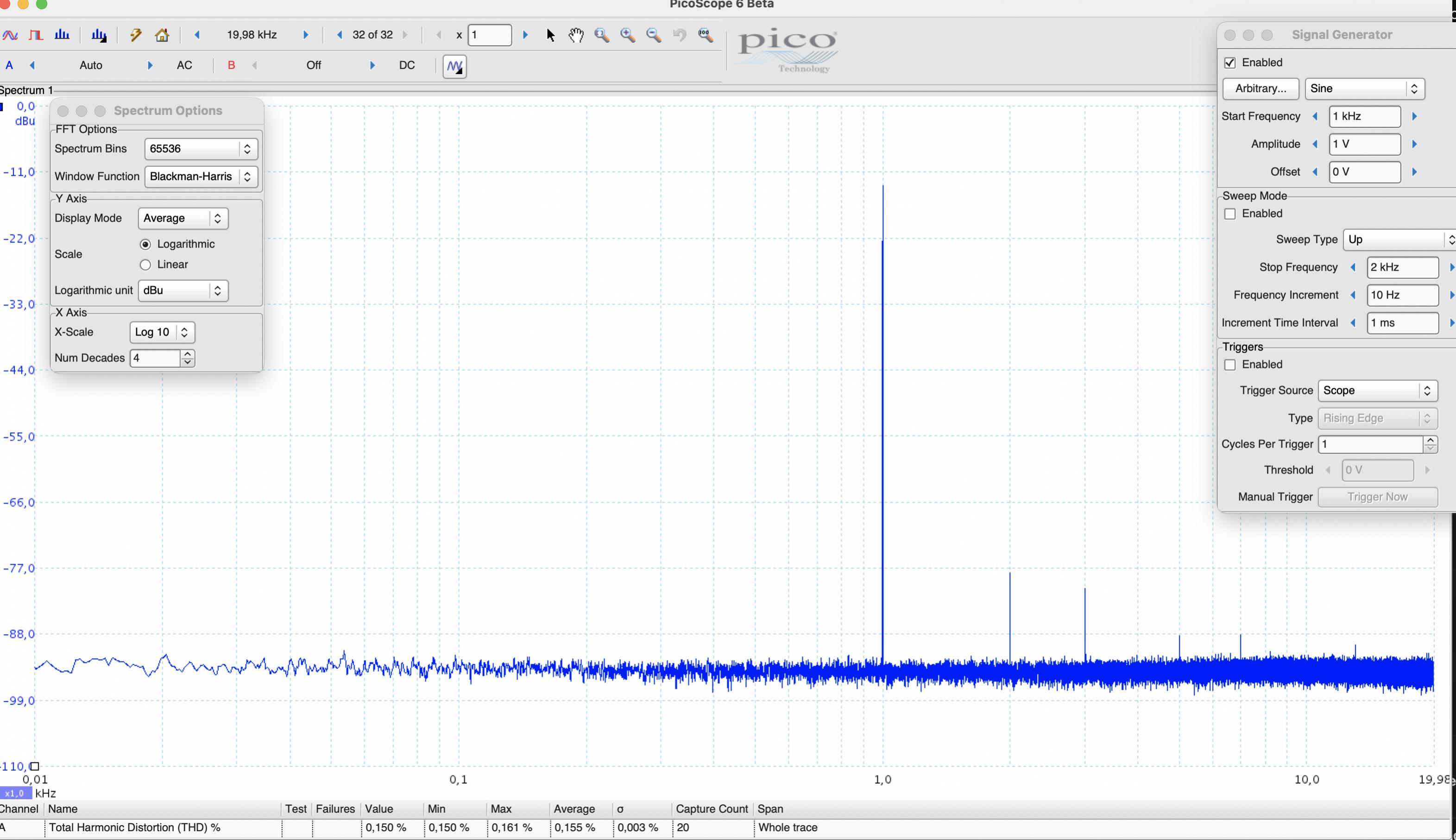

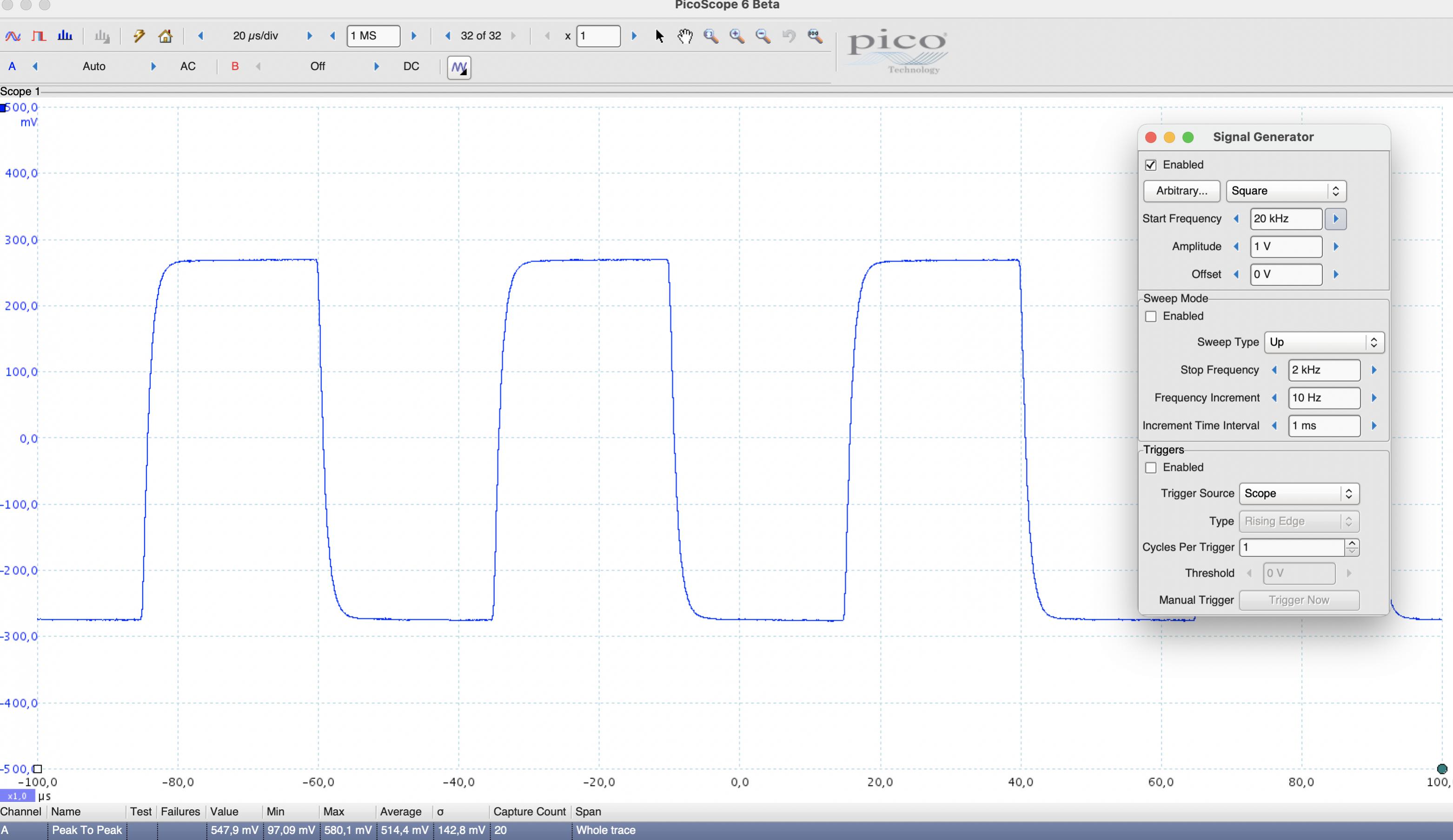

Just tried a new measurement using Picoscope 4226 - 12bit.
Looks fine but I guess it is has not got the resolution for this.
20khz squarewave also added

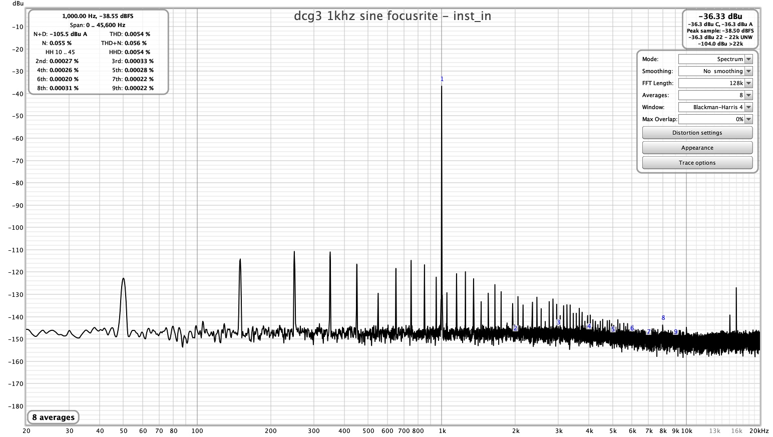

Actually wondering if I got som gnd issues between the dcg3 and the focusrite soundcard that causes the 50hz odd harmonics?

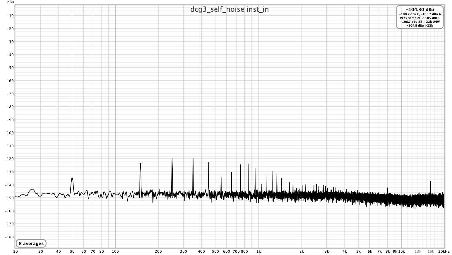

Lost in translation here. Tried another input on the soundcard. (inst_in).
It has not got the same resolution but still good.
The odd harmonics are 110dB down.

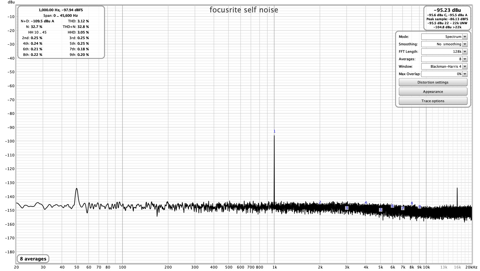

Also attached its selv noise at that input, and I am not sure if whether these harmonics in fact now is caused by the "measurement setup" (gnd loop between boxes) and not by the dcg3 itself.
I havent got a doctors degree in measurements to be honest.

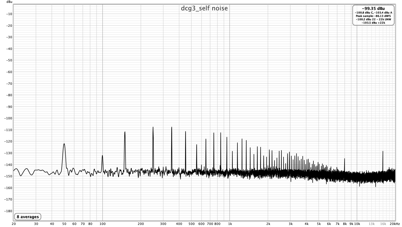

Connect the dcg3 output only to the Focus (no signal loop) and run noise floor to see if the same harmonics are there
2 measurements. Nothing connected to the dcg3.
1. XLR in on soundcard (mic in)
2. Instrument in on soundcard
The harmonics are there but not as severe as yesterday 😉

Thanks for helping out. Will look into some more tomorrow I guess.
However after doing some reading different places I am starting to believe that maybe its the focusrite itself that can cause this. It is somewhat prone to pick up 50hz and also its harmonics.
Some other have had similar issues albeit with former generation soundcards.
Like this
https://www.diyaudio.com/forums/equ...2nd-gen-measurements-whats-5.html#post5029760
Especially this
https://www.diyaudio.com/forums/equ...2nd-gen-measurements-whats-4.html#post4965244
https://www.diyaudio.com/forums/equ...2nd-gen-measurements-whats-4.html#post4965443
https://www.diyaudio.com/forums/pow...z-350-hz-noise-linear-psu-10.html#post6412128
To name a few. Will look into cabling (using RG62 coax , diy xlr to rca but it is a couple of metres long) and a TRS (balanced jack - to rca, shorter cable with ferrites etc and the result with that setup was better) to test with 2 different inputs on the soundcard.
For what I know, the dcg3 could in fact be just perfect and its my equipment picking up stuff?
