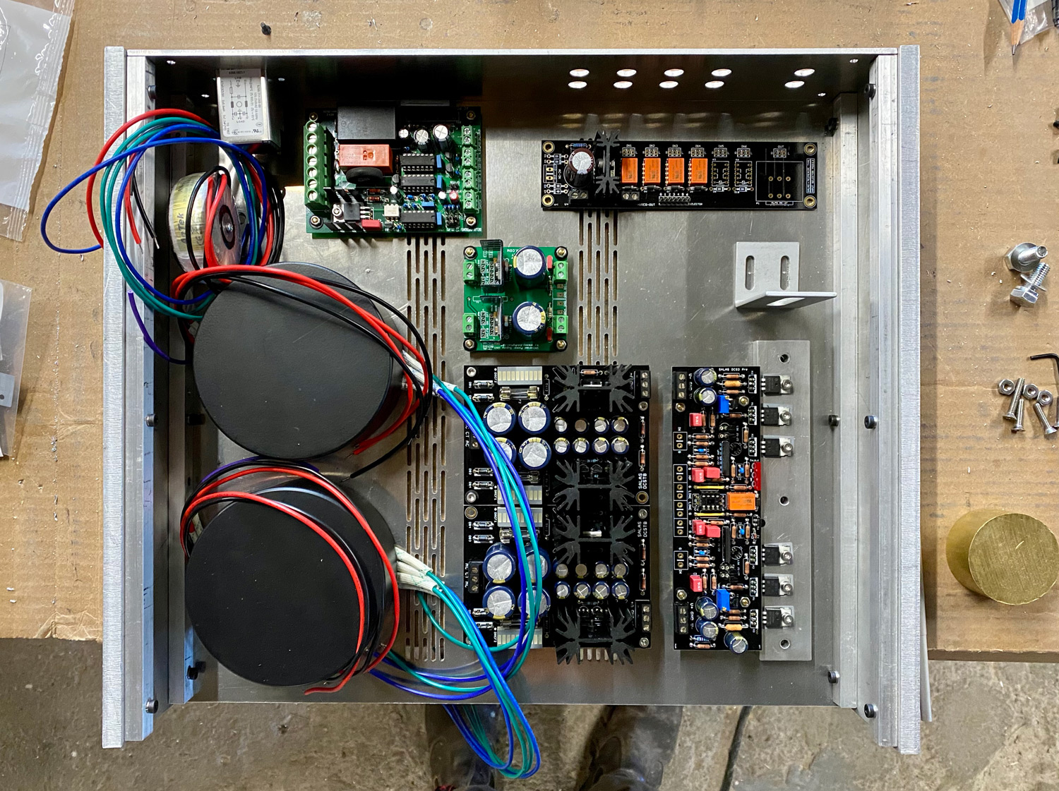

The kits from Tea are just awesome (plus he made a nice little build guide I found someplace). T400mA fuses included. Anyway—some progress on mine...few more holes to drill and I'll test the PSU.
Also—plan to pull DC for In-select from one V+ 2200 cap per Salas recommendation someplace in this thread!

Congratulations for your progress. Looking good so far. What are the extra green boards for?
Green boards:
—Power management, pwr switch control, LEDs, 5V for the Muses display
—Muses bipolar supply. Trying this out as a standalone to see if I can hear anything. I put a Muses controller in my Aikido and it was a marked improvement over the TKD. I powered it off one of the heater supplies via a tiny SMPS to get +/-15V...which is supposedly a little rogue. It worked just fine—and now we can remote control the volume with an old Apple remote. Slick.
Planning a slightly different Muses implementation by another member here that has a bunch of features and a small round OLED display.
Any reason to not use Mark's power management board? The inrush is totally overkill and likely not needed—but would it hurt anything?
I used Marks power management board in my DCSTB/DCG3 and all the voltages were perfect. I have not yet got to the In-Select signal portion of the pre however. I use it on every box I want to turn on and off. I am pretty nieve about this stuff so take this with a grain of salt. I haven't seen anything ugly yet but I may not be good enough to know.😱 Put it on Salas' UFSP Phono also.
