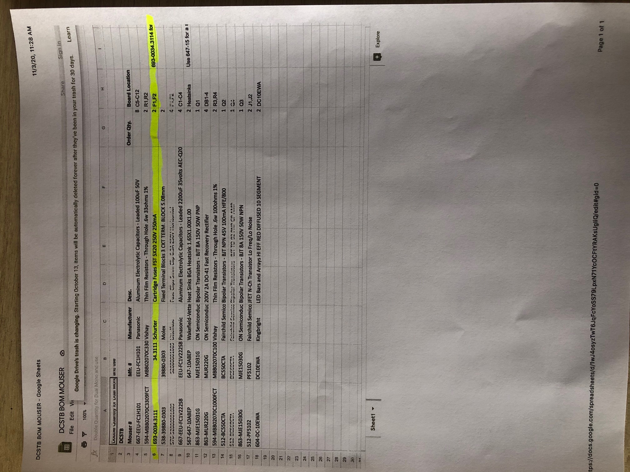

This is what I used. (see attached). Should have double checked the pdf. Moving on, I cannot find T350mA in this neck of the woods so I will follow pfarrell's recent comment and use T400mA.
As always, thank you Salas for watching out for us.
Don
"DC rail Fuses
4x F1,F2 20mm Τ350mA 250V in double mono PSU or T750mA 250V in mono PSU"
That's from my PDF guide
Are you sure the blown one is 250mA? T350mA means Time Fuse (slow blow) 350mA

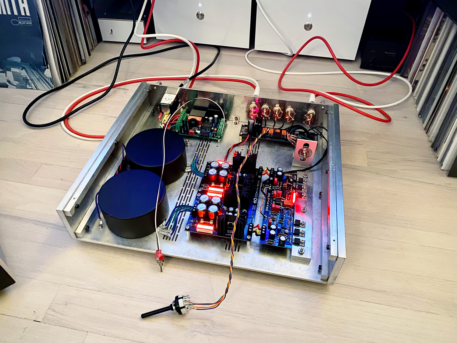

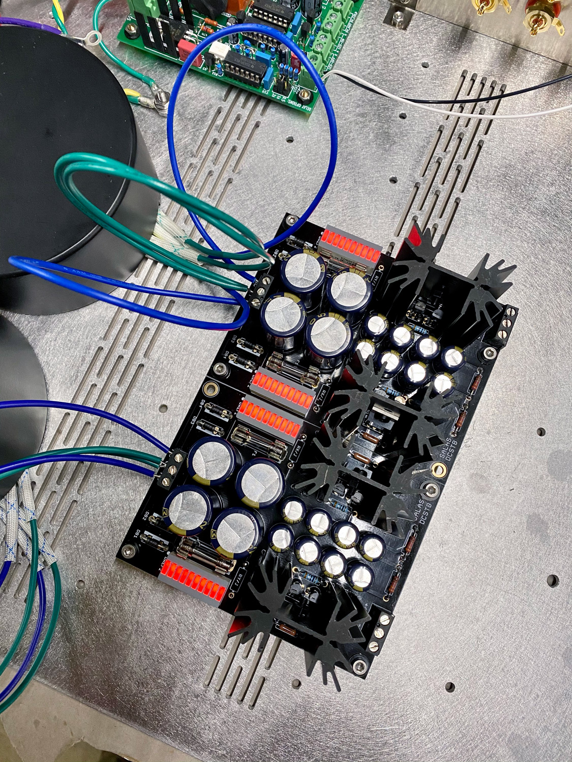

This is VERY VERY good. More critical listening tomorrow. With a lid... and some records (UFSP of course). Gut reaction is VERY 3D and natural—3Dness similar to my first monoblock experience (M2X in the background there)—so, the dual mono thing is real as far as I'm concerned. I was a little concerned that I'd miss the Aikido (tubes)...but have to say, not feeling that at the moment which is a pleasant surpise. TKD linear pot with resistor shunt mod sounds great. Muses etc. later—wanted to verify a working (and quiet) pre before things get more complex. Power up and bias were a breeze—good instructions—all by the book. DEAD quiet into the monkey coffins. Nice!!! Thanks Salas. More later. 😀

Salas—another winner—not really sure what you are on. 😀 Haha. You have some serious skills—I would love to hear your personal system.
I have no expectations with these audio evolutions. Just the synergy of the randomness of my own system I suppose—the build choices are all instinct for that matter...and the room it is all in is currently beyond my explicit control.
Current comparison is related to Aikido, which to be sure is an awesome preamp—tubes—and I tend to lean towards the sweet side of the spectrum, personally (I'm not sure I'm a "tube" guy though—kinda like picking motorcycle brands—I love them all). My quest is really about finding zero anything coming from my speakers when all is powered up and nothing playing—based loosely on some past experiences where less raw noise seems to equal more of the all important music itself—the goal being raising hairs on arms and getting body response—chills, whatever. On that metric—what I hear with records as the source and nothing actually playing is—the most "nothing" yet. I may be able to hear "something?" with ear in cones—but i really can't be sure. Haha. So that's awesome. I suspect that each component with each other component have influences that are certainly beyond my current knowledge. UFSP is inbetween the SP-10 and the DCG3—is this a factor in your designs at all Salas? Is there Salas-Synergy?
After about 10 records of all sorts of musical styles—the DCG3 is without question worth the build time and parts. There have to be a bunch of factors here that as mentioned are highly specific to all the various elements. There's a lightness now to the music—no less full and rich—just more "space" (dual mono?) and life. Feel like I could listen for years. Not that it wasn't great before, it was. We aren't talking sea change—but a big—worthy—difference nonetheless. This stuff is SO subjective. Started with the BC327 for what it's worth—and the kit opamp. Still love the different qualities of the AT33PTG/II and the Hana ML. Two arms will solve this of course.
