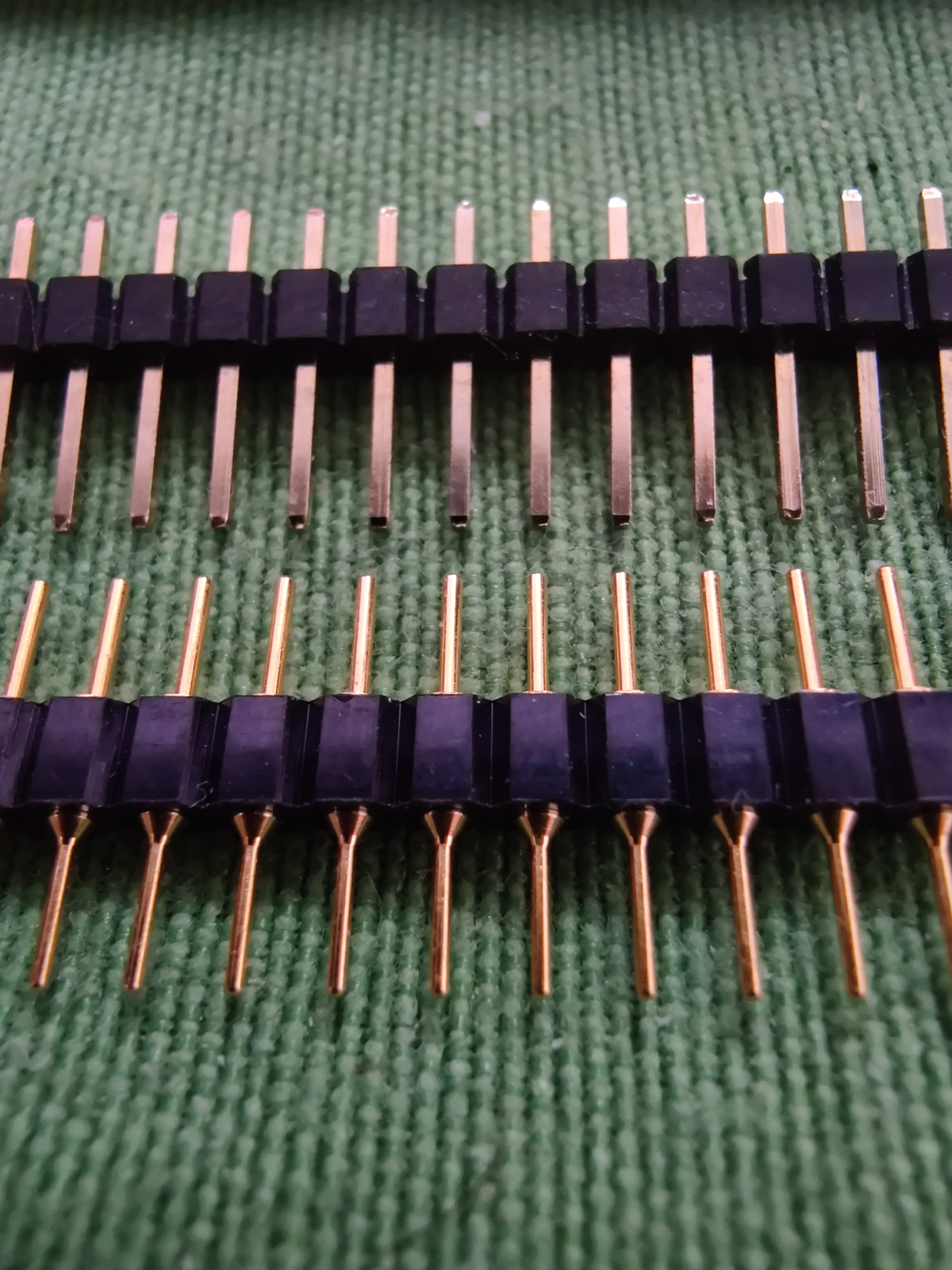

BTW here are the pins I tried. Headers I got from Thai shop etc in the past. Upper row does not fit the U1 socket. If over-pressed the most it may do is jam in and stay high. Fits my prototyping breadboards though. Maybe fitting older style double wipe DIP-8 sockets too. Surely not for modern ones with the gold plated round inserts. The bottom row fits into them nicely.

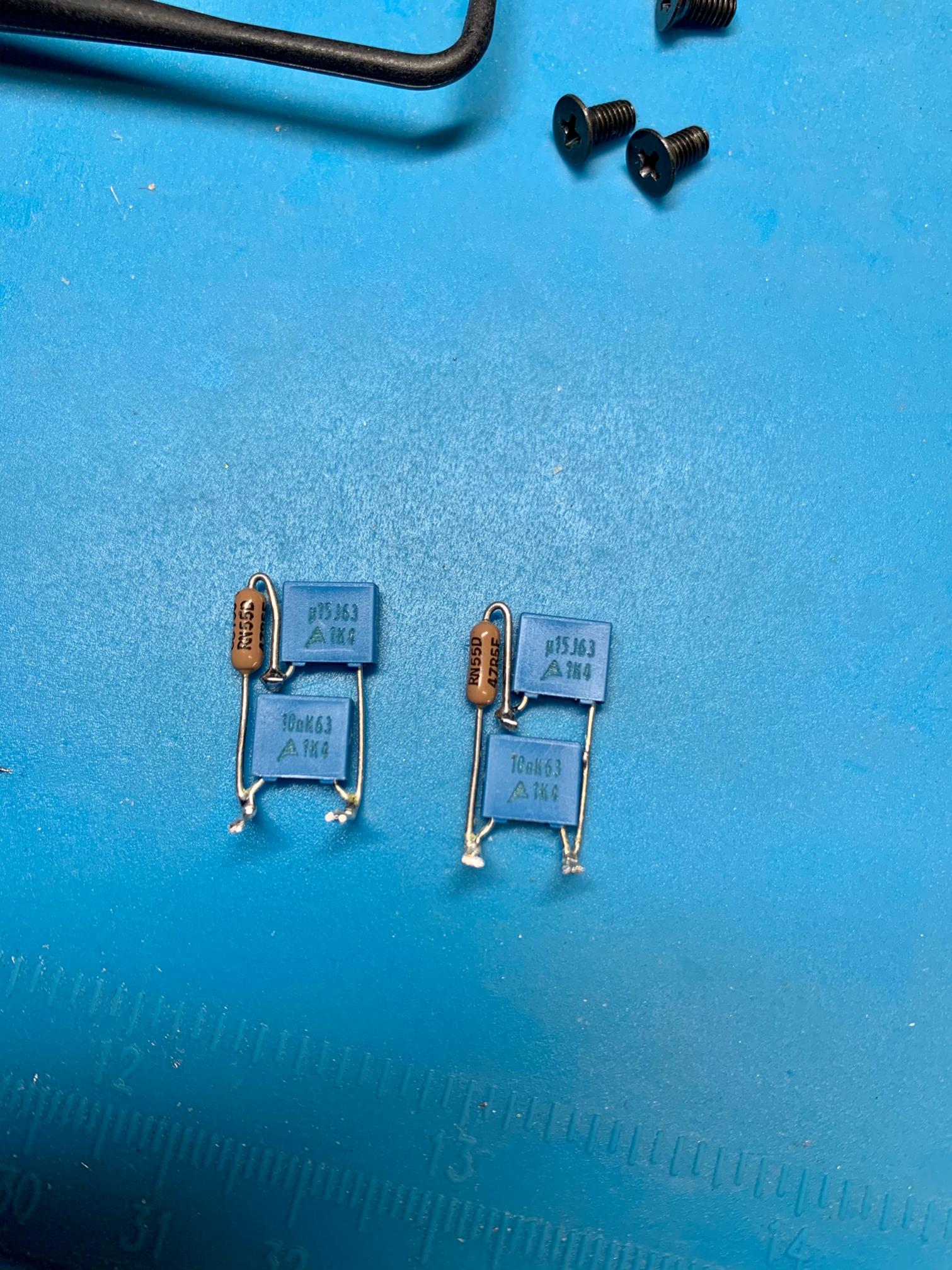

I have some of the Hammond 229D34 transformers for this. I used the Quasimodo, for the first time, and got the following values for the snubber, C2 10nF, C3 150nF and 413 for the resistor. Please note this is the first time I used the Quasimodo and may not have this just right, but hopefully this helps someone.
Jim

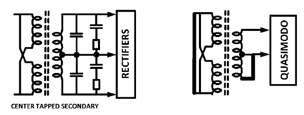

Working on SissySIT so I Quasimodo'd a few transformers. Since the setup for this pre is centertap if doing dual-mono—I had to review Mark's documentation to see about that setup. I'll make little plugin rigs that are effectively doubles of the ones shown in the pic—which were for the RAW supply on FSP/UFSP.
Point is—Really nice snubbed waveform on the Antek AS-0518 with 56R.

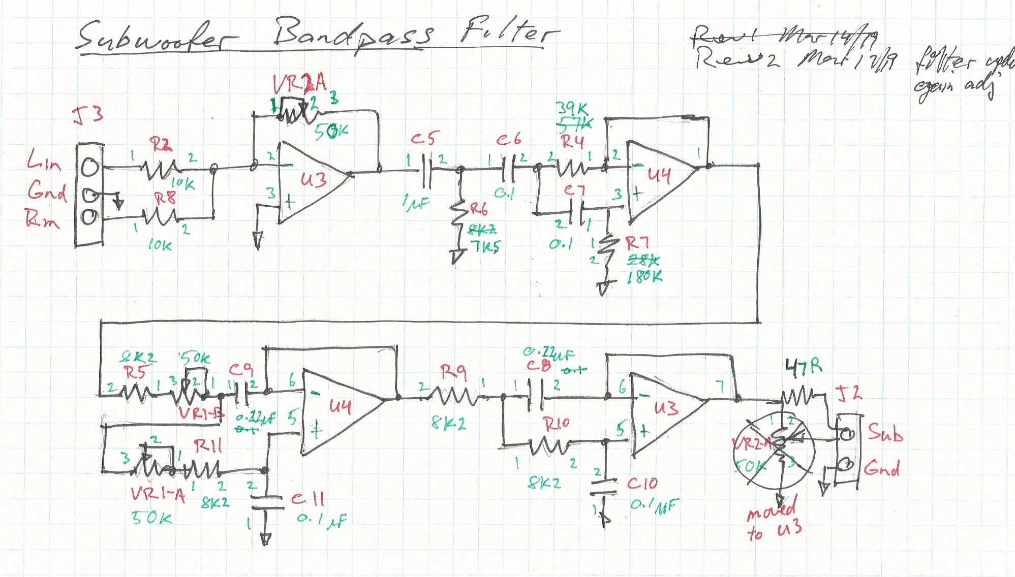

Hi guys. Sorry to go over old ground. I asked a similar quantity last year but I have changed direction a little.
I had a REL subwoofer that I was advised at the time to bridge R15 and add 220R from the hot line out to the new RCAs for the SW. This was assuming I was going to go from stereo outputs >y cable> REL mono rca input. Also this was on the basis of the REL having an input impedance of 2.5k if I remember correctly.
Now however, having given the REL to my son and i now use a Polk DSW400 for which I do not know the inout impedance. I shall be taking the additional RCAs from the DCG3 into a small summing/low pass active filter...schematic below. It has 10k summing into NE5532.
It would be very awkward for me to bridge R15 as removing it all from the chassis is tricky. So my question is if I leave them in situ can I add the additional R to the new outputs? Shall I start with adding 51R or maybe 100R?
