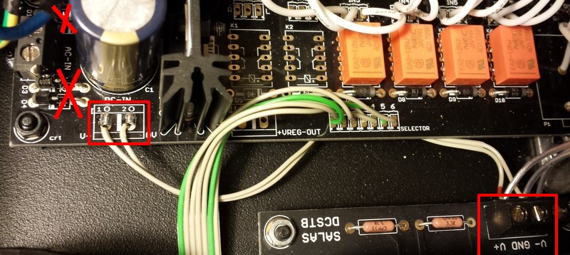

Is that an independent secondary? Looks shared.
Better convert the selector to DC powered from one DCSTB's reservoir capacitor pins. Something seems very wrong with the zero reference levels as it is now AC powered.
Have to check again the beginning of the thread to see how the selector has to be powered. As for now, each transfo is 2x18V, one of 18V (top transfo) is powering both the DCSTB and the selector.
Just a small sugestion from another novice, your box looks to be painted have you filed off the paint at all earth chassis points, it may help to secure a good earth conection. I realise this won't help with the smoking issue.
Chassis points have been drilled, and the continuity has been checked with a multimeter. Looks like all the 'chassis' points are connected together.
Novice here too, mostly for the box part 😉
No, don't do that long back reading. In your config there is a 9V difference between selector's local PSU zero and DCG3's zero. It burned a local PSU diode when you tried to connect them zeroes you said.
Read the input selector's little pdf guide. Make it raw DC input. Basically remove its local PSU rectification diodes and the secondary AC line wire tap that now feeds it.
Tap from one DCSTB positive raw DC reservoir capacitor +V 0V pins instead and feed the DC in pads of the selector board.
That way they will have same zero level and the hum will probably stop as well. Now its very possible there's hum because the relay coils see a non related zero to the signal they pass. There's possibly hum loop area between them.

Reading your last comment and now thinking again about it: the selector was supposed to be powered from one of the DCSTB (as your comment) and not from the AC/transformer as it is now. Maybe looked simple when boxing the amplifier but not as planned. Thanks again for your advice and fresh reminder.
Since I plan/have to remove the selector diodes I might also change the power-unscreened-wires to screen ones (the selector being very close to the input power connector).

@ Salas,
Going the DCin way from the 'nearest' DCSTB for the i-selector (about 17-18V), is it mandatory to remove the D1-to-D4 diodes? What would happen since the ACin is not used anymore.
Very troublesome to unsolder all, might simply cut the diodes if they must be removed.
Not necessarily removed in all cases but since you got a D3 already destroyed better cut them out.

No more noise! And good musical sound!
Cut the ACin diodes and went the DCin way from the nearest DCSTB. Also connected again the DCSTB power input GND to the chassis.
Now waiting for the headphone connector to 'close the box' and for the last parts to complete the amplifier.
Thanks again Salas for sharing your circuits, for your help and advices and thanks again Tea-Bag for mastering the GBs. It makes all a lot simpler for the end DIY builder, even if builder's errors do happen sometimes.

Congratulations. You are welcome, keep us posted. Although the DCSTB output was the easiest point to tap DC power without disassembly in your case, I generally recommend to tap from the Raw DC side under a DCSTB board. From one positive voltage section 2200uF capacitor's pins. That's still easy when planned before fixing all that stuff to the chassis and having them wired together.

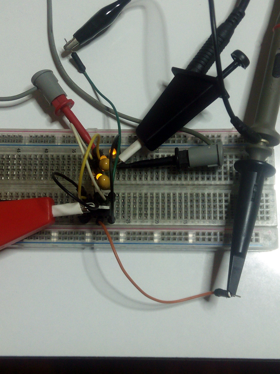

I found an interesting picture in my files yesterday. Date was 2015-11-4 and guess what is it. DCSTB infant! The first proof of concept breadboard test of it. A core block with small parts and few LEDS. 🙂
