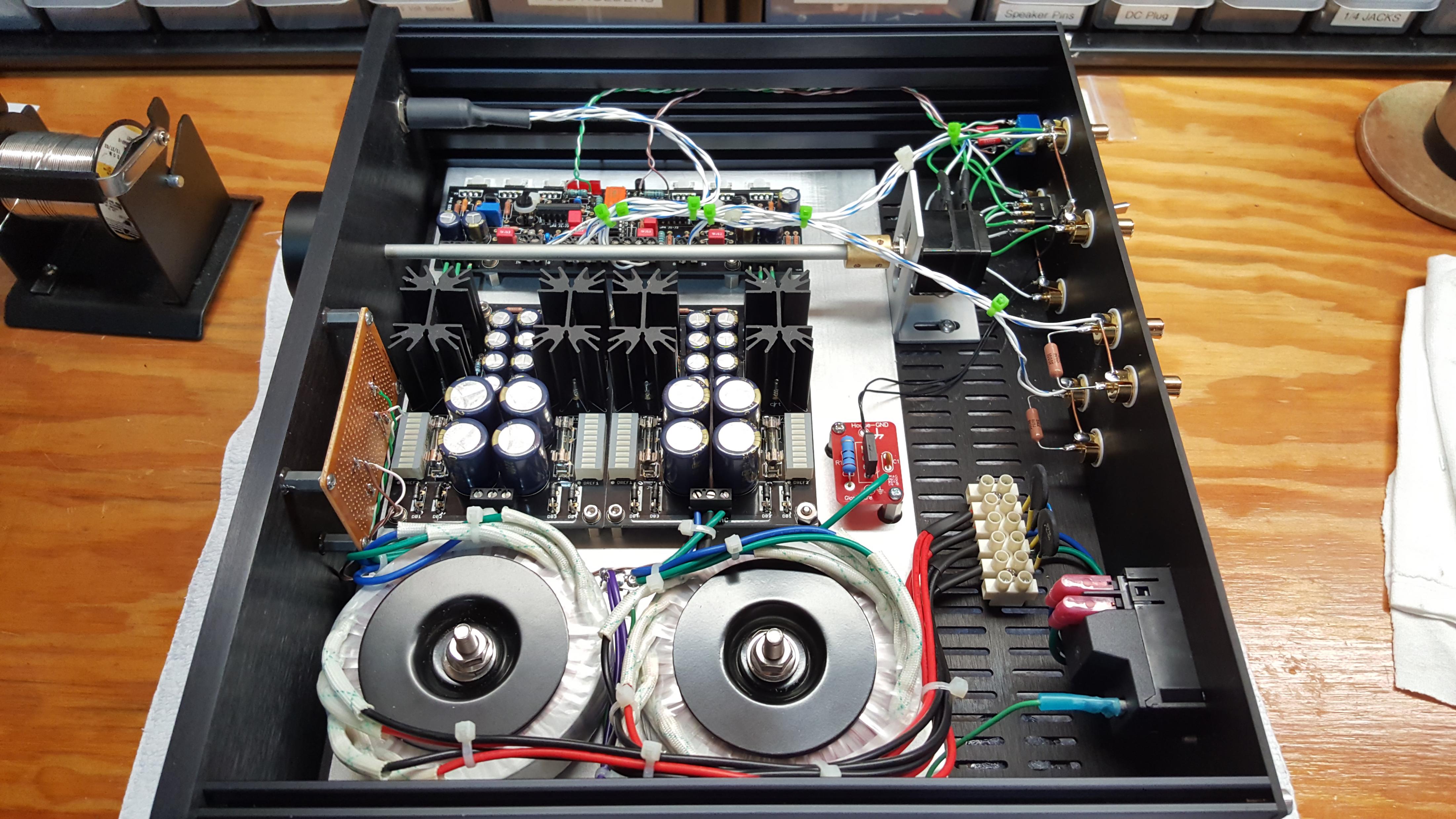

I recently went to listen to my preamp and found a dead left channel. I also hear a loud pop at turn on and noticed my amps protection circuitry had been activated. Upon inspection I found the positive rail fuse on the left channel was blown. I replaced the fuse which promptly blew upon power on. I found a negative 6 volts on the output. Further inspection revealed a wire clipping on the circuit board. This wire clipping came from my bench that is located next to my equipment rack. How it got thru the vent slots and into my preamp I will never know. I removed the clipping and the dc servo chip , replaced both rail fuses and powered it up. I was able to zero the offset and replaced the op amp. I now have zero volts on the affected channel and 3 mv on the right channel. The 3 mv has been there since day one. Is 3 mv acceptable or should I buy another op amp ? My fuses are T500 ma and the design calls for T350ma. The only place I can find these fuses is a lighting store on Amazon. Should I replace these fuses or will 500ma be ok ? The preamp is up and playing music quite nicely.

Flying wire clippings are evil. Especially clipped pins from pcb parts can travel several meters and land anywhere. On some unlucky day they might end up in a computer or in a scope. T500mA fuses should do for now. Especially if running the output stage bias at 150mA.
The 3mV DC offset isn't harmful at all. Same type AD823 op-amp other samples usually do better, could differ less for your other channel, but no worries either.

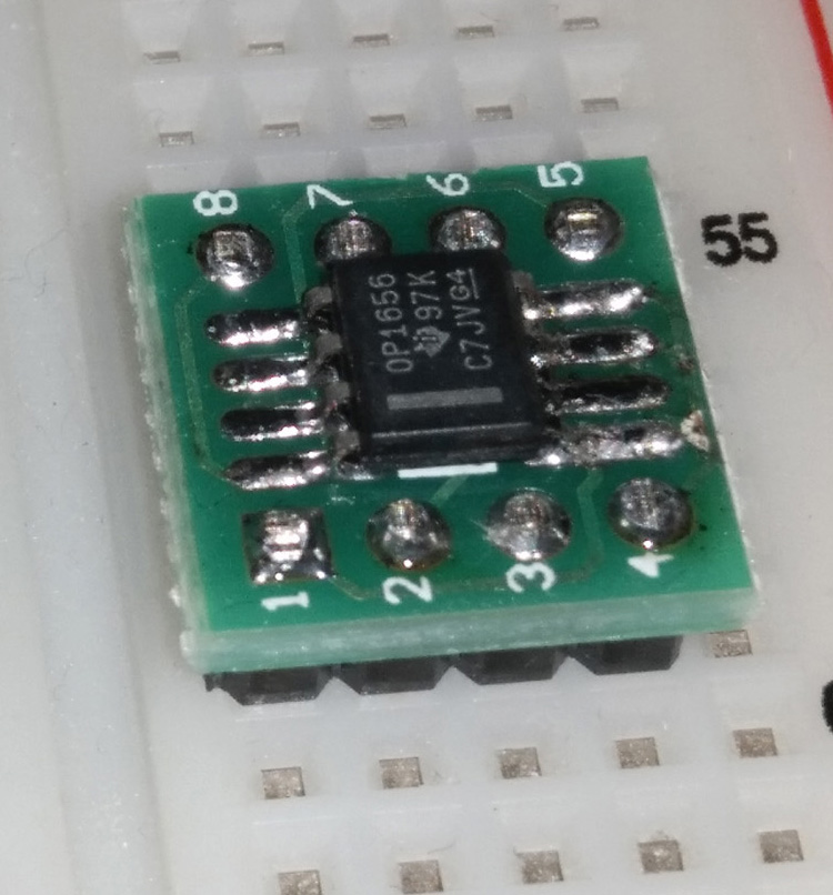

You reminded me I want to test some OPA1656 or OPA2156 new generation CMOS op-amps in the DCG3 at a point to see if they respond well to the servo task and if they improve the sonics further or not.
I have a couple already on through hole interface boards. But better I don't get tempted borrowing the cheese from another mousetrap of mine before I have spares to torture or kill...
