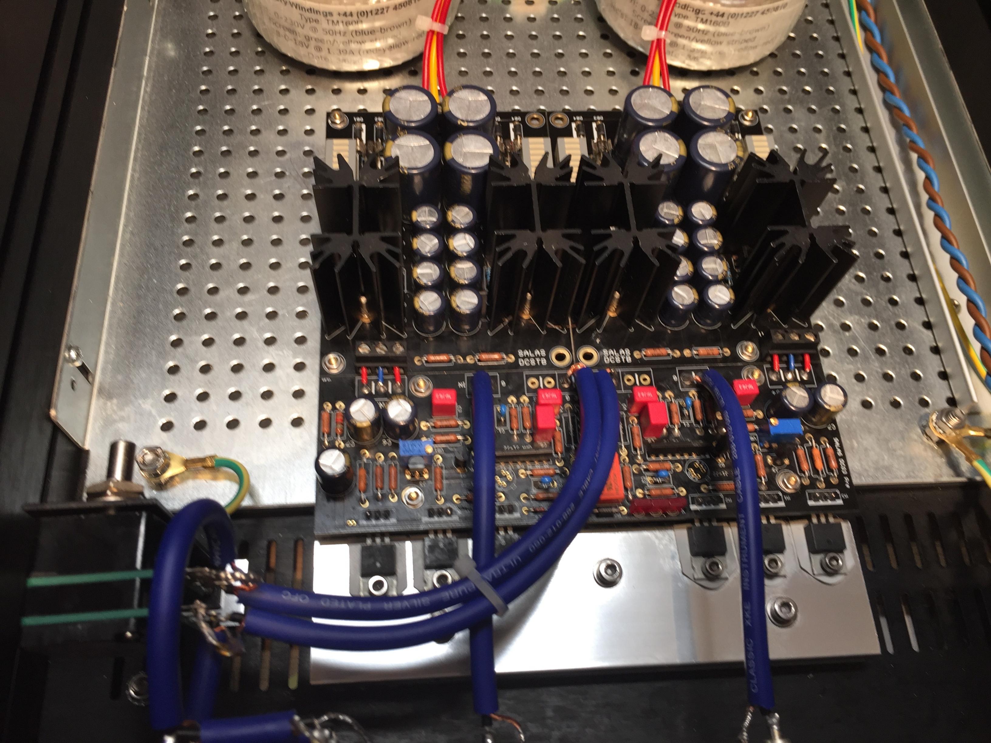

Hi Salas,
I have completed all the tests, results as follows.
Right R10 1.2V.
Left R10 1.1V, both with 10-ohm resistors.
Rails.
Left negative 17.45, positive 17.41.
Right negative 17.29, positive17.32.
Mosfets 40/42°
Sink below mosfets 38/39°.
Inner PSU sinks 49/51°.
Outer PSU sinks 45/46° and 47/48°.
Without the opamp + or- 5MV.
With the opamp one side stayed pretty much around 0 whilst the other side had occasional trips up and down to around + or - 2/3mv.

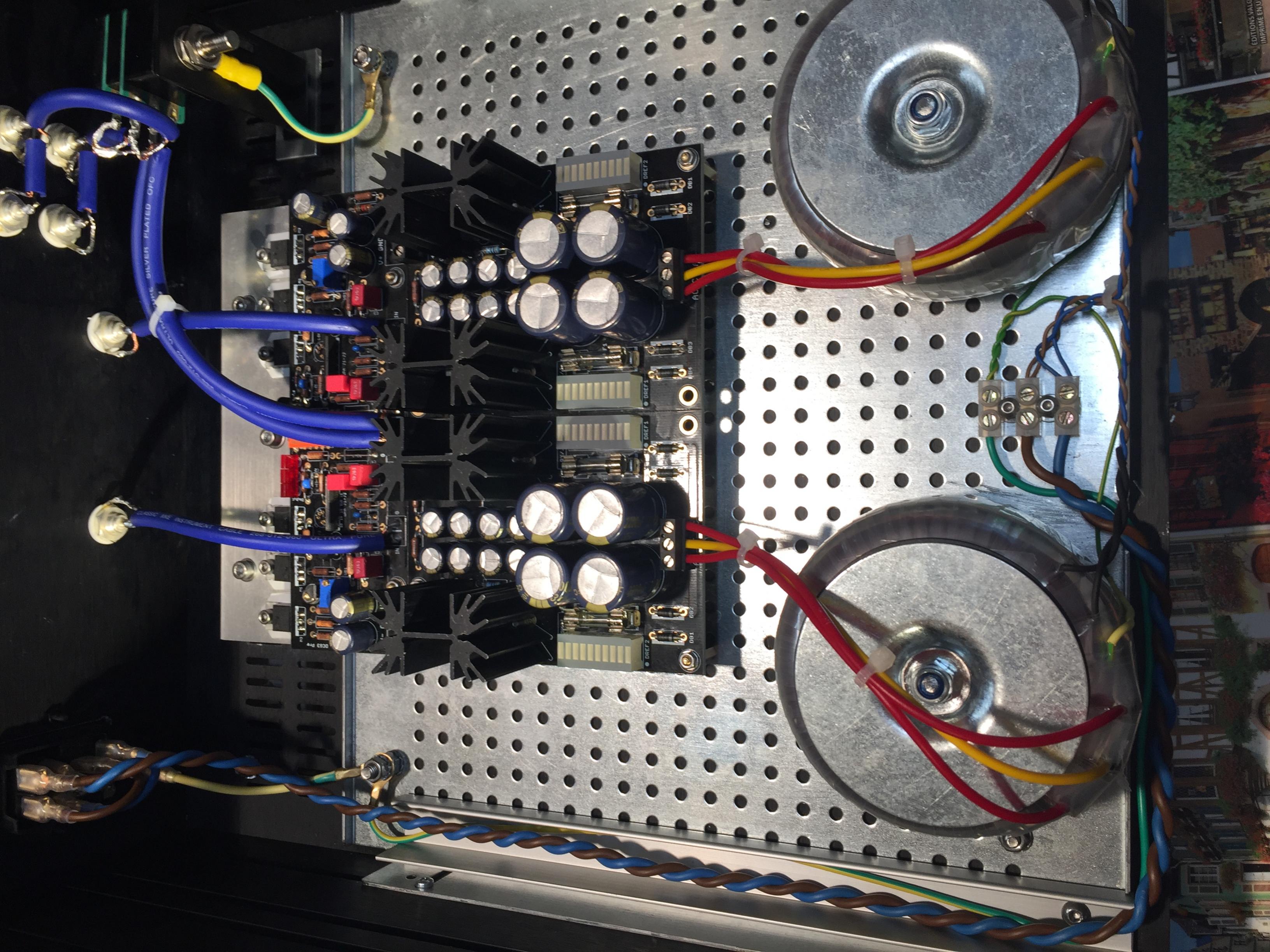

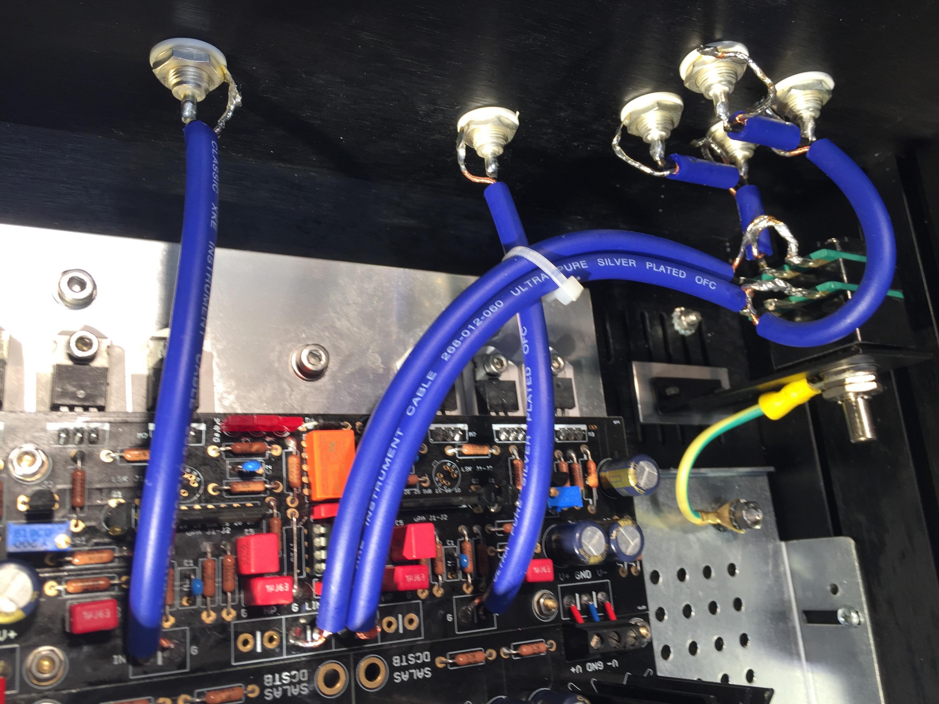

I have ground continuity to all metal parts, at the moment I do not have ground connected to the DCG3 boards and would like to know if it is OK to use the HP G as I am not using them for anything, should I bridged one to the other and then go to the mains earth or one to mains and one to the pot earth?
This is my first time wiring up a pot and would appreciate a quick check over.
Line out to pin 1, pin 2 to RCA and both grounds are to pin C.
As you can see in the photos I'm just using one input but may add the I select at a later date if required.
I have bridged across for my 2 outputs.
If you could have a general visual check over that would be great and if all is well I'll connect up the PCB earth and give it a whirl.

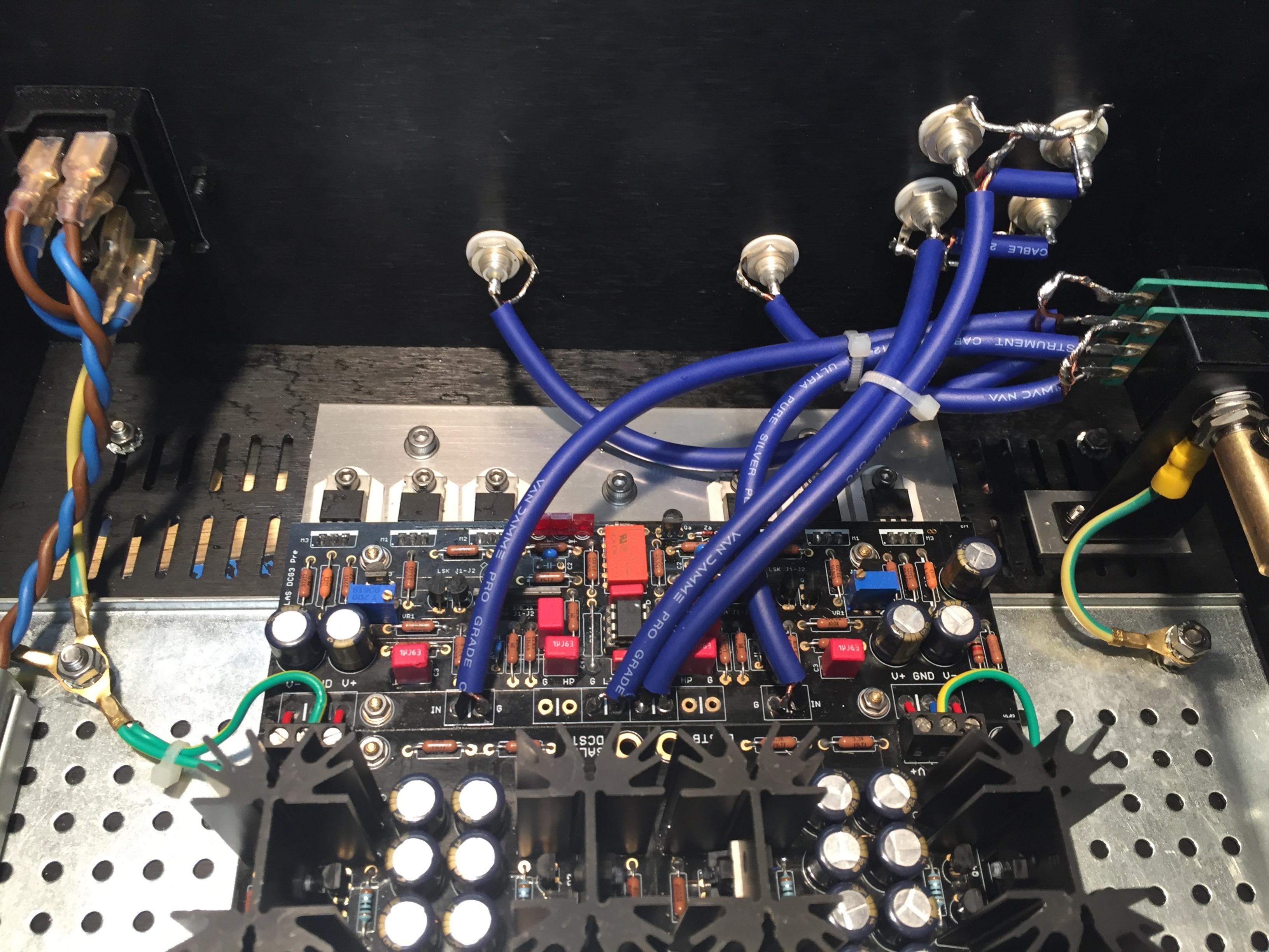

It stops just at the edge of the PCB, was struggling to find one solid piece of ally bar so it's 4 pieces of 35mm x 3mm X160mm all bolted together with heatsink gloop in-between, I wasn't sure how it was going to fit with the support tray but it went in very nicely and is over the vents for cooling.

Why you wired the volume pot at the output? Volume pot should go between Line in RCA and Line in PCB.
You should move the blue coaxial cables to the correct PCB places for exchanging their now in/out routes.
RCA in hot-->cable-->pot pin 1, pin 2-->cable--> line in PCB. Cable shield RCA cold to C to PCB line in G.
For PCB to chassis ground reference wire see post #4761.
Mechanically its a very good tight build, congratulations.
What was the room ambient temperature when you measured the Mosfets and sinks?
How you did that? With a non contact infrared meter or with a thermocouple probe?

I don't know the exact room temperature but it will have been quite high as my workshop is outside and Provence has started to get quite hot.
I used a non-contact infrared meter for all the temperature testing.
I'll make the wiring changes and get back ASAP.

Those conditions might explain the rather elevated temperature readings. If the infrared meter has emissivity adjustment its a very useful feature.
https://thermometer.co.uk/img/documents/emissivity_table.pdf

I re-tested the temperatures this morning, with an ambient 22/23° in the workshop (unlike the oven it becomes after 4pm).
Mosfets 36/37°
Sink below mosfets 31/33°
Inner PSU sinks 42/43°
Outer PSU sinks 40/41°
The above was with the lid off, after placing the lid on for around 10 mins the mosfets remained at the same temperature whilst all the sinks went up by about 3or4°.

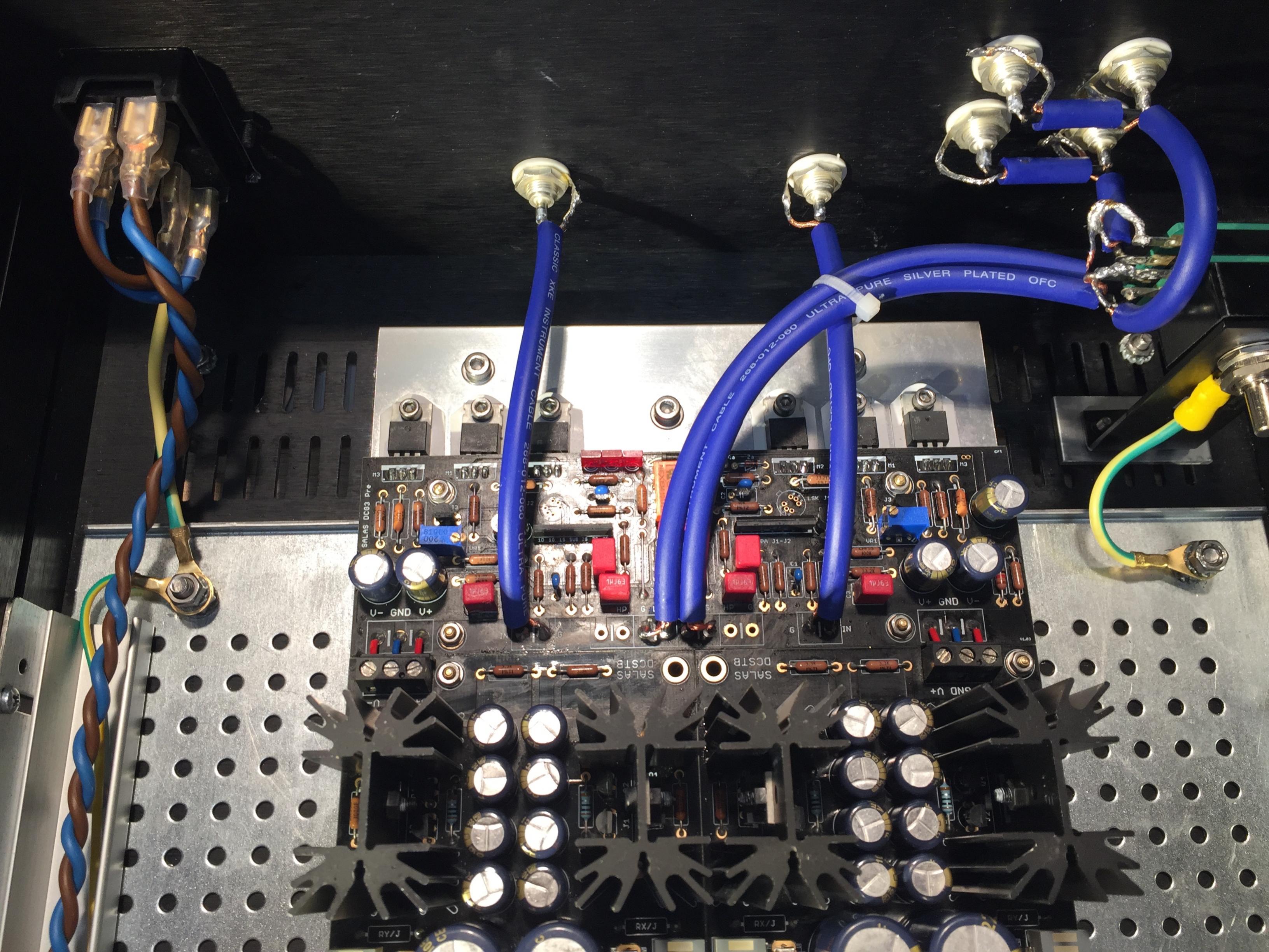

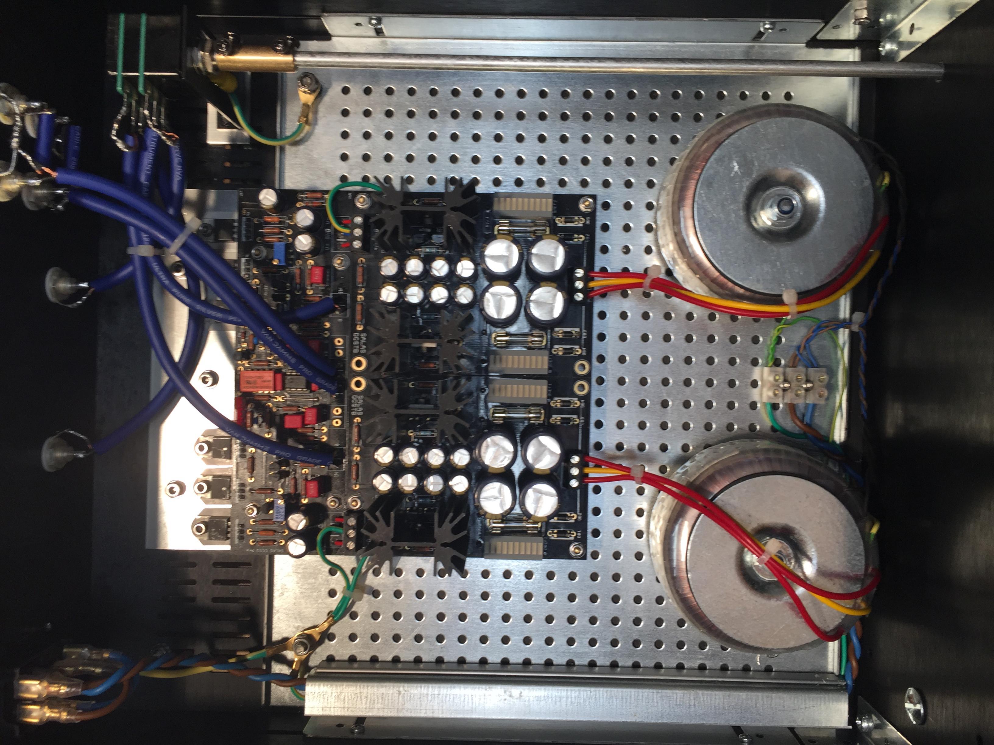

As you can see in the photo I have changed the pot wiring (apologies for that clanger) and added two grounds from the board to mains star ground.
I think I'm good to go.

Is the left button for a selector? Or just to add some symetry?
The connection does not appear in the 2nd/middle/from the top picture.
Well spotted, I may add a selector in the future but for now, I had the spare knob and thought it looked so much better with two on.

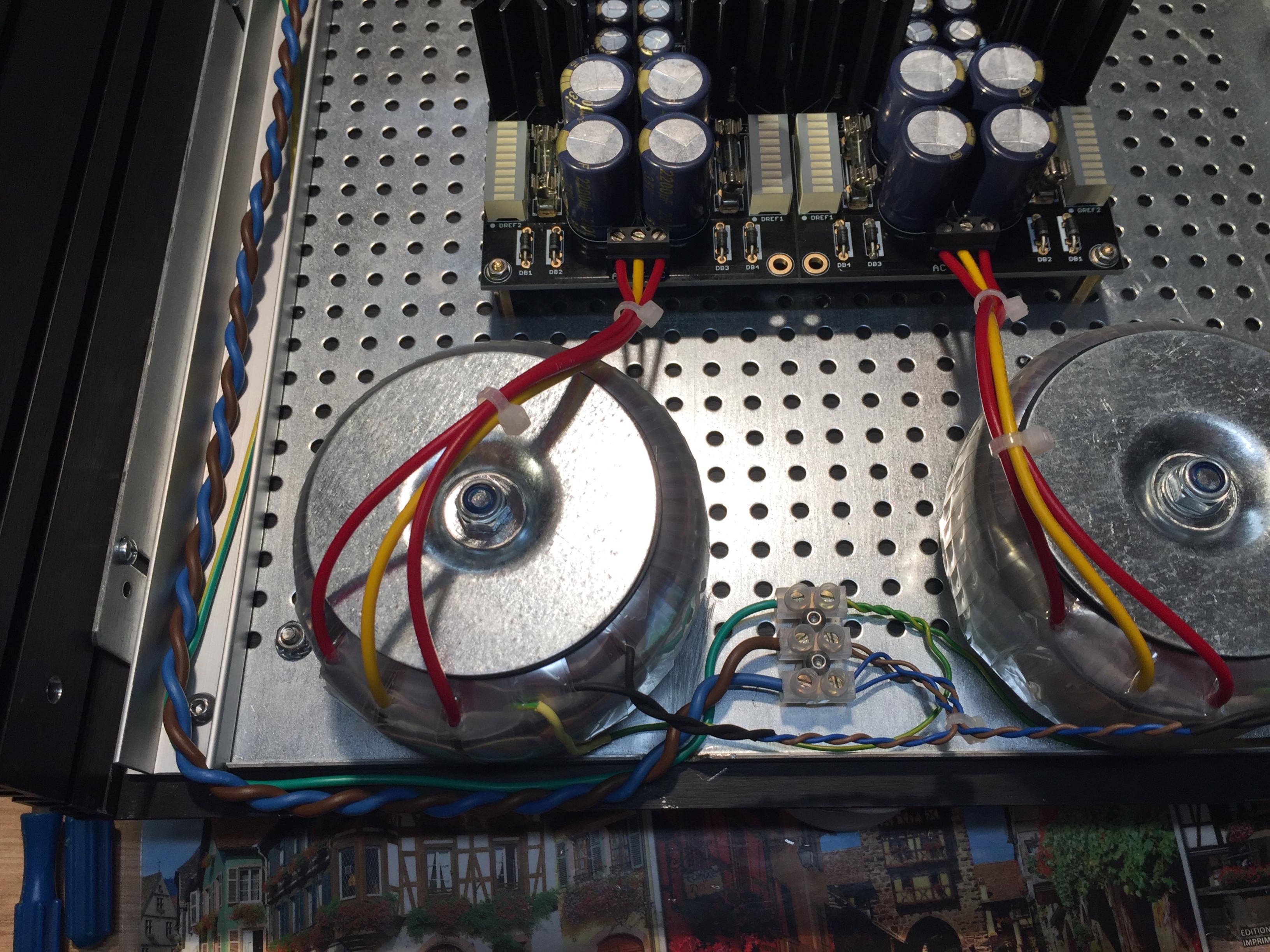

Not sure if you need the second ground to chassis reference wire, but if the build will behave quietly in audition, just leave it there. If there will be hum remove the left side wire completely and secure the right side one to the nearby pot body's referencing chassis lug.
I attached one ground wire (nearest one to mains ground first) and that had continuity to ground but upon probing the other side I found no continuity there, hence the second wire.
If all is silent then I'll probably leave well alone.
