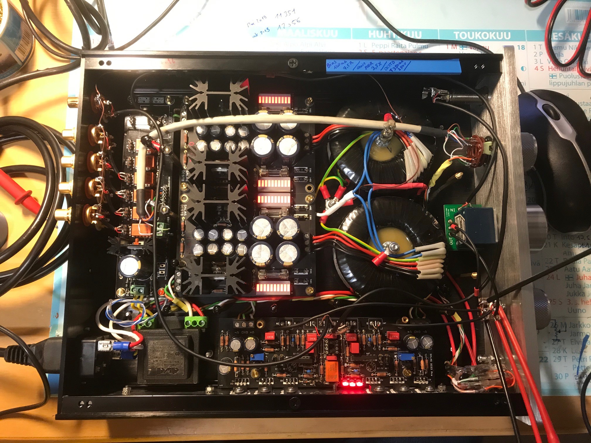

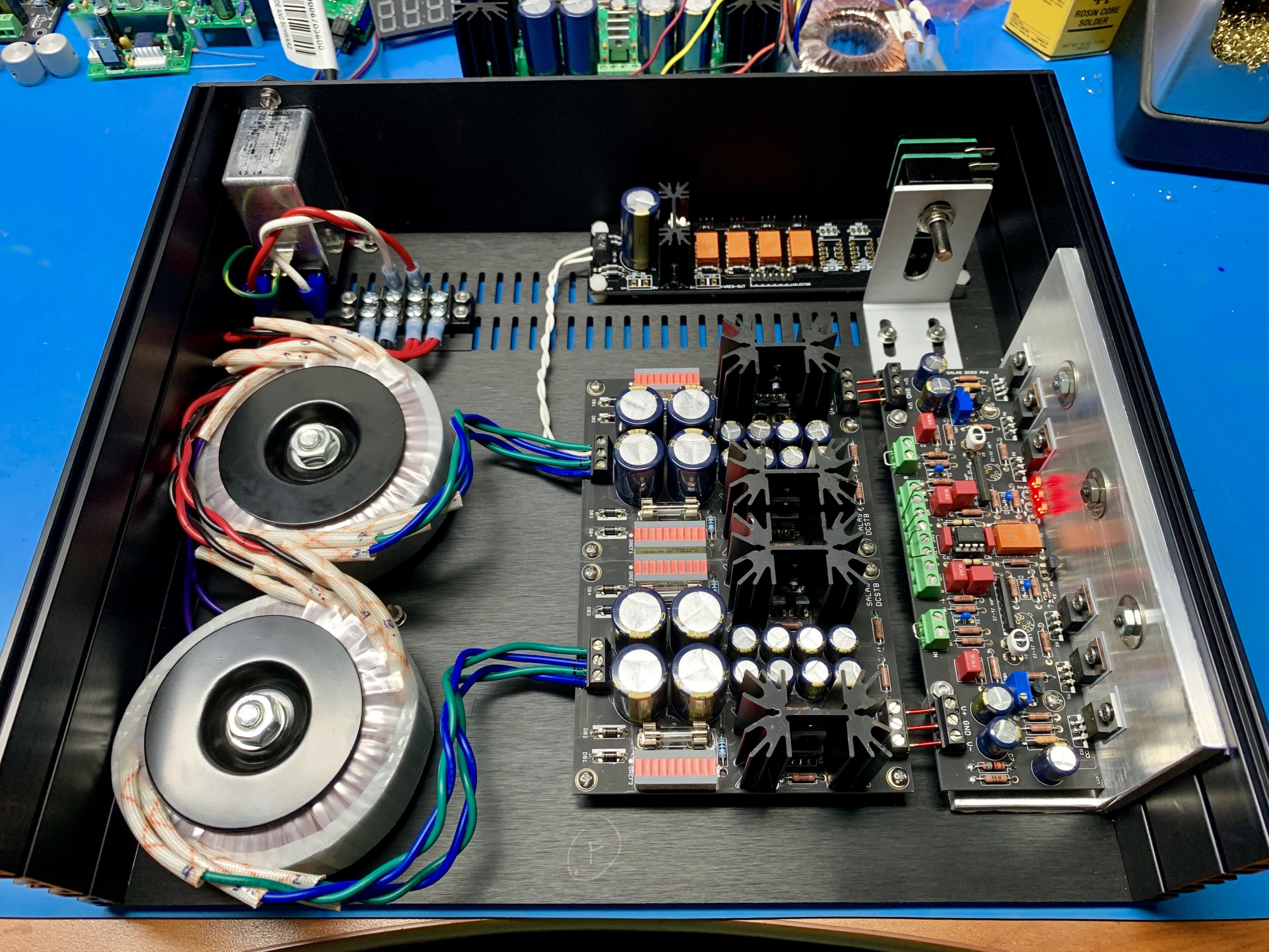

This is my first ever build and it went pretty smoothly. Well, the case could be bigger, pretty tight fit now.
I have BC327 mirrors and some critical resistors are Vishay RCK02. I first used series stepped atteunator with Welvyn resistors, but it was a litle bit too tight on higher frquencies. I put my trusty ladder type pot with Holco H4 non magnetic resistors and now its as I want it to be.

Good job. Congratulations. This preamp thrives on a good & well suited pot indeed. It does not have spots for expensive coupling capacitors because DC anyway so there is only one major place to spend for a better than average part, the pot. Some strategically placed Vishay Sfernice foil resistors you used did not hurt either. How many kΩ nominal is your ladder attenuator?

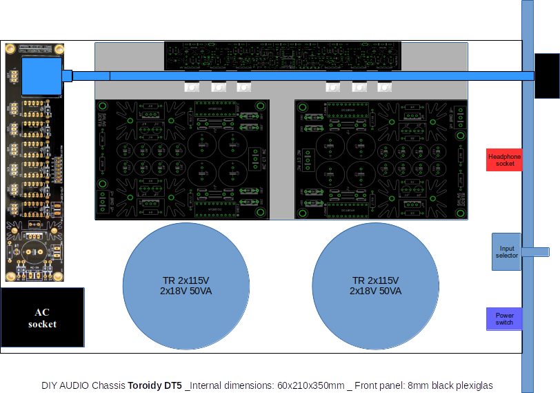

In point of fact the DCG3 board would be vertical with the mosfets in the bottom, with screws going through mosfets-flat heatsink; with larger holes in the bottom of the case in front of the mosfets in order to reach the screws.
Got a toroidy DT5 box when ordered the transformers, trying to fit DCG3+2DCSTB+iselect+2transformers in its 350x210x55mm.
Saw some pics with the audio components near the transformers/power lines, would like to avoid that, even if no noise/humm/etc. was reported (https://www.diyaudio.com/forums/attachments/analog-line-level/807257d1578341443-salas-dcg3-preamp-line-headphone-q1-jpg).

Here is a pic, likely easier, the grey shape is the flat plate/heatsink:
I see the sketched volume extension rod going all the way to the back passing over the Mosfets.
See it not to block easy screwdriver access to their tab screws from above in the practical build.
What pot model are you planning to use by the way?
Yes, good point, in the sketch the extension rod is blocking the access to the screws for the mosfets. There will be some way to play around with the final positions. The best way would leave the access free, in the worst case the rod will have to be removed in order to access the screws. The DCSTB will also be symetrical, I copy/pasted the same one in the sketch loosing the symetry.
The pot will be the blue ALPS one, forgot about the value though, 10k or 20k.
Back to the rod, even if the final box is supposed to be in metal and grounded, it looks like an antenna. Wondering if some people are using something else than metal (hard plastic rod?).

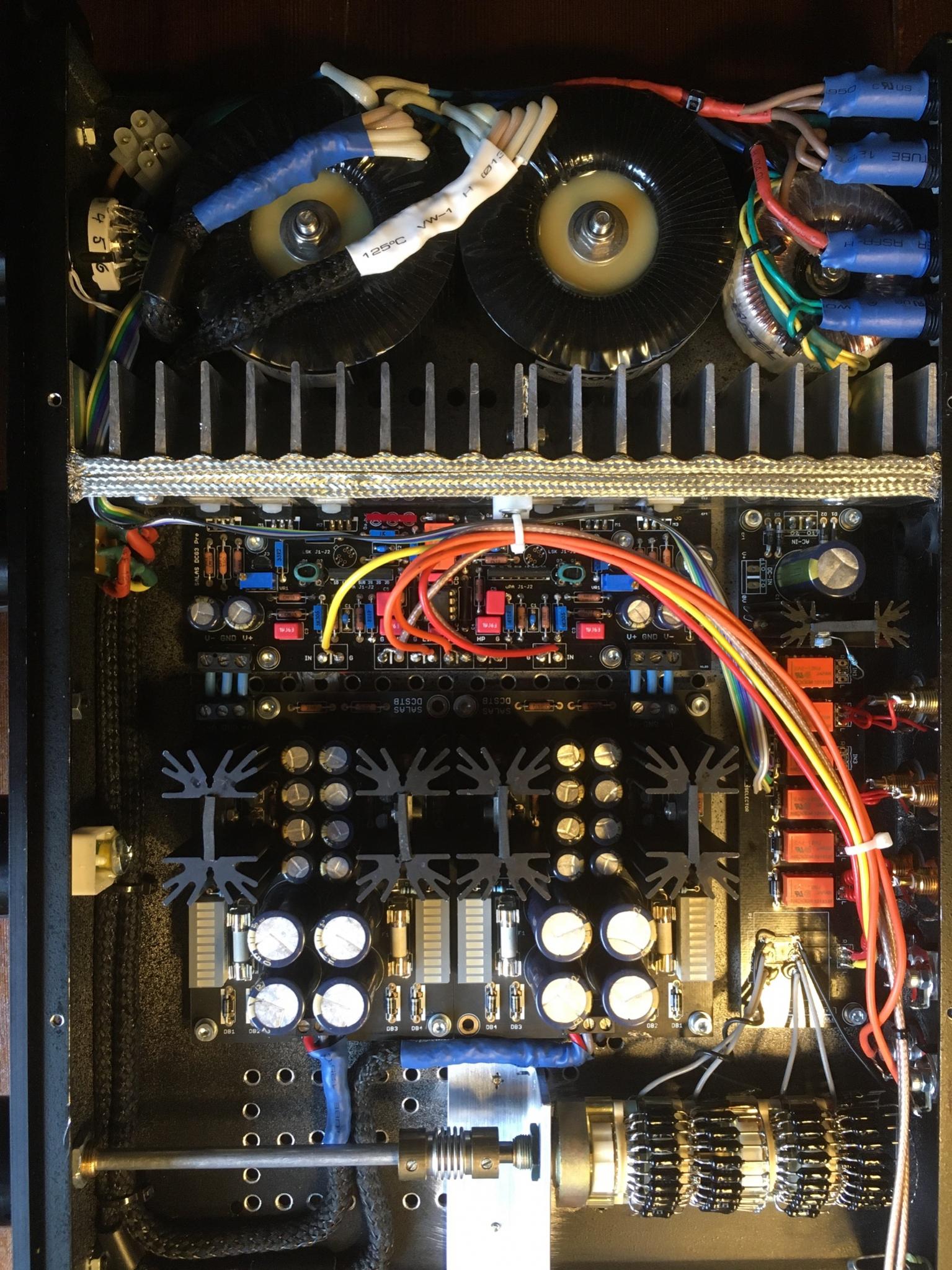

Best practice is to make a metal bracket for holding any type of pot placed next to the In-Select board. Or in front of it. It will both allow type experiments and automatically ground the metal bits to chassis. It will also hold the mechanism firmly without passing stressful forces to pins. The pot's pins can be wired with short runs to the board pads. Such brackets can be seen in many builds here.
