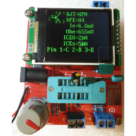

Regarding the BC327-40 update in order to replace the 4x BC560C,
Did not find anymore the post explaining how to measure the hfe in order to get pairs (?).
Already went through the whole thread once.
To measure hfe you either have a DMM that also does so or a semiconductor identifier / tester. There are very many dirt cheap "transistor testers" on eBay and AliExpress capable for the job. They also measure resistance capacitance & inductance in many cases. Absolute accuracy is another matter but alright for matching parts and identifying unknowns or simply testing for good or bad. Either offered as naked board or enclosed in cheap plastic cases they are mainly of this format.
My DMM does not have the tester for transistors.To measure hfe...
Saw these on ebay, sounds like a GO 🙂
