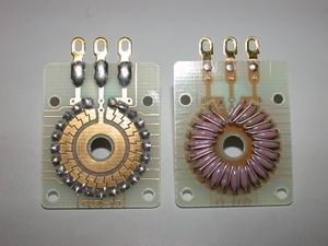

#5 because good Zo confirmed. Guts look good (pic attached). Good sound reports confirmed. And my mind is very biased for the japanese quality at the moment.
#7 If 10K ladder is the equivalent to 20K series then it ticks all the technical parameters boxes. Attractive price in this range.
The one in the pic should be #6 series stepped TKD 2P-2511S. Looks like having true resistors inside. Just 21 steps. Not that good stepping when with sensitive speakers. I know from experience the #5 2CP-2511 quasi ladder one with resistive film sounds clean and warm, about the 2511S I don't know. Never used it.
