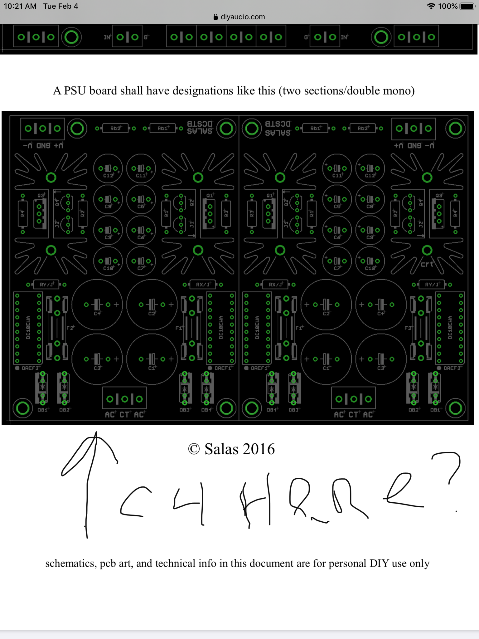

Beautiful work katopis! What a great build. I am building my second now using a similar chassis but everything will be mounted to a 1/4 inch Aluminum plate that will act as heat sink and bolt into chassis as a unit. Where did you tap dc for your input board. Large caps on power supply? Thanks mark
diyAudio Chief Moderator
Joined 2002
DC source in vicinity for feeding the In-Select board is about 22-24V found at the legs of any positive side 2200uF capacitor at the DCSTB. Preferably from one at the left hand section.
The In-Select board has DC input configuration option as well besides the fully independent AC configuration option with own transformer or individual secondary. Has own PDF guide describing all configurations you can use.
C4 on this side?

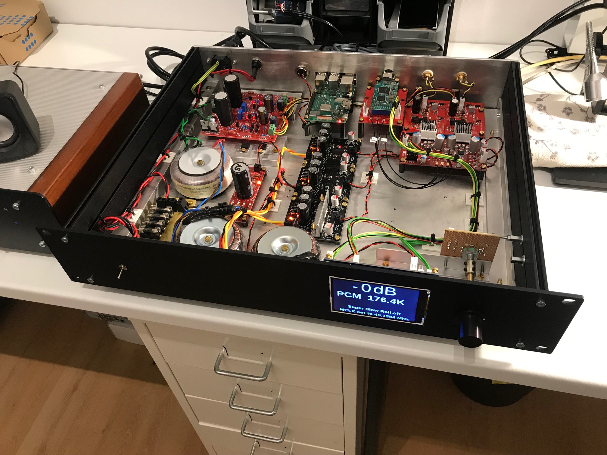

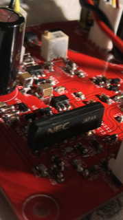

I've played all music via an good PiHat DAC, until i found DimDim's dual mono AK4490 DAC, which i entered the build around 2017, and finished 2019; the build was two year as i had to collect all the special stuff giving me the right conditions to solder and handle SMD stuff and like... Well i must admit that i did doubt if i would gain anything building this DAC, as my minds keept telling me that bit was bit's, but He.l not the case; every detail opened up, till even more 3D soundspectre and lots and lots of detail too, both high and low... This DAC is for sure the finest thing, and i don't think i will ever get something better digital thingy ever in my system. The output stage in the DAC is classA, also with the nice NEC transistors like in the DCG3 pre. ;)

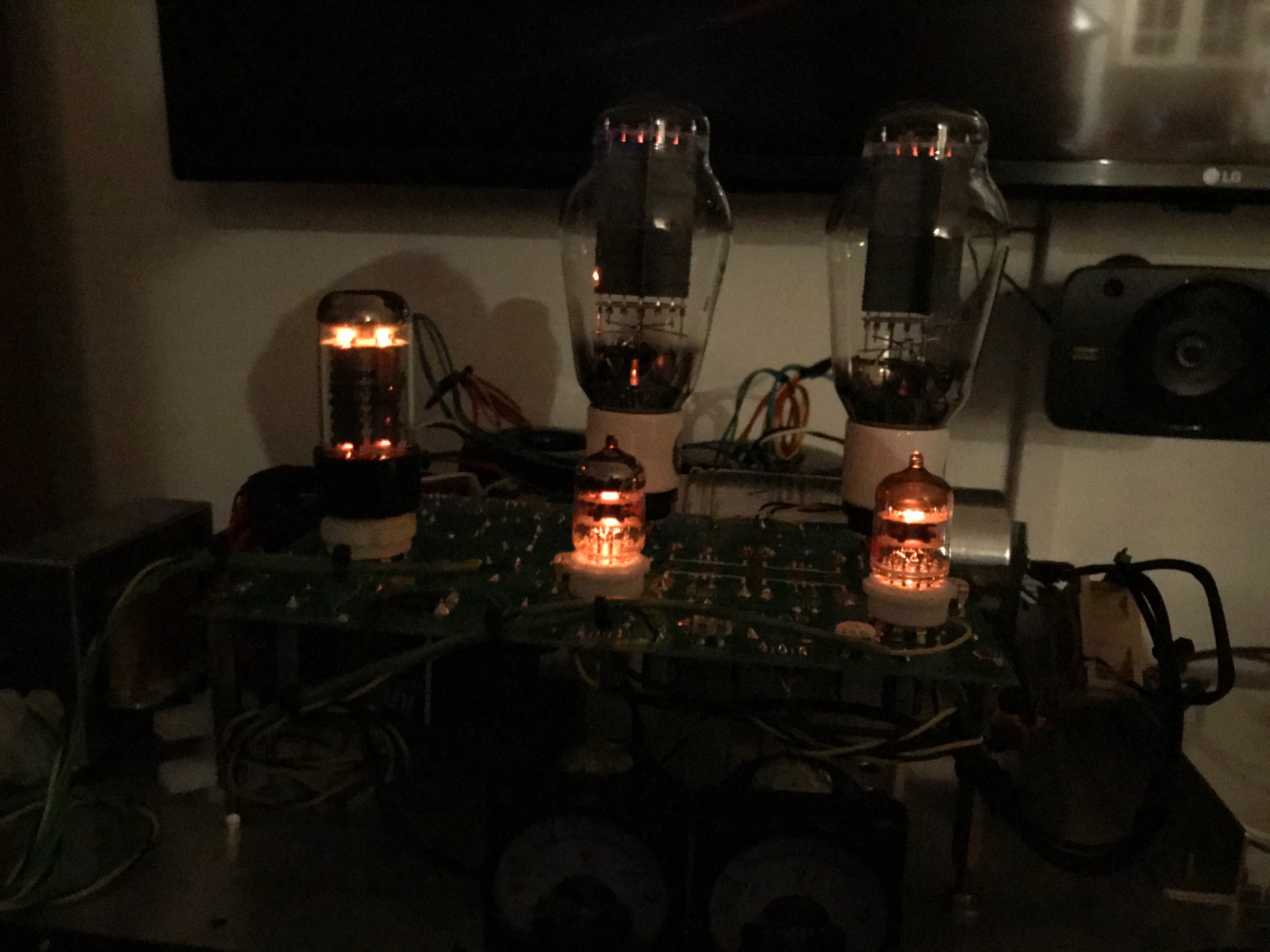

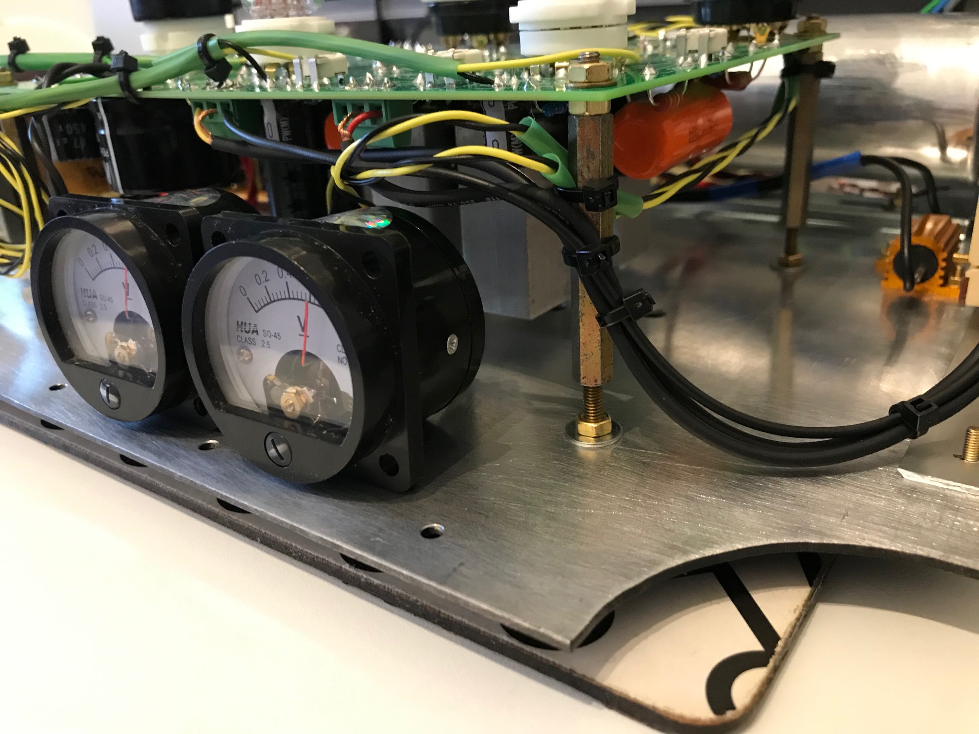

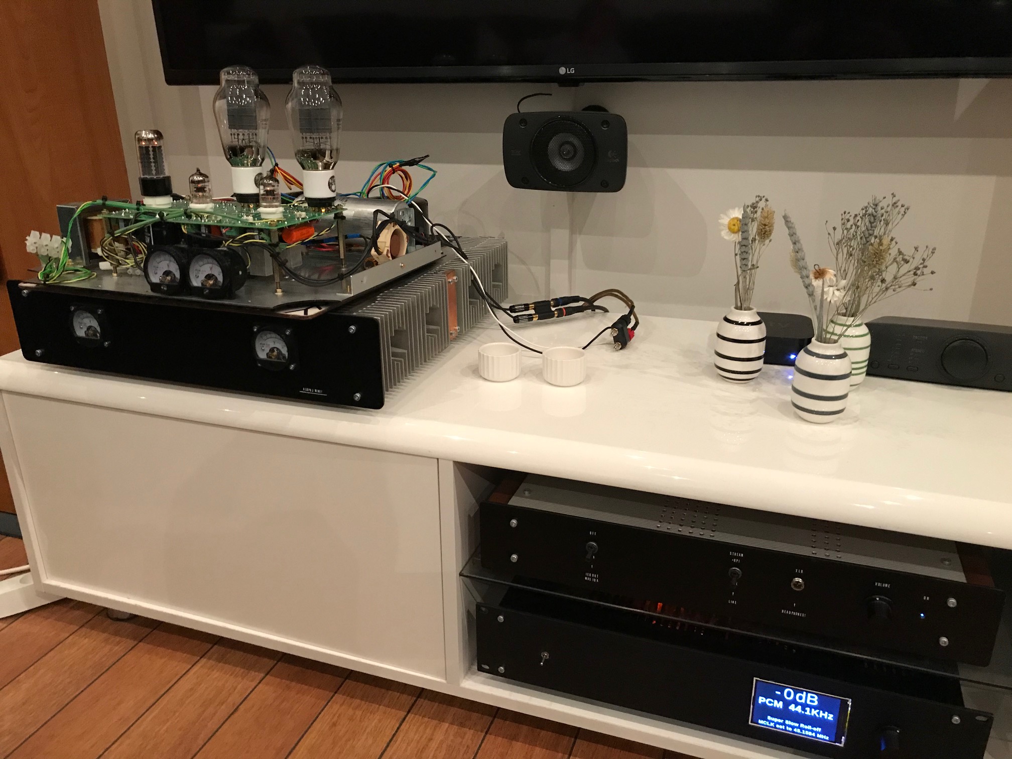

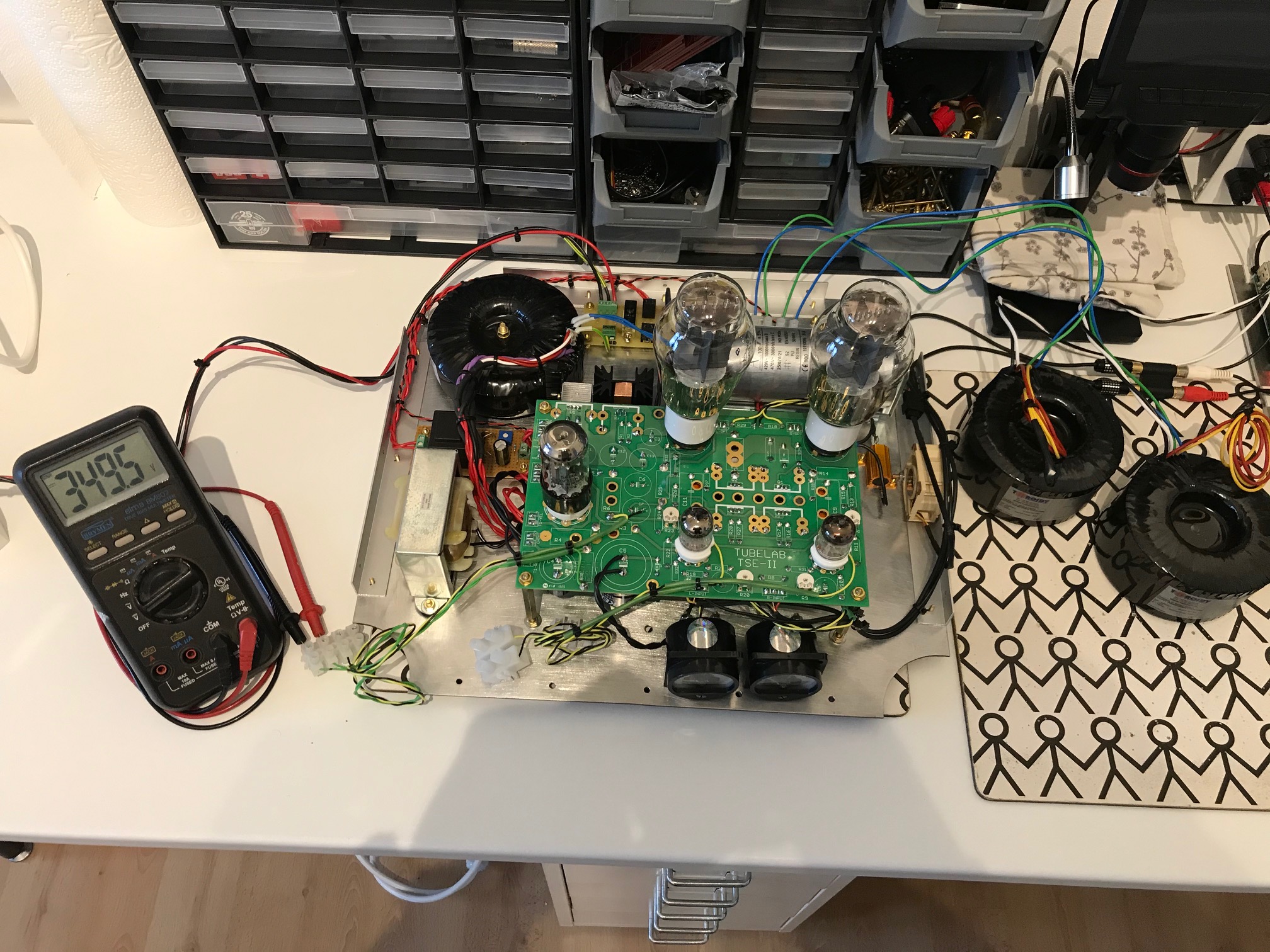

So lately i started my journey into the tubes-world, this build (not finished at all) are also taking months+ as parts are pretty expensive, but it's all bough and build up and lately i started listening to it in my main stereo downstairs :):)... temporary setup only.
What i started with was connecting it up directly from my SuperDAC via 50k alps potmeter and into the 300b SE amp... whoow, gain was good enough giving plenty of volume to my 90db spk's... After a short listning i connected it through the DCG3 magic_thing :D, and same phenomena appeared again, more life into music, yeahhh !
I will compare the Aleph mimi to the new 300b se, but briefly i liked the 300b sound, i don't think sound is better but different from the Aleph_Mimii guess, but this will go in another thread not stealing Salas's...
