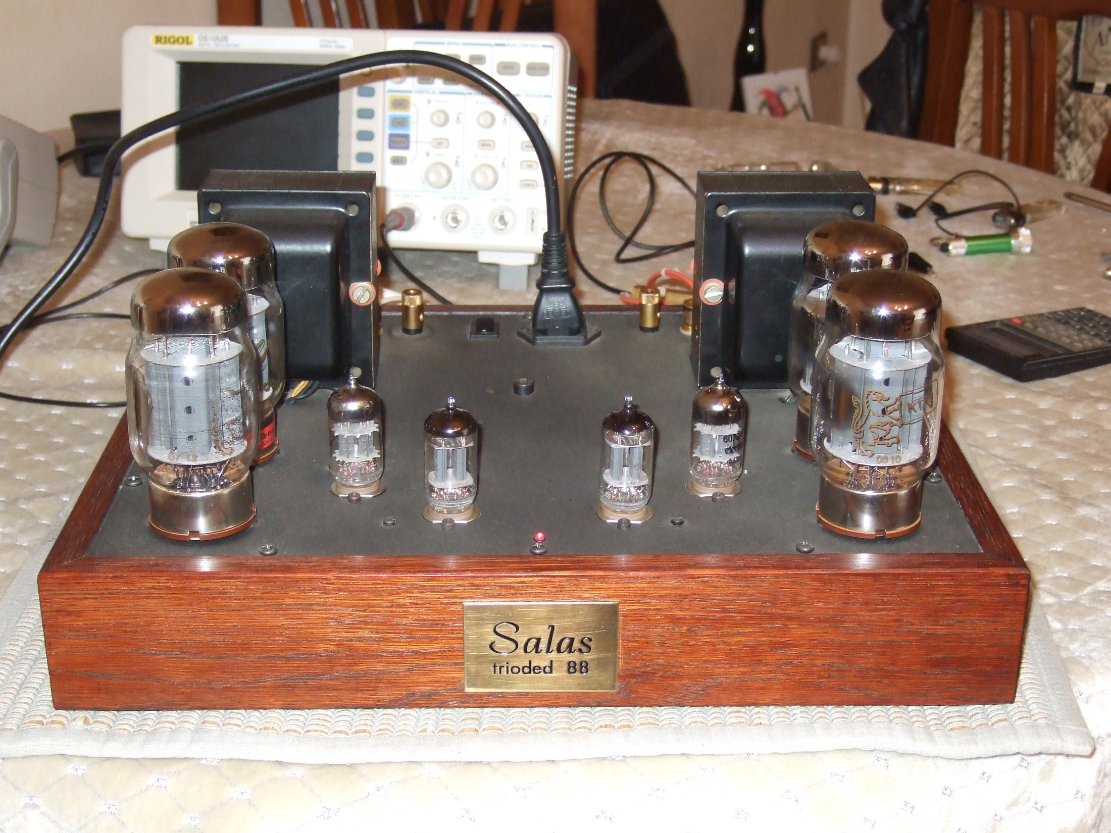

Salas how you didnt desing a power amp so we are going to have a SALAS complete system?
A question I have been wanting to ask!
There was a KT88 trioded tube amp I had actually designed
Many speakers also. Including professional installation types
Anyways, for electronics I generally designed what I missed or to put interesting or expensive lying around parts in use. Power amp solid state designs are so proliferate and accessible that I always had something satisfying on the rack. But I may try my hand on one sometime too just for grins

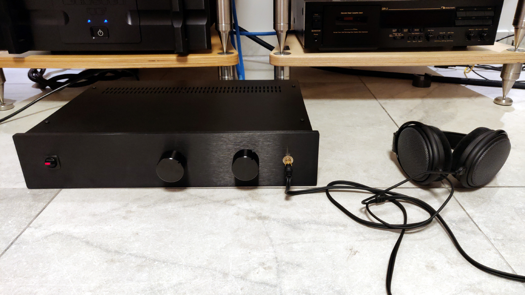

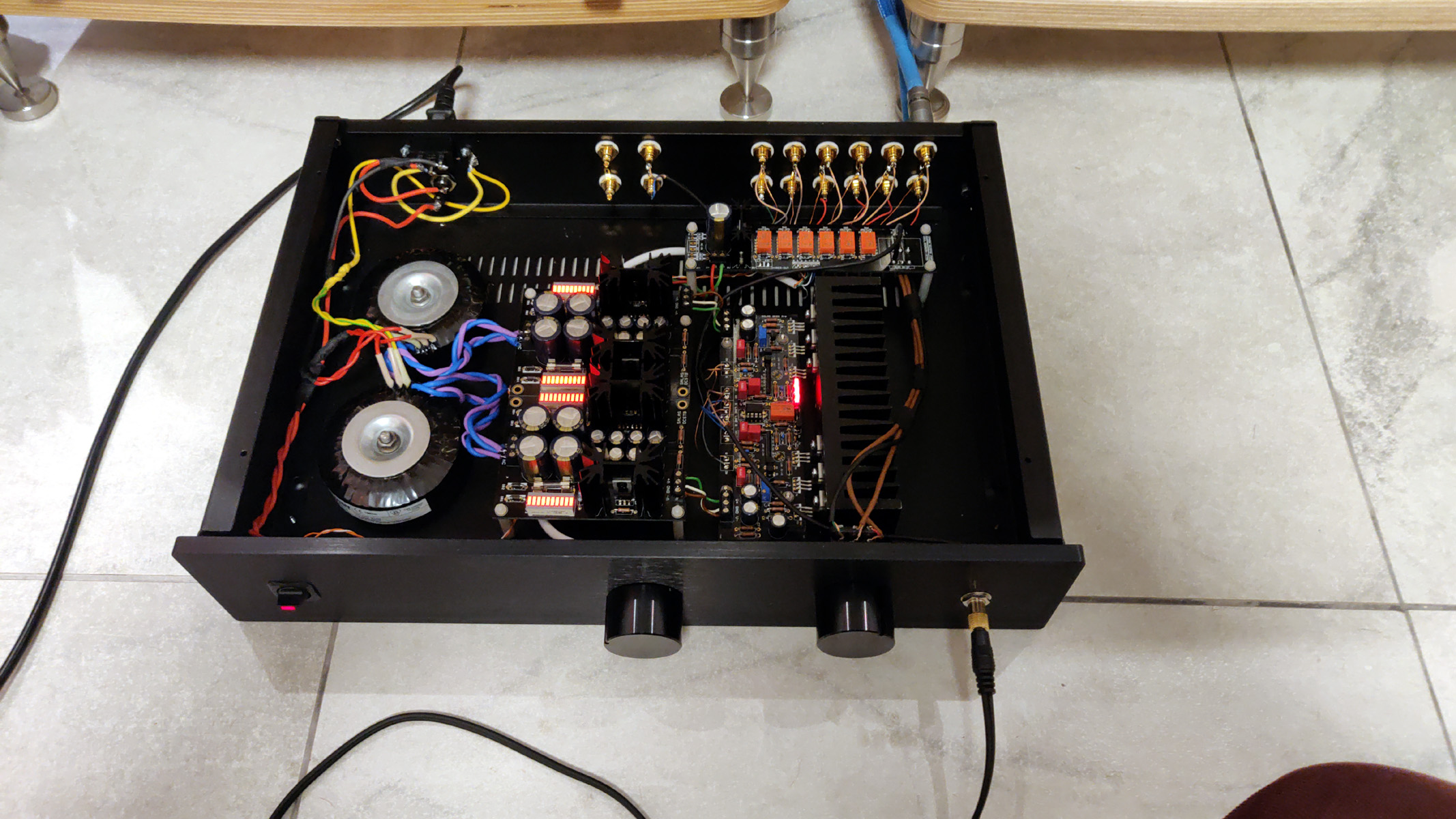

Hi! I want to show you my second dcg3 which I made by myself. The first one i did not make all by myself.
It is a "by the book" version that works flawlessly, I mean no hums no buzz, dead quiet, sounds wonderful!
Many thanks to Tea Bag and of course to my friend Nick for their precious help.
I used two toroidy transformers and a 20k log pot from tkd.
The input selector is Salas and the power supply is dcstb.
It is a very accurate,wonderful sounding preamp for my second system that is driving benchmark ahb2 amp and blumenhofer fs3 horn speakers.
The other one dcg3 is a balanced version with khozmo pot that is driving bryston 4b cubed and my pmc ib2i monitors.
