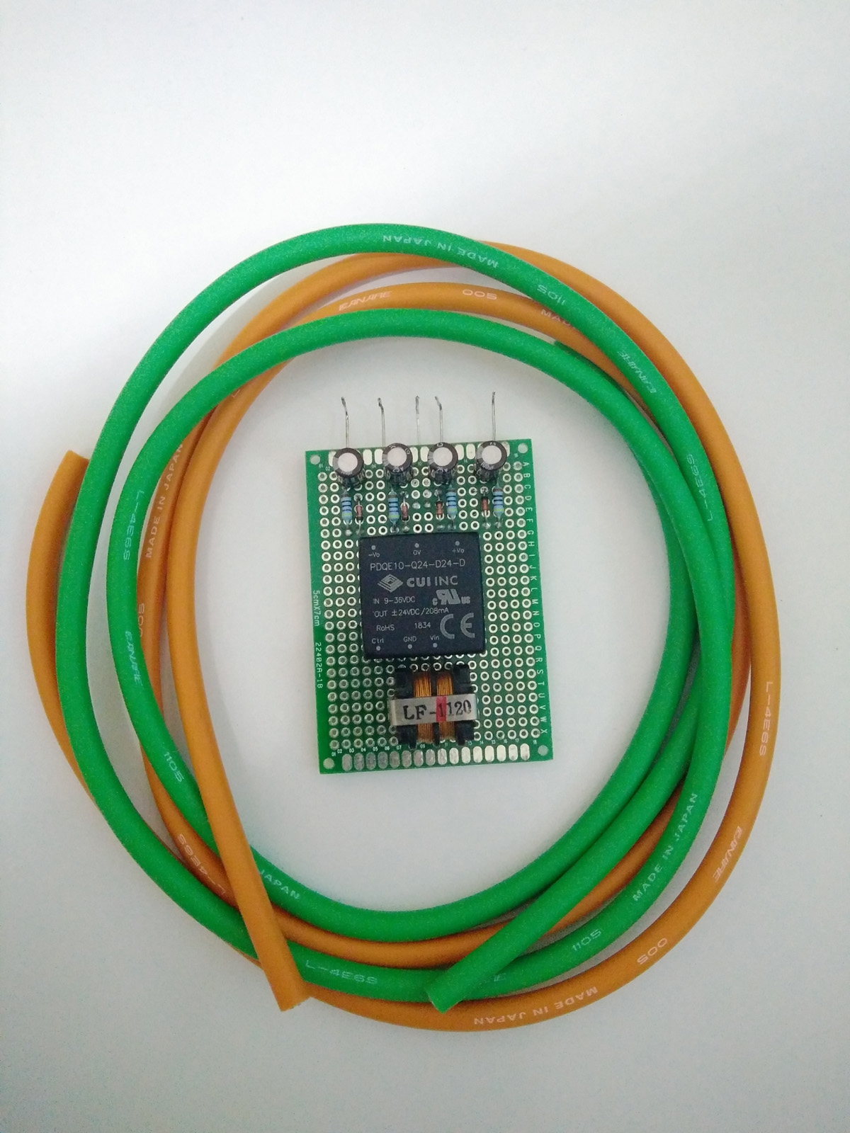

This is the cable from the video. Canare L-4E6ES. I mainly use it for umbilical between PSU and MC phono boxes. For signal at home its better to avoid the highly capacitive star quad cables if there is not a specific interference source crossing the interconnections that you can hear with normal ones.
In the photo there is also a switching DC to DC bipolar converter board I once made. I used it for powering a differential input chip phono I designed for lab play. In collaboration with a plug style switching adapter so it could be remotely placed on the wall. Thus no transformer and no AC power cabling near the audio circuit.
Goal was to avoid any mains related magnetic field interference around such a high gain & low input signal circuit with the least of expenditure and space.

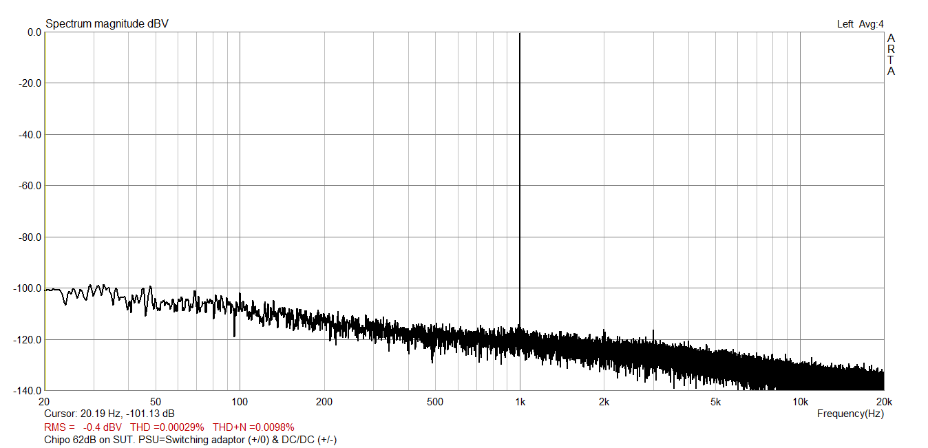

And I did. No hum spikes for 62dB 1kHz gain. But there was a gotcha. The SMPS noise generated beyond the audio spectrum came back integrated and more than doubled the audible hiss. Weak sound in lower frequencies too. Fail. :D
Just like when you don't use the 20MHz limit button on a few hundred MHz scope and its line is fatter than a slower cheaper scope. Because noise appears over bandwidth and comes back integrated as a total mV number. The wider the bandwidth the more there is. It can be low per Hz but when the Hz are many it adds up.
Moral of the story is you win some you lose some. Something working great in a specific area isn't necessarily great in all areas.
*Because of RIAA curve there is 40dB gain difference from 20Hz-20kHz. As reflected in the plot's grass tilt. So hum frequencies are even more promoted to be picked in a phono.
*I used UBiB in the end to avoid the hiss and the weak SQ.

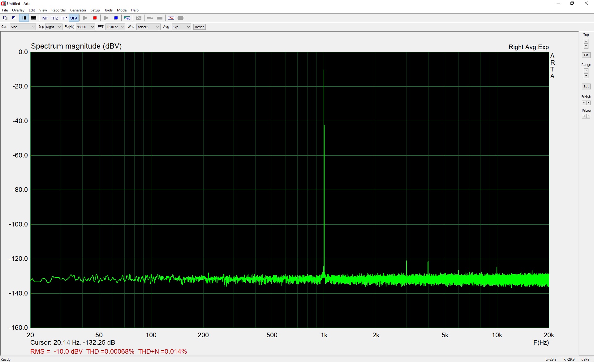

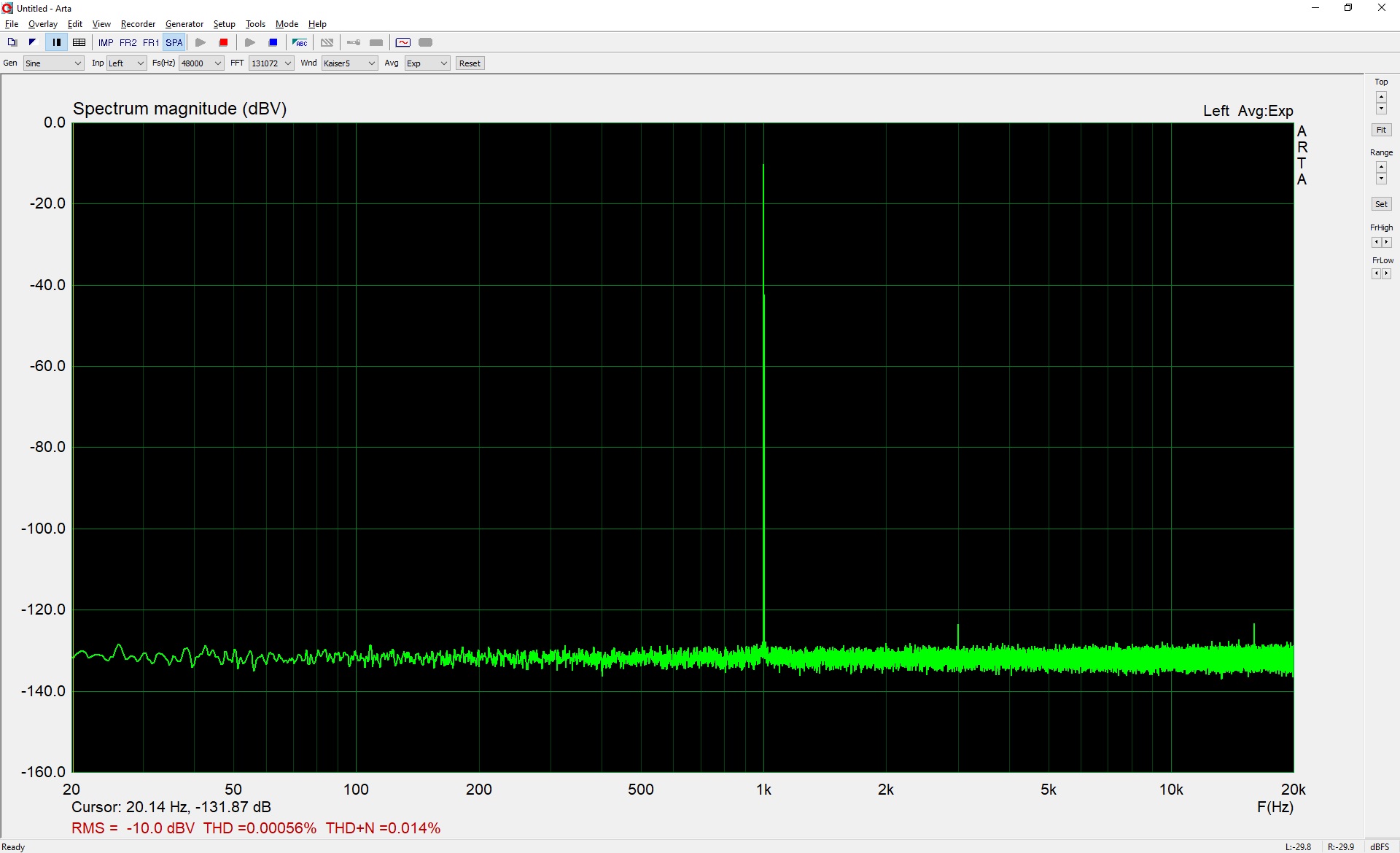

My just arrived Mogami cables are quite and I see no picks at low frequencies at all. Totally flat there and I’ll attache ARTA images soon.

Don't use SMPS in a phono, the example was to show you may avoid hum field with such when no AC cables are around too but their hundreds kHz switching noise can come back as hiss especially in high gain circuits. Because SMPS small hum field benefit was mentioned in the video. Then again all the adapters he used to demonstrate strong interference were SMPS too. There could be very good ones well filtered and screened suited for line level. Like the one in the pro DAC he showed.
Still enough people tend to prefer L-Adapter linear stabilizer for instance when replacing SMPS bricks even in non interference problematic gear anyway.
That DC/DC in my example came handy to convert a single rail SMPS adapter in a specific situation. Wouldn't be there if the wall adapter was delivering +/- to start with. There is variety.

Please see my test results with new cables attached.

Congrats for cleaning your loop. Now you will know your DUT's own harmonic noise spikes with certainty. The interface's own THD, SNR, crosstalk etc. are not that stellar to can see some very linear DUT's pure performance but still very useful. Ap would be out of business otherwise.

I kind of surprised too and see no change between Focusrite 2nd gen. vs. 3rd one. They claimed that 3rd has a way better spec and noise floor is below 140dB. Maybe I’m not doing right measurement setup, but I do not see that improvement.
I calibrated ARTA and 10dBV is set it to about 130dB scale, same as I saw on my 2nd gen unit. Driver and device utility is nice, but I got no complaints about 2nd get unit on Win 10 without that utility. Marketing lesson...
