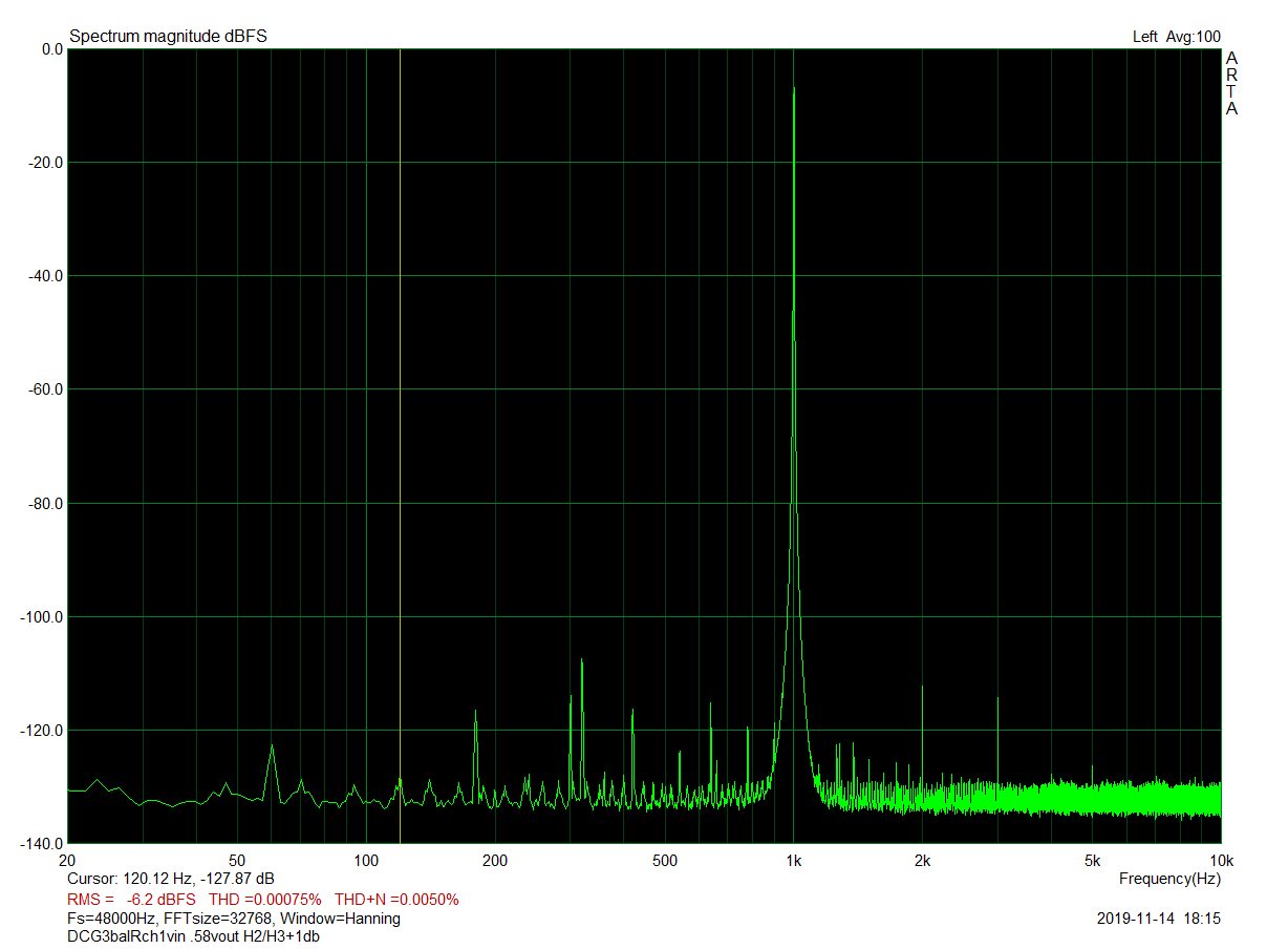

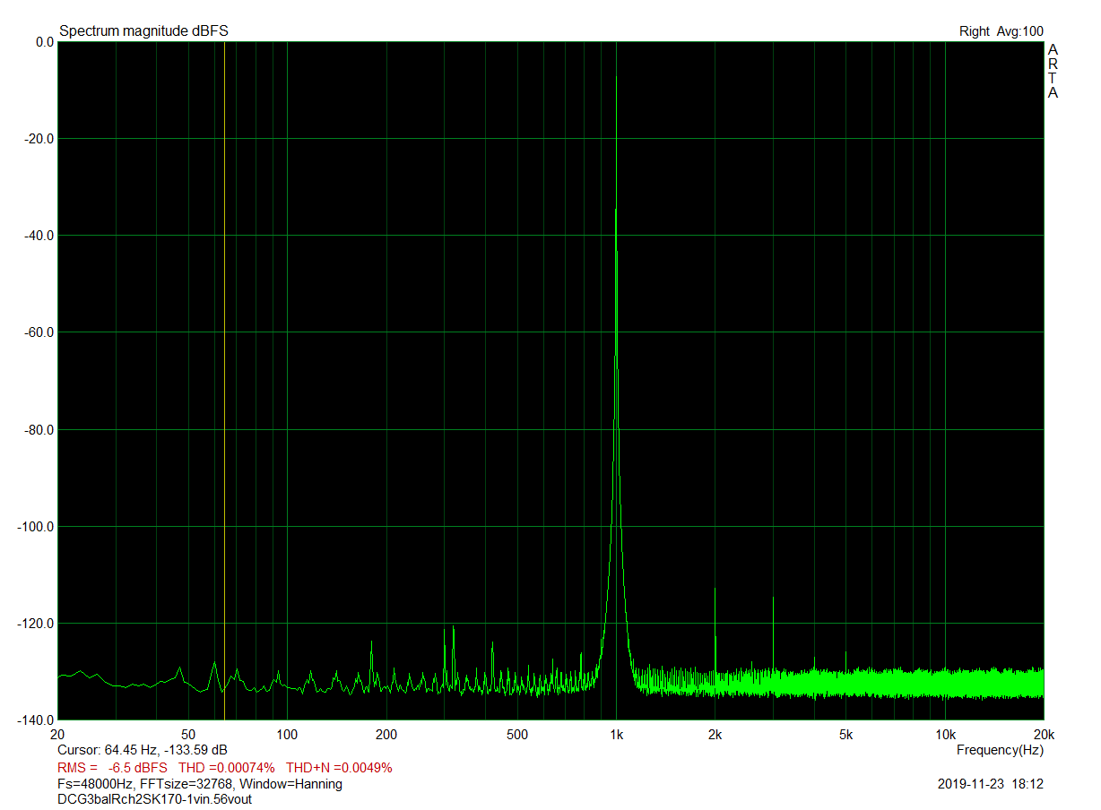

Attached please see two FFT plots. Both were done at 1v balanced in and 0.56v out using Focusrite/Arta The left is the UPA68H and the right is the 2SK170BL one. In my last posting #4041 I had shown an FFT but it was done at the default FFT8192. Now here as per Salas's suggestion they were done higher at FFT 32768.
To my untrained eye, except for the spikes under 1k(more on this later) the plots of the UPA68H and 2SK170BL look identical. Ear to tweeter test a slight reduction in hiss with the 2SK170.
Salas I isolated the spike at 320hz to the safety ground connection at the IEC. The PEM is a Schaffner with filter built in. When I pull out the wire to G at the PEM the spike goes down, reconnect and it goes back up. The left FFT with the UPA68H has it connected the right has it disconnected. I repeated the FFT for the 2SK170 several times, with and without the connection- without gave me THD+N of 0.0049% while connected gave me ).0050%.
Thanks.
nash

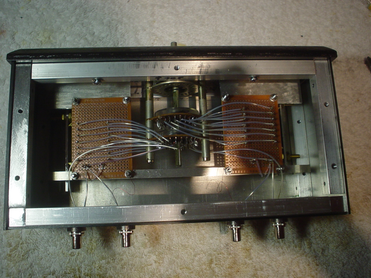

Yes, I have built it using two autoformers from Dave Slagle. I have only used it as a passive and this was after a Dale RN based passive. Compared to the resistor passive the sound was much fuller, stage bigger and a more enjoyable overall sound. Cant compare dynamics and detail retrieval to say the DCG3. Perhaps a DCB1 after it would really make it shine.
nash

Nice that you found the lower frequency spikes origin.
For THD looking the same between uPA & 2SK maybe the interface is at its limit and we just see its own?
Make a THD sweep with Arta Steps. There differences could arise.
Vgeorge I think in his #26 preamp. But he uses a ladder in DCG3. PM him if he will not not read this...
I used the autoformer at the output of the tube pre, in order to reduce noise and increase output impedance.
It worked really well in this position, but I do not think that DCG3 is the right application for an autoformer.
It is also, maybe preferred from a passive pre, due to the higher output impedance, at least when not in the least attenuation position. But of course you loose some bandwidth and resolution.

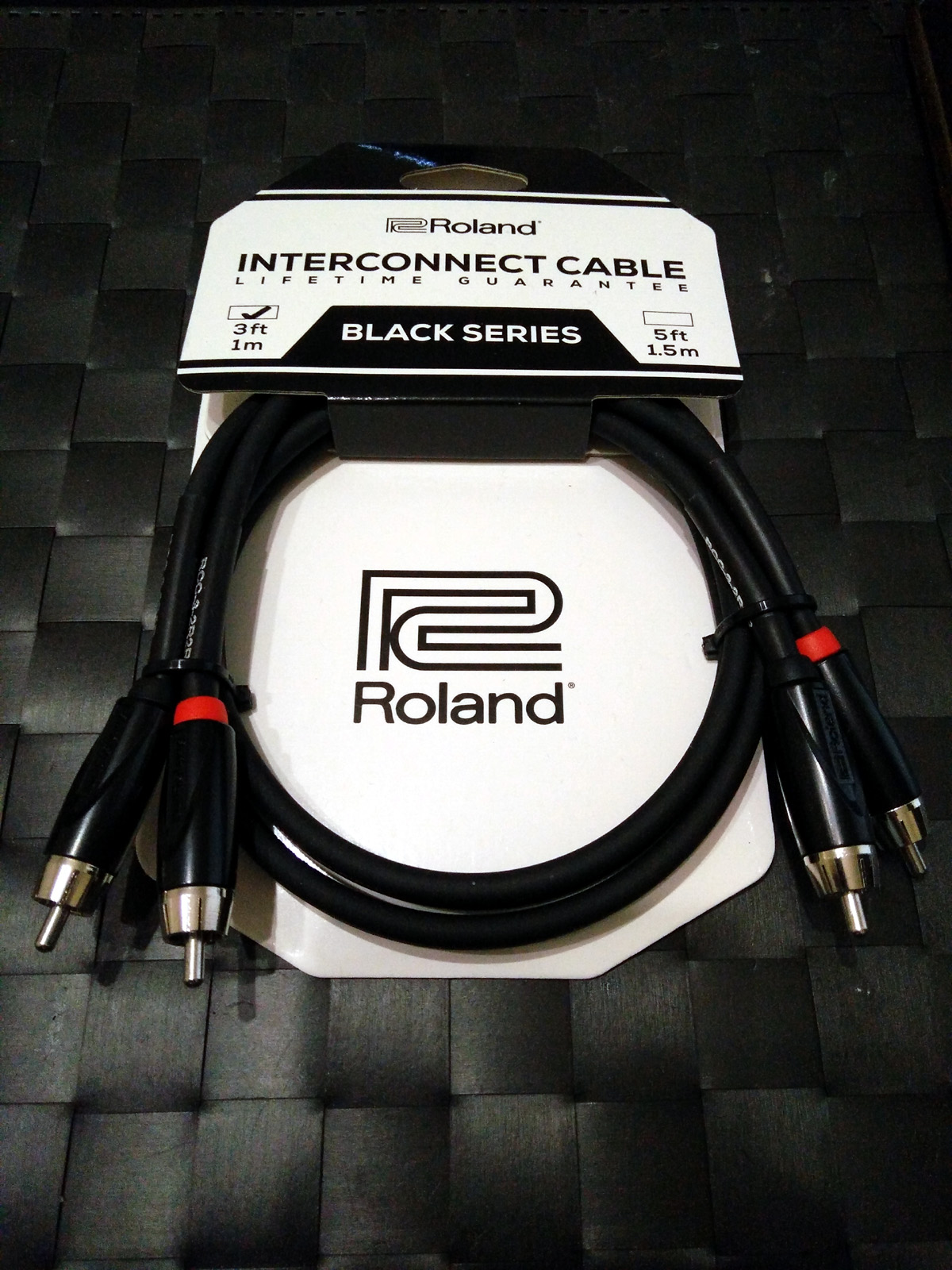

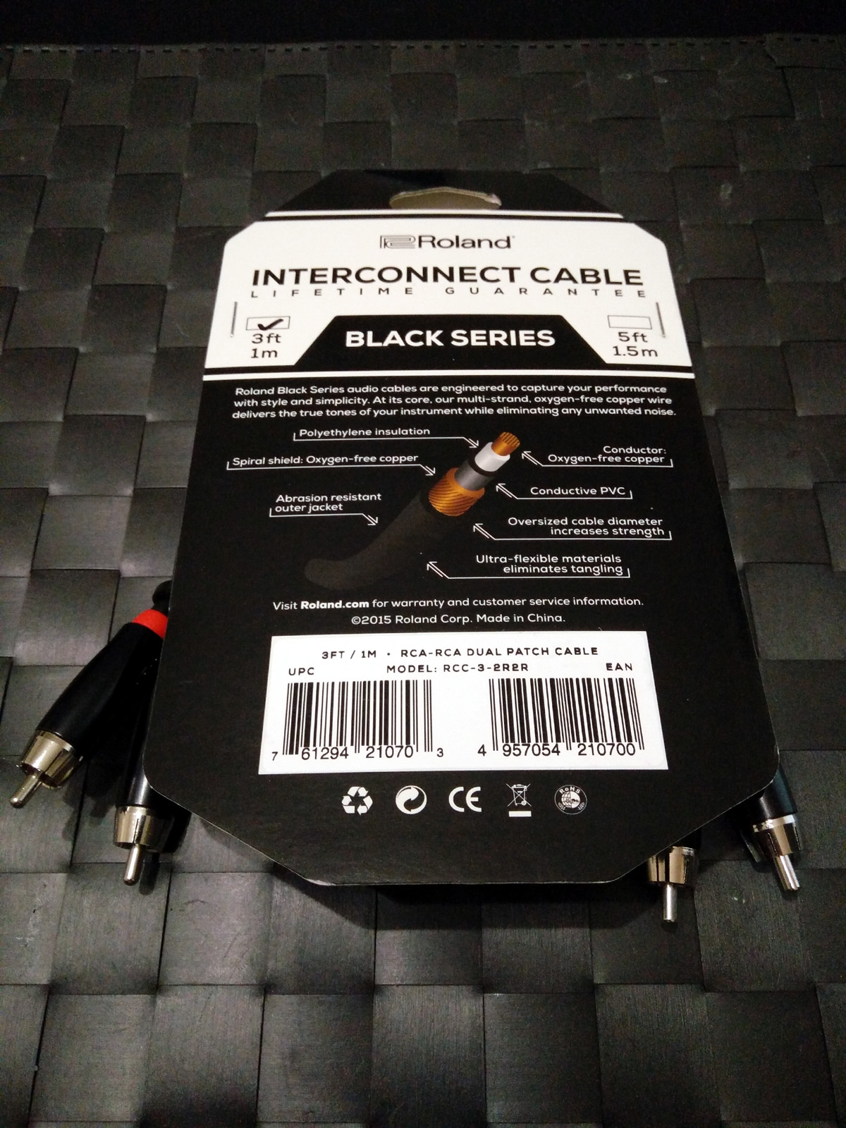

Cable tip
I didn't have any decent cable leftover lengths around for my deck but I had various male RCA terminals. While looking for Mogami local prices to get some bulk cable and terminate, I discovered that Roland offers decent quality ready made interconnects with narrow enough terminals to fit behind my cassette deck. Old gear almost always have small adjacent terminals clearance. My Amphenols don't fit, so I would have to use cheaper dubious terminals anyway.
Because the 1m Roland was below 15 Euro in a local music instruments store it wasn't costlier than making one myself with say Mogami W2524 Φ6mm guitar cable. That's how it looks inside on the package description. Like quality guitar cable. Other pro brands were far more expensive. So I thought to check one out. Roland - RCC-3-2R2R | Black Series Interconnect Cable
I measured 98pF/m at 1kHz on this terminated cable. Its very well made, soft, the bite on RCA barrels seems correct, not too hard but not loose. Its not completely separate runs, they attach together after 15cm from each end. Which is good for less interference by keeping a narrower loop area between channels. But they can also be pulled easily apart I believe. So I found it overall a handy purchase.
Maybe you don't want guitar cable with that extra anti-microphonic conductive PVC shield which is of no use in your home audio rig on the other hand. Mogami says its a necessary evil for noiseless stage handling not an enhancement.
