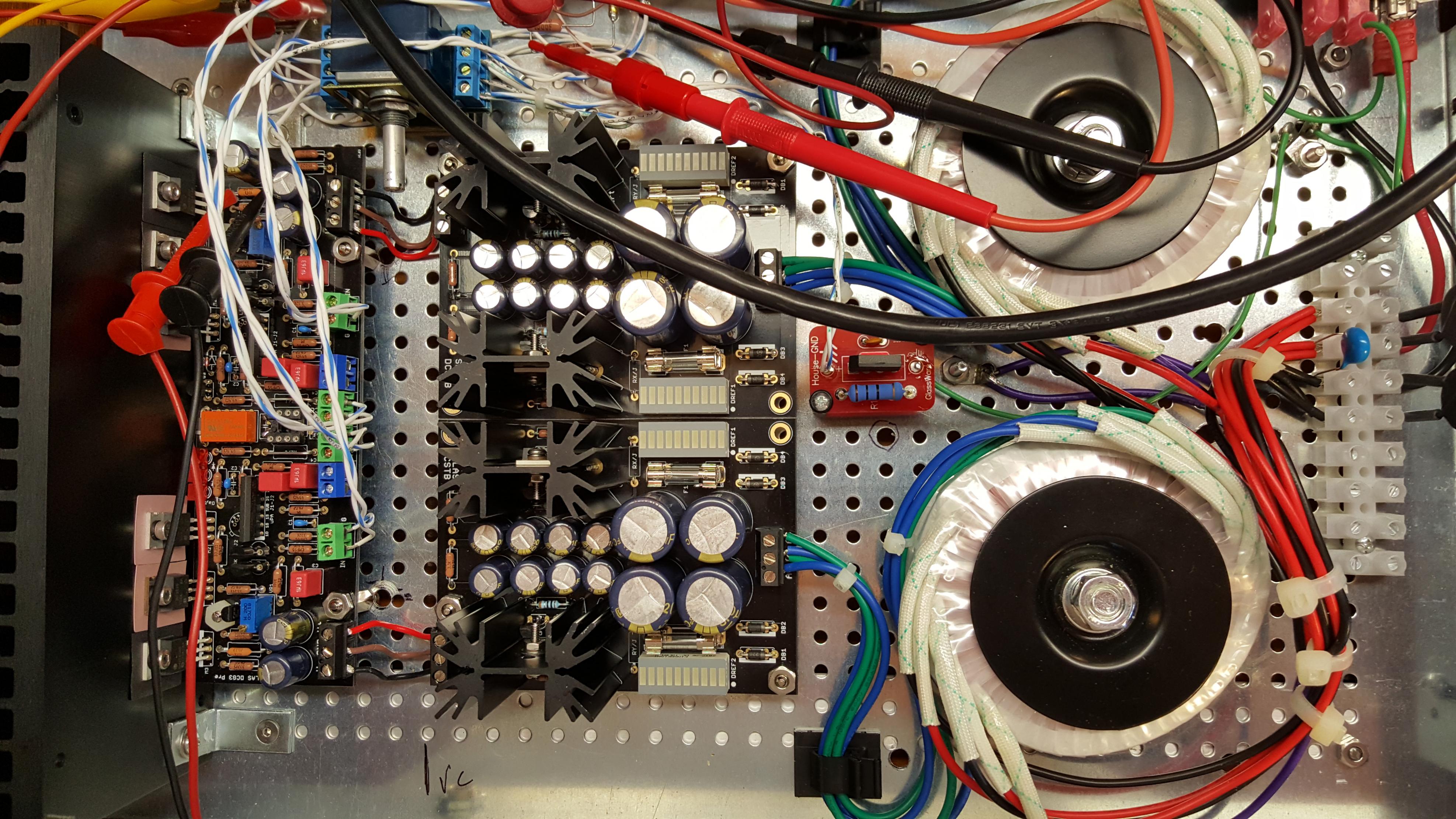

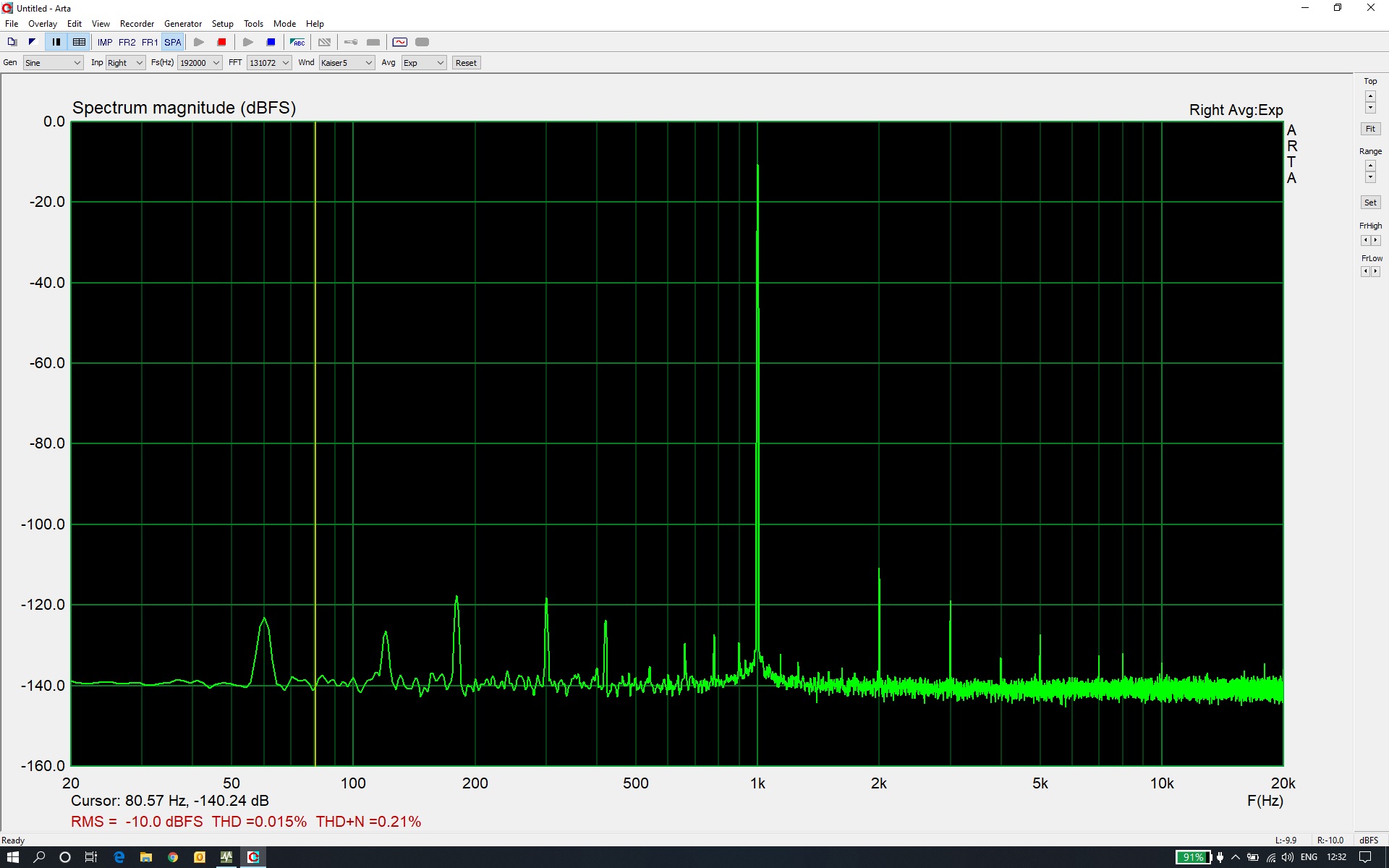

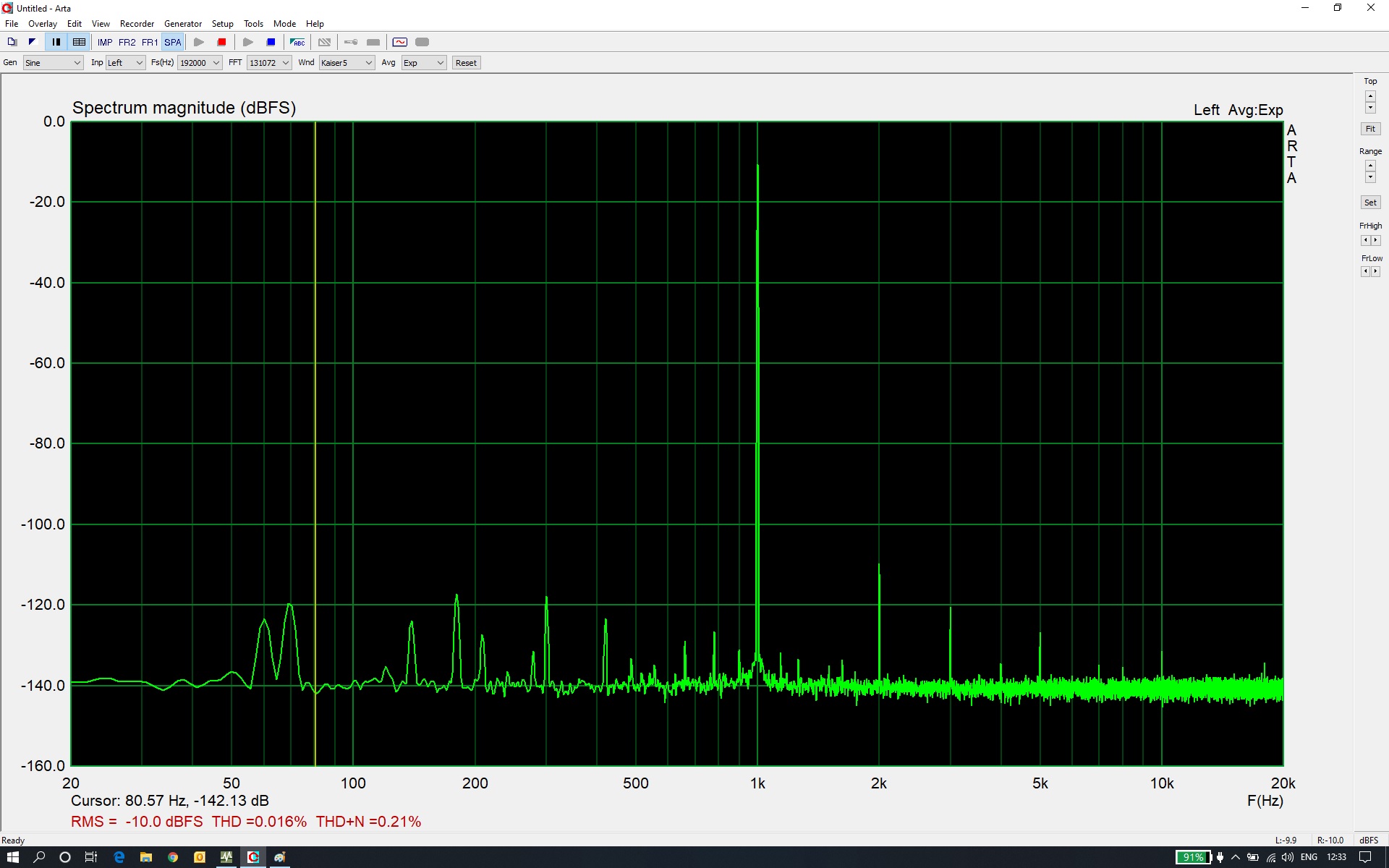

Hi Salas and all,
I think I'm done with my second DCG3 setup and fine tuning. SQ is amazing.
I use Khozmo Relay now and it is leather type unit with 64 steps plus remote. I also used new Focusrite 2I2 3rd gen.
Please see attached files for reference.
It is input gain difference between my initial test with 2nd gen and old attenuator vs. 3rd gen last test with Khozmo. 3rd get can’t go higher than -7dB, since otherwise it is in saturation.
Your old attenuator was obviously compromising things a lot vs your new ladder type. Was prone to gathering interference.
There are some 60Hz components producing harmonic noise to still try clean better I think. Not too high but you already did that a little more successfully in your other build. Why your ARTA charts can't match the THD results of your RMAA reports? Driver software issue?
You could calibrate with gen and scope the software + interface so to have dBV and not dBFS scale which is arbitrary. There is calibration menu procedure in each package. 0dBV=1VRMS when 0dBFS is whatever clipping roof some digital gear has.
I did all what I gained knowledge-wise during my first unit setup in order to reduce that 60Hz with it harmonics noise. It is still there... and BTW it is totally gone when I disconnect attenuator and leave inputs open on DCG3 PCB.
I need to see how to GND Khozmo attenuator properly. Since it’s GND L and R must be shorted and connected to its PSU 0v output. This is one join point of L/R GNDs.
My GND is isolated between L and R till i-Select when I use Apls potentiometer.
Maybe I need to mod my I-Select to separate GNDs too. At that way, I’ll have only one join GNDs point and it is on Khozmo.
Just got my new Focusrite and will calibrate it tomorrow. Thank you for tips.

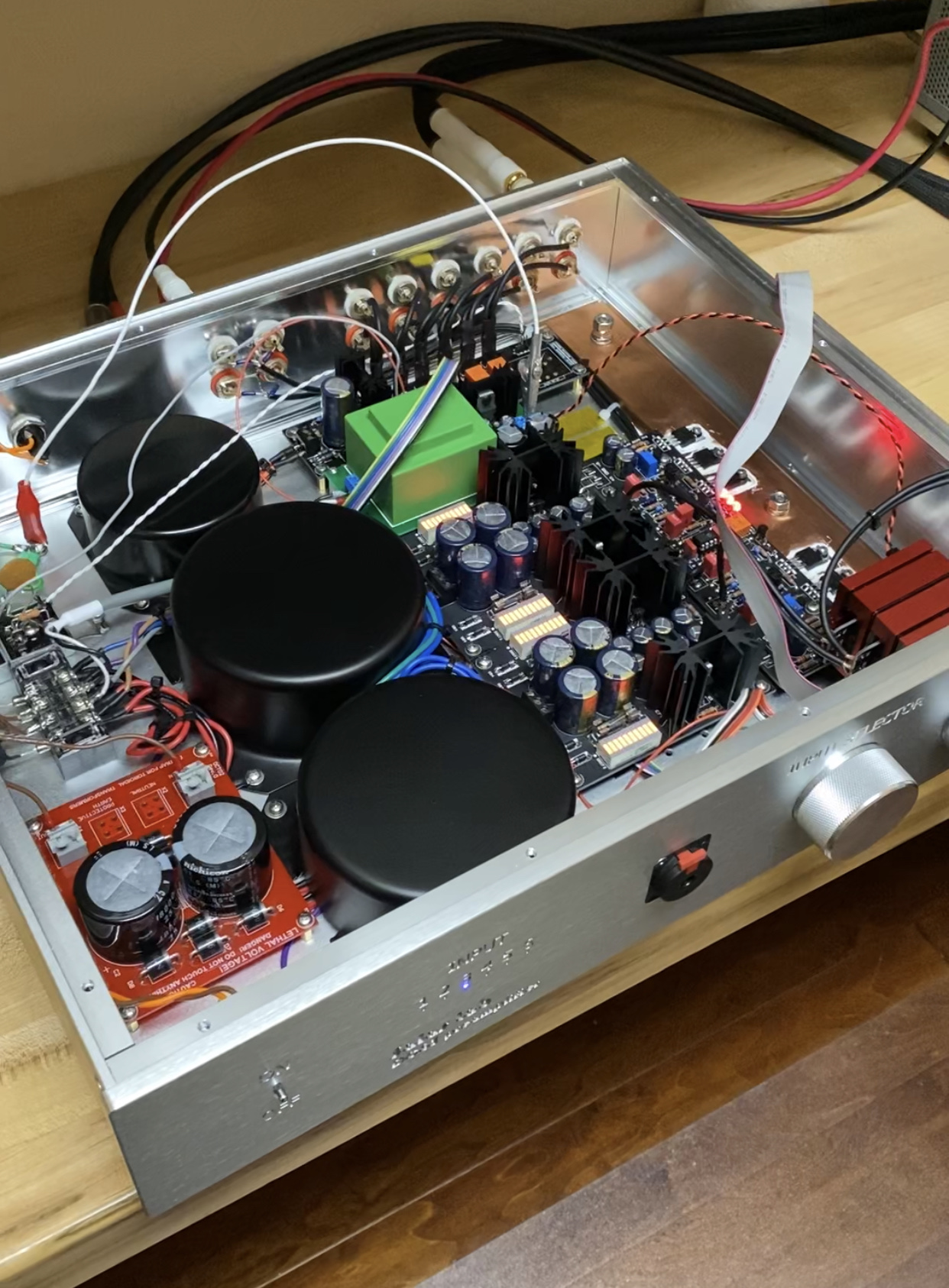

Hi Rush,
My headphone jack GND pin is insulated from chassis. Its body is connected to chassis, but not its GND. I actually run L/R coaxes to it, but only one coax braid is delivering GND to it. Both channels braids on the same coaxes are connected to GND on DCG3 PCB.
All tests are indicating that I have GND loop, but I can’t find it yet. It is no 60Hz spike at all when I disconnect inputs of my Focusrite or I short inputs
There is a chance that I am picking up some transformer induced flux since I’m using 3 toroids in that setup.
I guess that my next attempt will be dedicated to use of Mu Metal sheets. However, these View attachment 1
