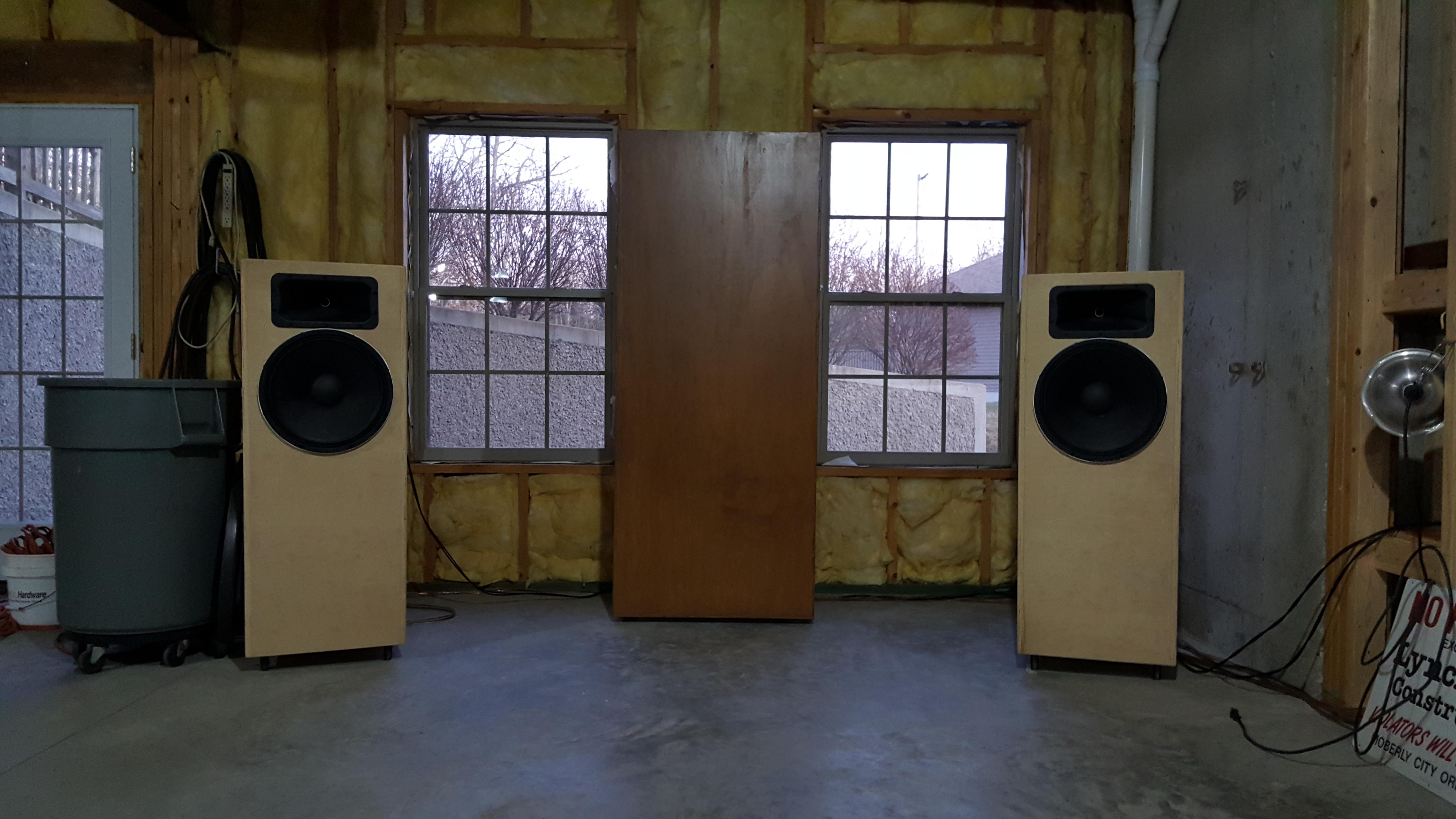

katopis I have a pair of yamamoto YS-500 clones I built from 6 moons review. that big box in the middle is a 12-14ft folded horn subwoofer driven by 500 watt class d plate amp. Yammie's are driven by Pass F4 on bass bins and Pass F5 on horns.
Now that's a system of proper scale speakers 🙂

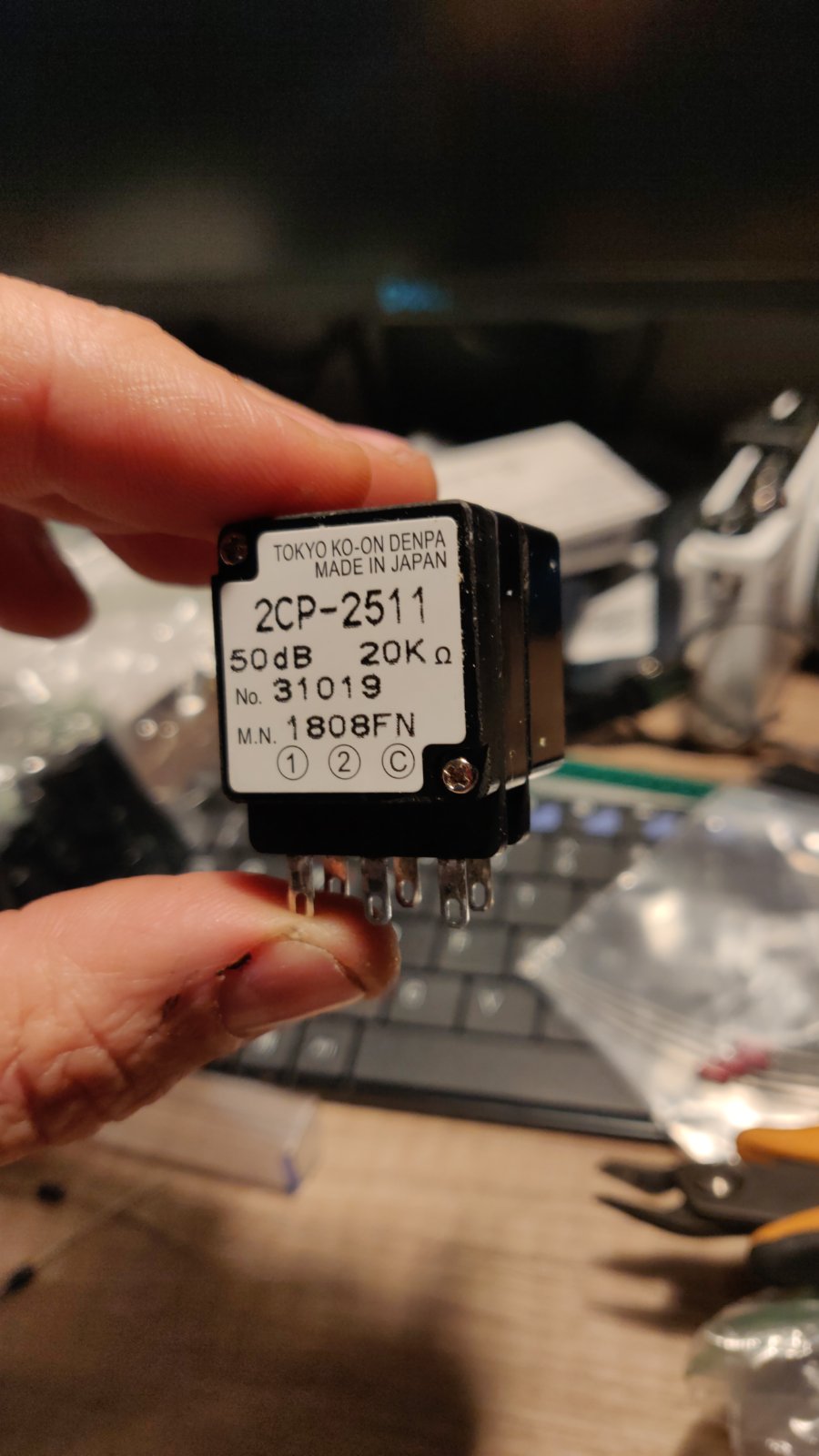

What is your now Alps Blue nominal value? Fellow builder killie99 mentioned replacing his Alps Blue with TKD 2CP-2511 very favorably in post #4047 but he did not mention its value. Maybe he could enlighten us if he reads. There is a 20K model too. Those pots are not normal series pots by the way. So their Zo isn't directly comparable to same nominal value series pots.
TKD 2511 inside
Salas alps is 20k. Tkd doesn't make a 20k only 5k 10k 50k 100k of the 10k or 50k which would work best?
They make 20k, I have seen it. Katopis sent me a photo today holding one. For ladder 10k should have same Zo as 20k series.
Salas, on tdk’s website in japan they don’t list a 20k . Maybe they don’t make it anymore. I will order a 10k from partsconnexion. If I add resistance to change the gain and bias should I pull the chip and zero out again? Thanks Mark
