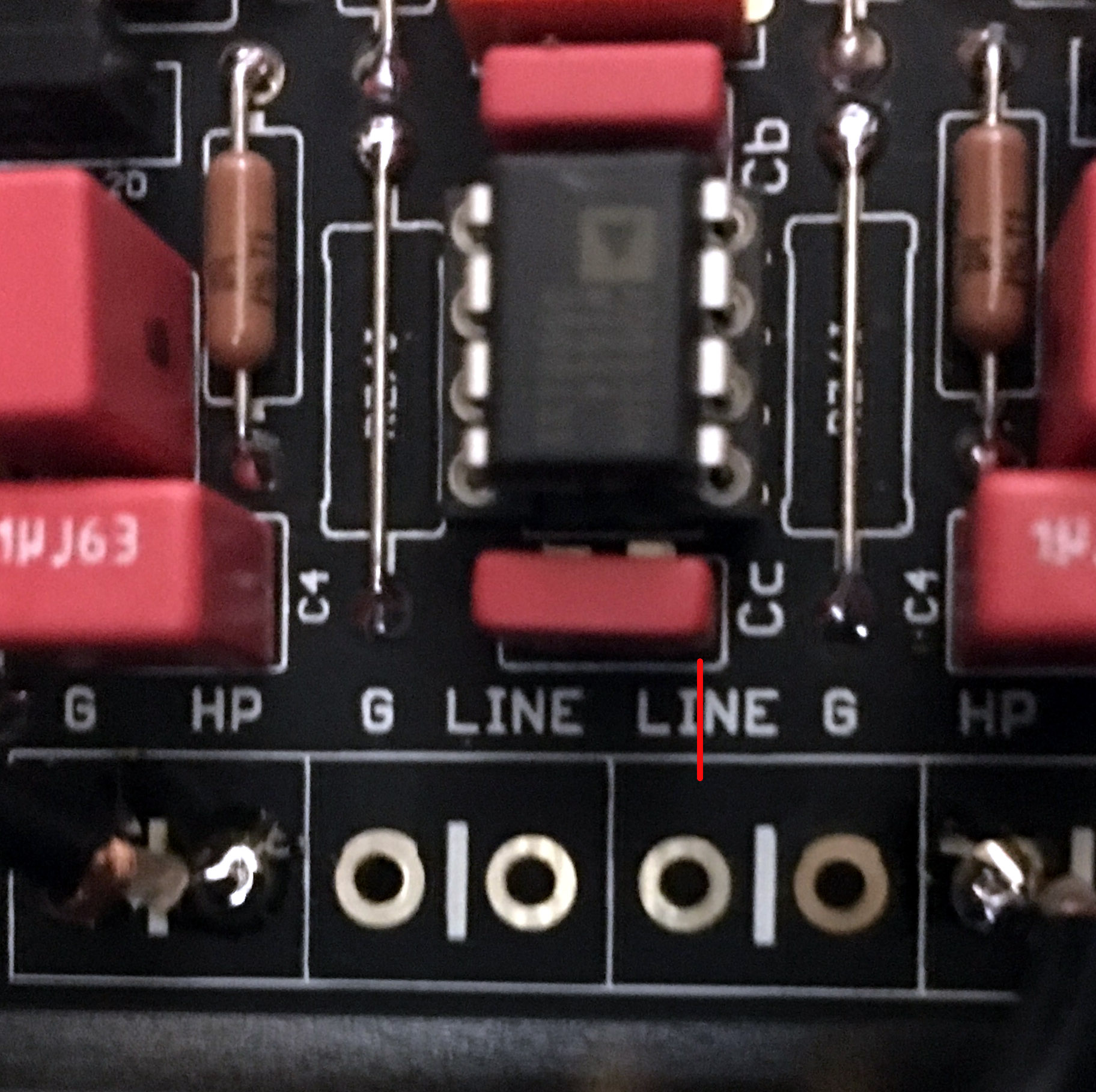

Hi Salas,
You mention that the new boards have split grounds. Why was this done? Also, you had suggested in the past that the ground could be cut. Could you point out where?

For flexibility in grounding schemes. A gap can be bridged when a lane can only be cut so better have a gap I thought. Thus I added that feature. Don't cut a classic board except there's a ground loop in a certain system and you need to try alternatives. Which is not that likely since buzz free classic board builds playing in various systems are so many here.

Thanks. Nash
