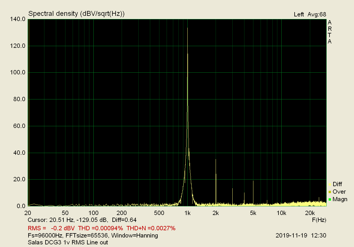

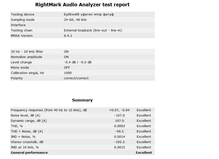

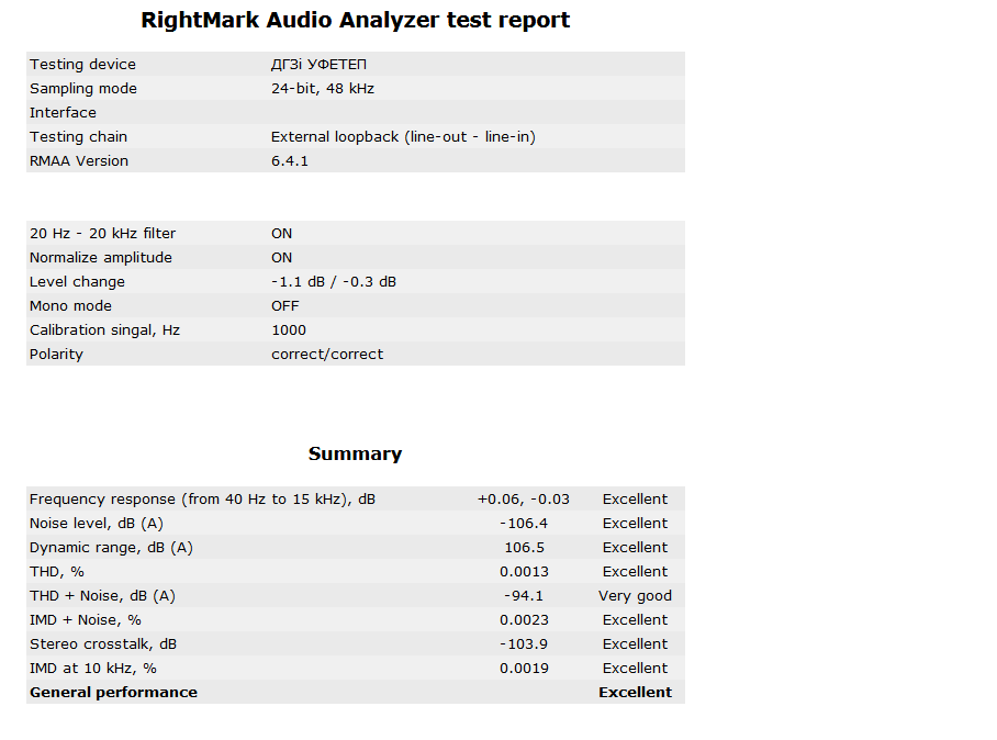

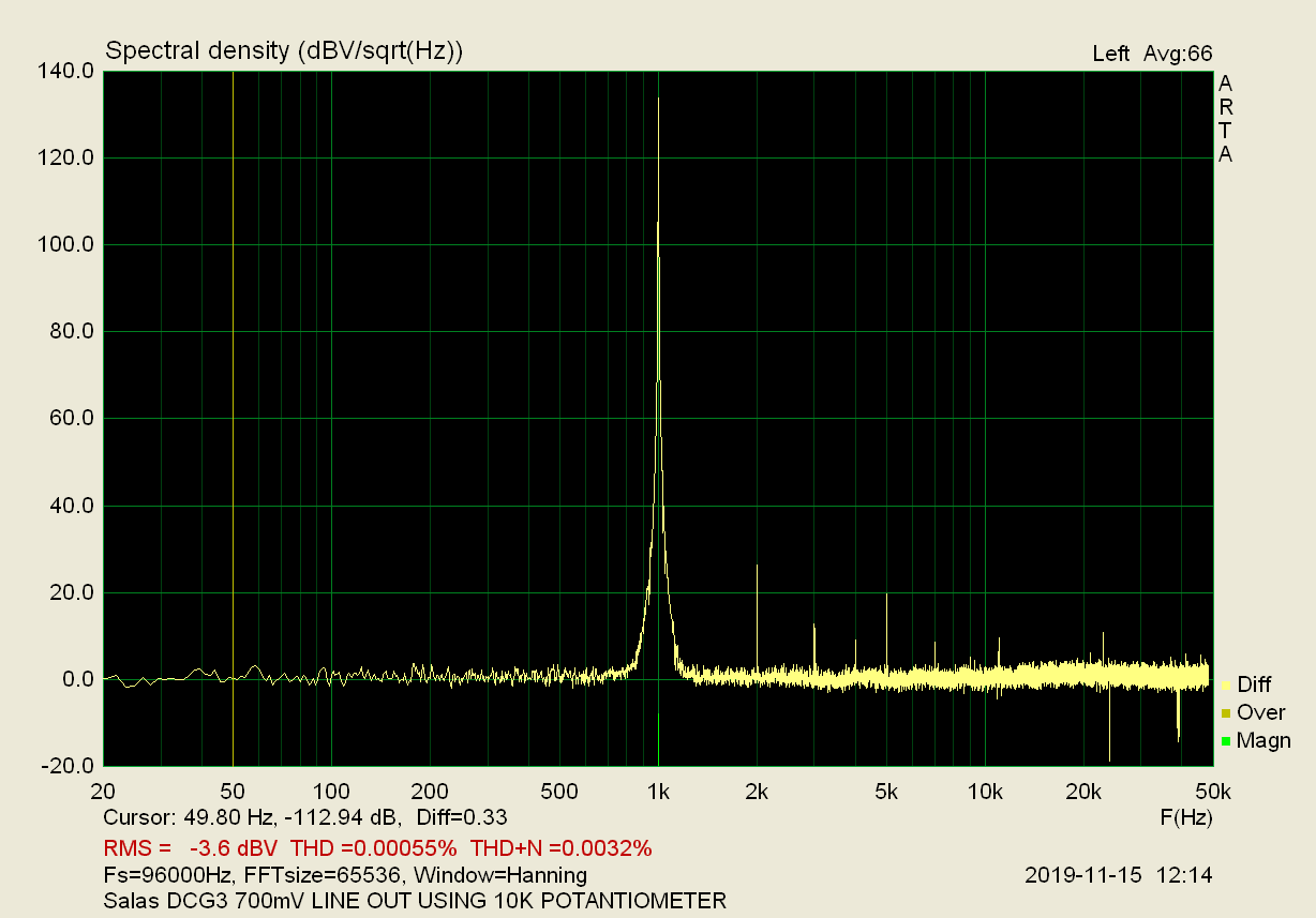

I want to share the results that i have using RMAA
Power Supply = +/-17.6v
Two L adapters and two transformers was used for power Supply.
Idle current = 100mA
Offset controller ,nothing special just a NE5532.
Tested at 1.6v RMS Line out.
Sound Card is an EsiJulia PCI.
First picture is the Sound Card loop test.
Second picture is the DCG3 test.

Stunning results. Congratulations!!! I also surprised that your PCI card has such low internal noise level. Excellent choice.
My new Focusrite v3 is not arrived yet, but I hope It will give me some improvement over v2.

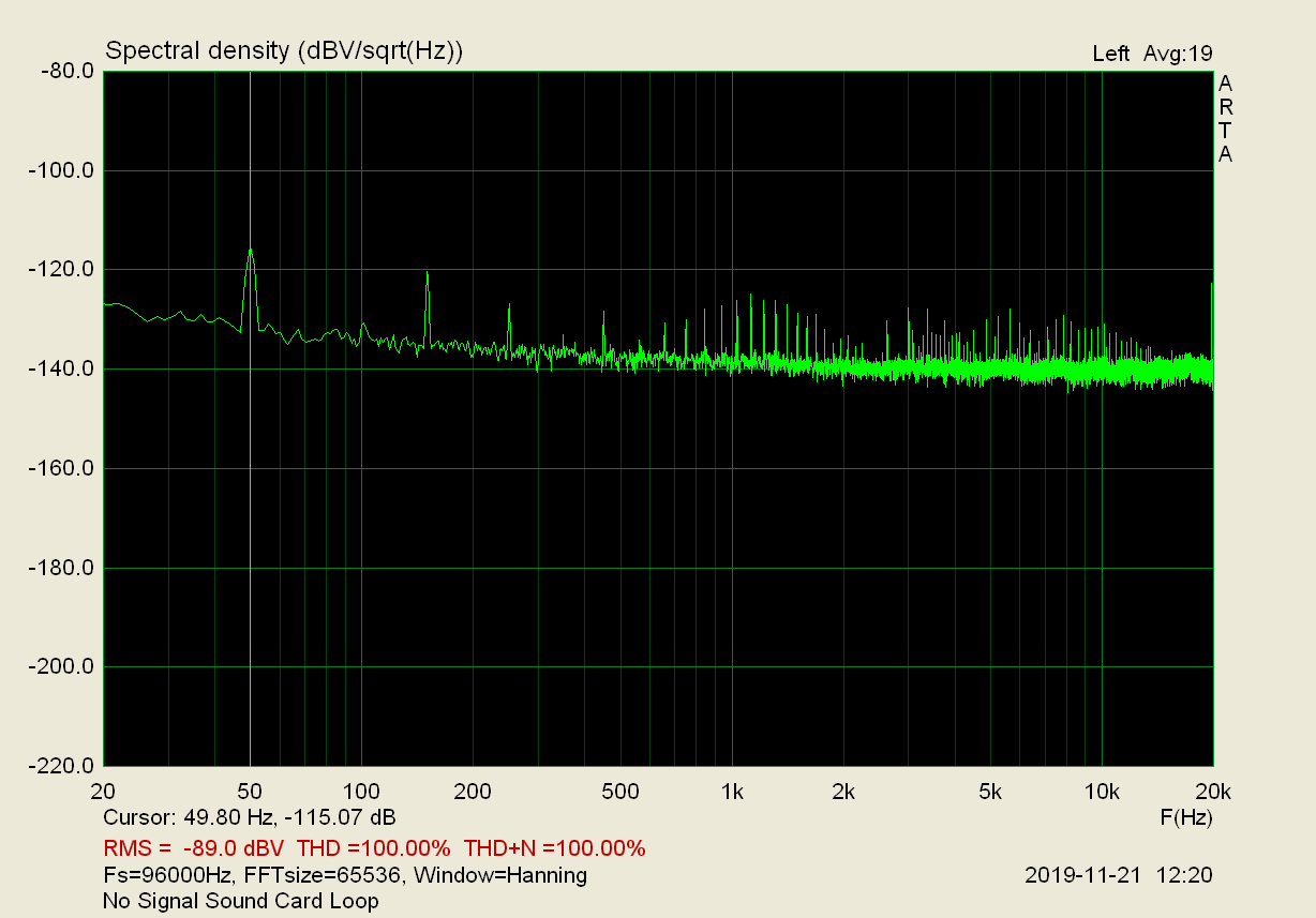

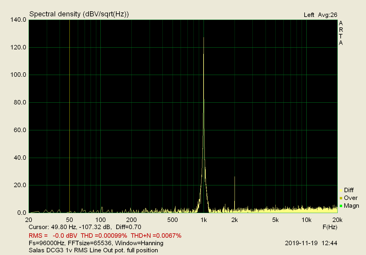

Trying to find a way for simply better looking fft i tryed this solution.
Trying to measure a circuit we really measure everything,gnd loops,voltage spikes,cables noise sockets bad contact,main hum e.t.c,e.t.c
Yes but we strongly interesting for the circuit .:scratch1:

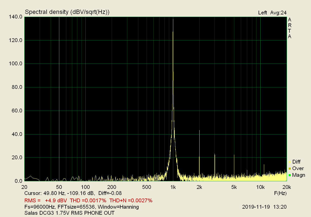

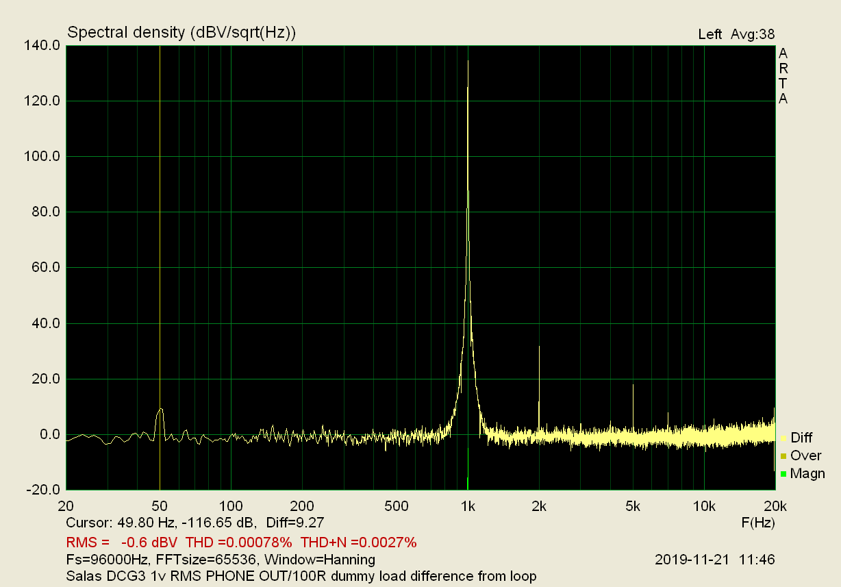

Lets see at the first picture.
In ARTA we choose GEN=EXTERNAL. PLAY.STOP.OVERLAY,SET AS OVERLAY.
Here is the line out under test when no input signal is present.

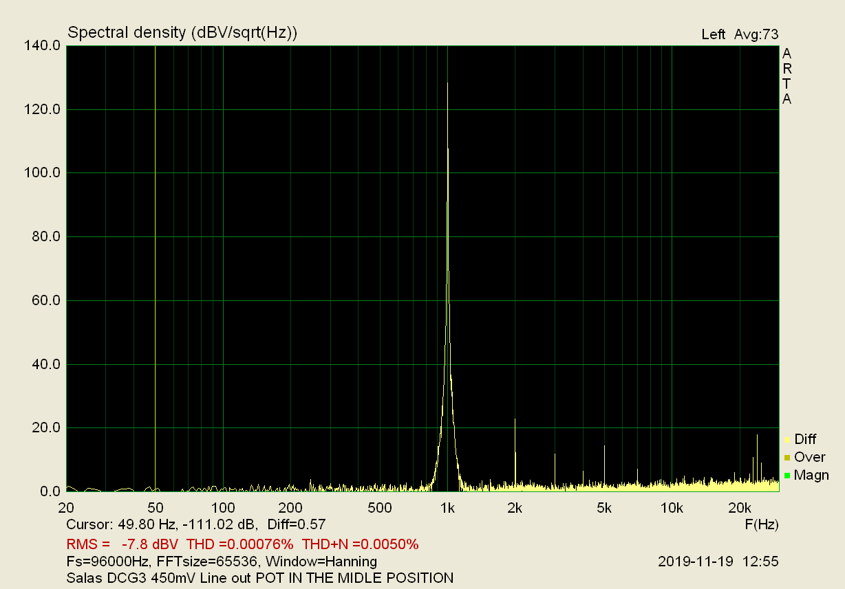

Lets see at the second picture.
In ARTA we choose GEN=SINE,OVERLAY,SHOW DIFFERENCE FROM OVERLAY,
That's it.
Please feel free saying your opinion.🙂

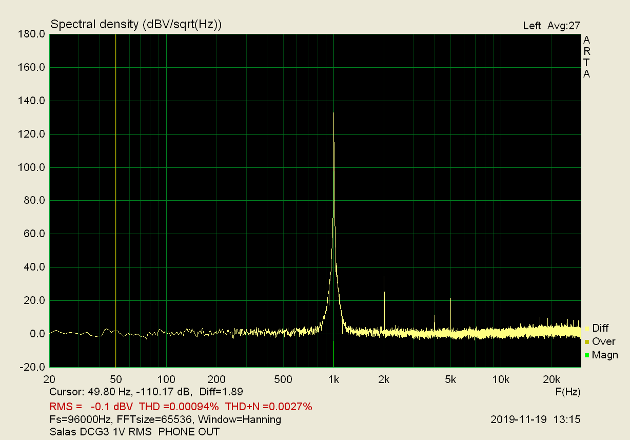

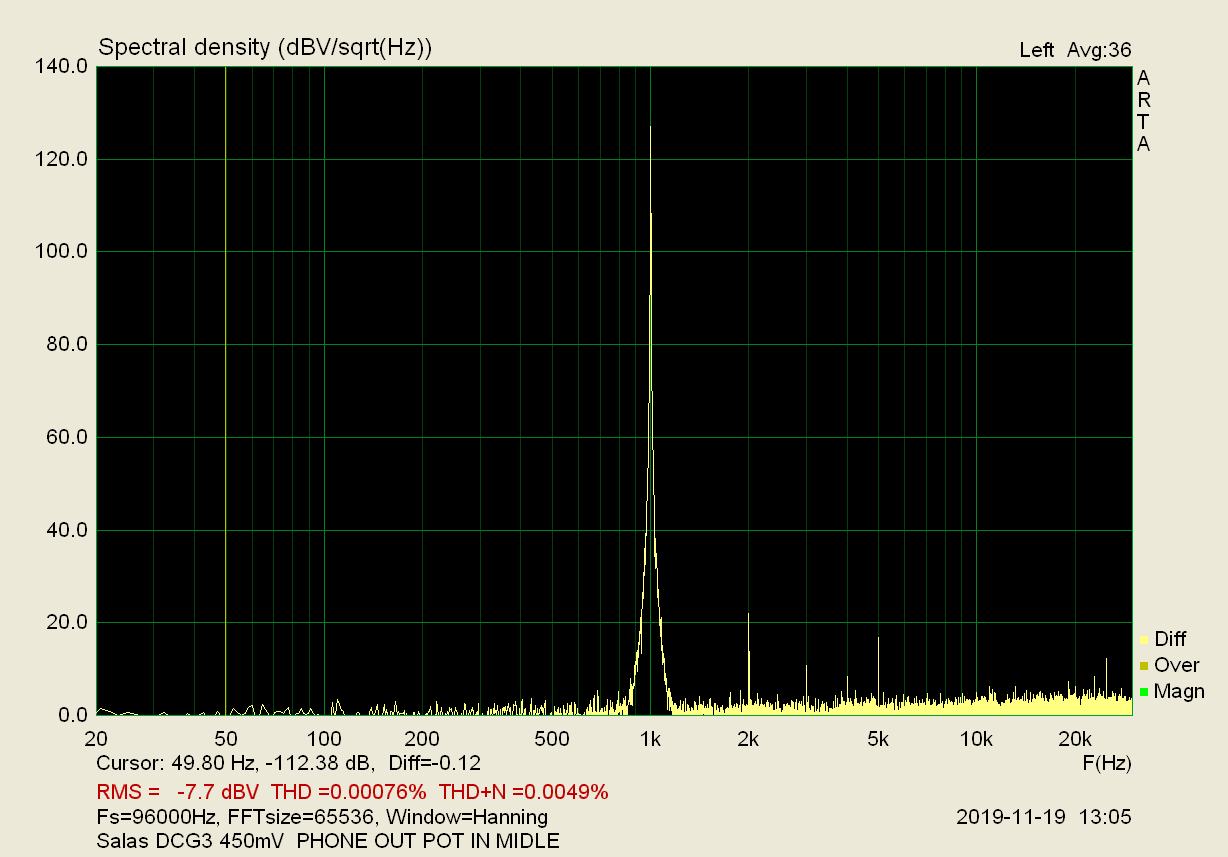

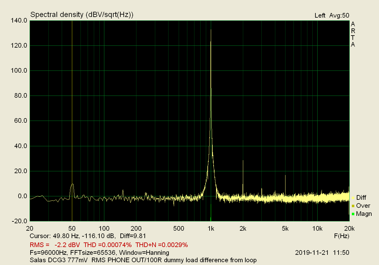

DCG3 TEST

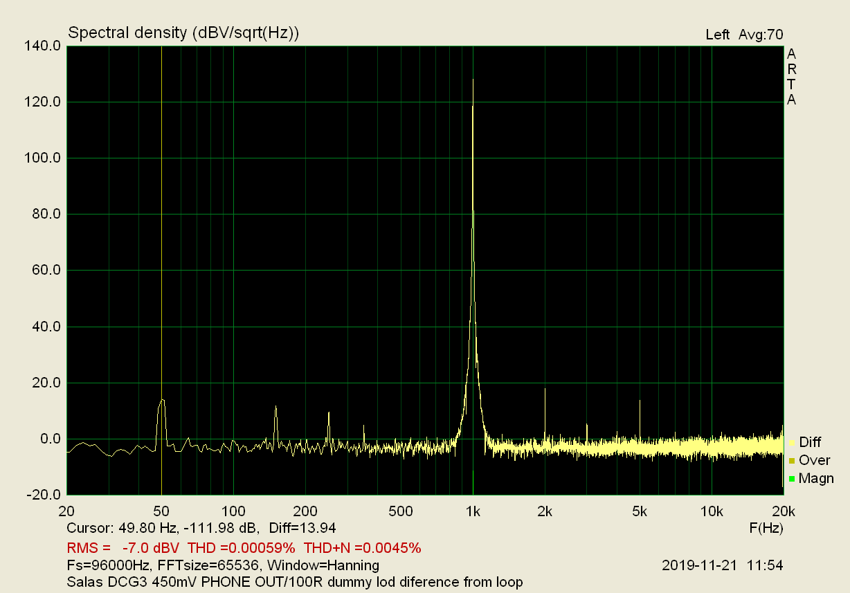

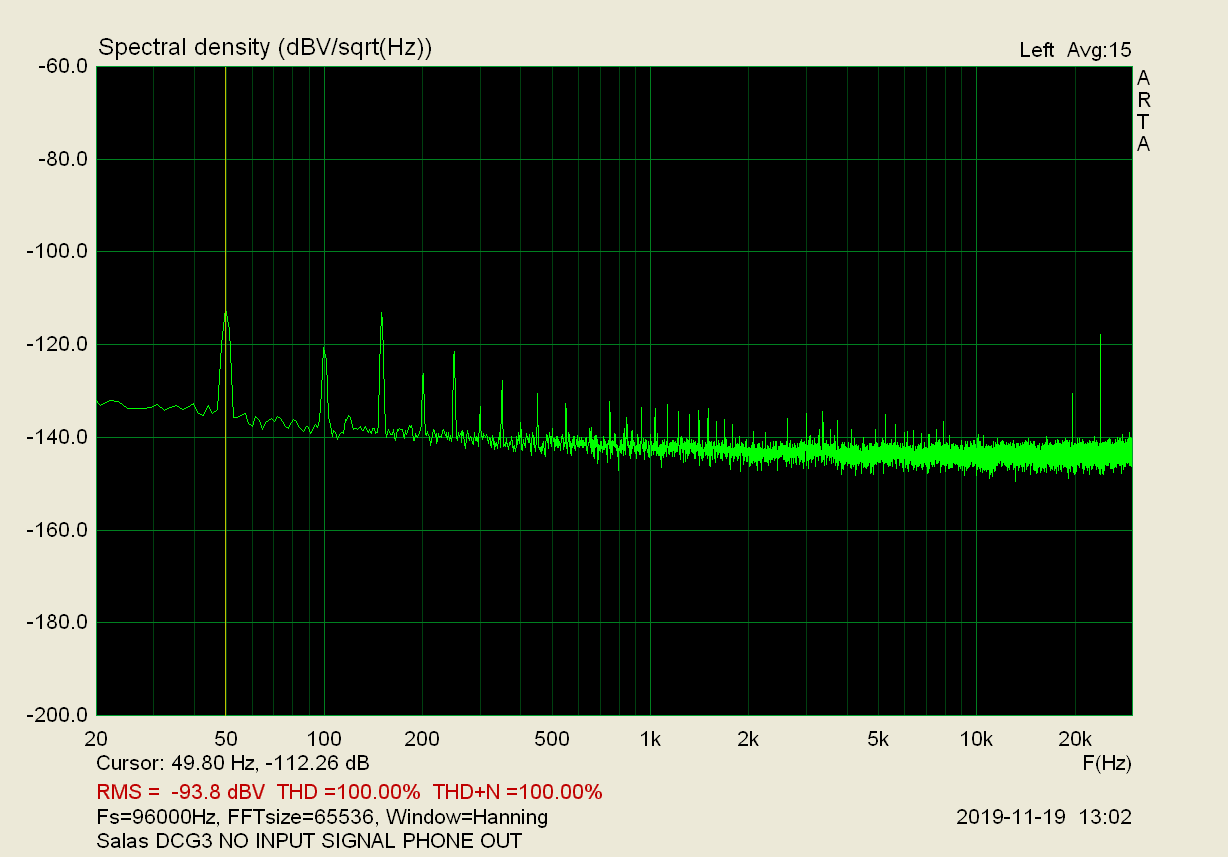

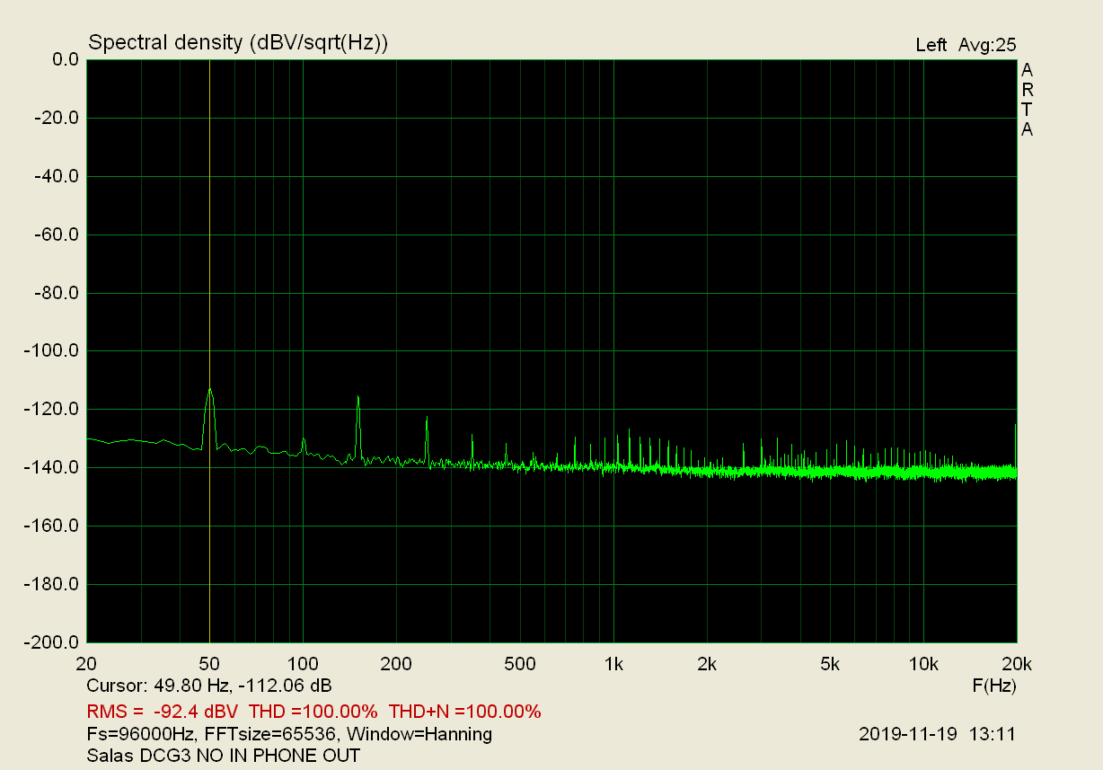

Phone Out.
R load=100R dummy load.
Picture 1,no input signal, pot in the position for 1v OUT.
Picture 2,no input signal, pot in the middle position.

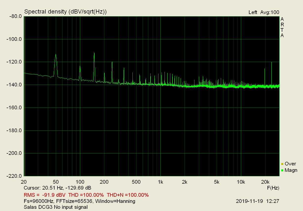

Is it possible to keep the audio card's own loop without test tone as overlay and then show difference from a DUT's loop with test tone?
I think that i have the sound card loop no signal , With the same cables.
If not i will do this again.
Yes i will try your test tomorrow.
In any case, the picture without signal is more or less the same in every circuit that i tested.
Your overlay method works well to remove stored residual grunge I see.
It could be better demonstrated if you also have the first picture's clean up result to put side by side. Apples for apples.
Test tone distortion harmonics from a DUT may coincide with stored noise spikes higher up in the range though and THD profile proportions are going to be altered?

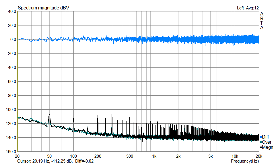

I'll explain with a picture. Shows the procedure and the cancellation for same loop's noise floor. So to be absolutely comparable. This is not looping a DCG3 by the way. Some hi-fi amp I had around.
Yes it cleans the spikes. A drawback I see is it also removes any 1/F rise information when there.
Another draw back I imagine is when there is a spray of spikes beyond the test tone (usually 1kHz) they will difference out real THD harmonics if we introduce a device under test and try to remove the audio interface's residual noise overlay.
It's an integrated amp added in the loop so to demonstrate the process better. Because my EMU external audio interface doesn't display enough harmonic noise of its own to help highlight a differential cancellation.
The loop with DUT saved as green overlay on gen external. The black is same with sine. The cyan is the difference. Same number of averaging in all takes. Volume zero.
