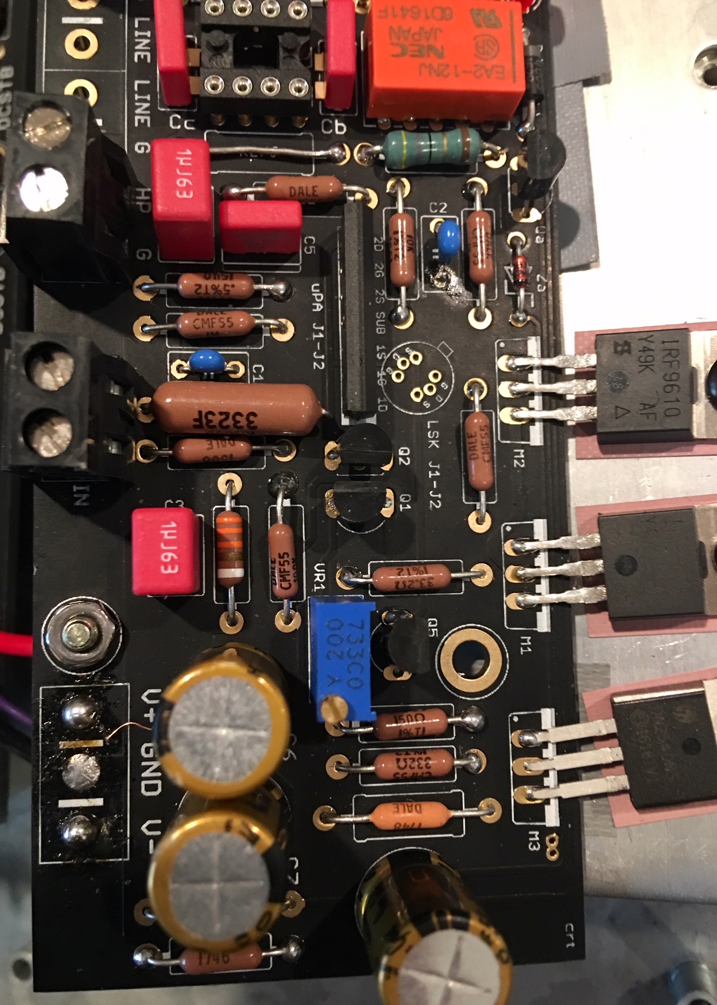

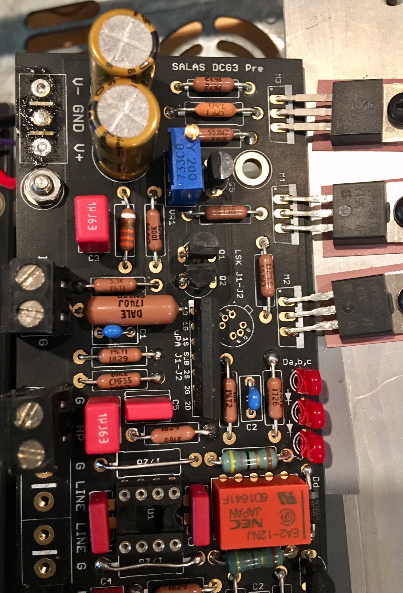

Hi folks,
I am attempting to build this preamp. It is my first project more complicated than a power supply. I have successfully built the DCSTBs - 17.49 & 17.44 volts. One channel of the DCG3 seems ok, although lower than I'd expect (103 mv with 7.7 ohm R10). The other channel doesn't work. I've re-flowed the solder, to no avail. I'm not sure how to proceed with trouble shooting. Any advice would be appreciated! Thank you.

Hi
First of all see about the small semis making sure that you didn't put some transistor in a JFET's place or vice versa. Then check that your MOSFETS are the right types in the right designations and that the C6 C7 capacitors are correctly oriented also. Post a picture of your DCG3 populated PCB if you can so we can inspect for something maybe obviously wrong.
Here are photos.

diyAudio Chief Moderator
Joined 2002
There isn't a part that seems obviously put in a wrong place or reversed. Is there a chance your R8s are 3.33k instead of 33k? There's also a stray copper strand at the second pic's C6 rim near the power input, better clear that away.
Verify as many resistors values as you can. Also active parts characteristic operation DC voltages, Vgs in FETS & Vbe in transistors, make a pass list. Passable are about 2 or more volts in M3 about 4 volts in M1 M2 about 0.6V in BJTS and 0.75V to 1.1V for J3 (Q5) across R3. Also inspect the other side of the PCB for accidental things like a joint not done or a solder bridge created or too much flux residue especially around the MOSFET gates.
